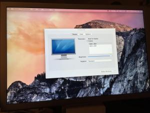

thePHPdev Posted December 15, 2014 Share Posted December 15, 2014 Hi, I have a 30" Apple Cinema Display, a DL-DVI to HDMI adaptor and a 2013 MacBook Pro. That's all well and good, but the resolution of the Cinema Display is topping out at 1280x800. If anybody could give me some ideas - as I'm stumped - that would be great, and your help would be most appreciated. Thanks in advance. Link to comment Share on other sites More sharing options...

thePHPdev Posted December 15, 2014 Author Share Posted December 15, 2014 Erm... "2013 MacBook Pro" - OP. '30" Cinema Display'. So, no - since the 30" model only came with Dual-Link DVI. Link to comment Share on other sites More sharing options...

thePHPdev Posted December 15, 2014 Author Share Posted December 15, 2014 The power block, DVI cable and everything else associated with the 30" Cinema display is original Apple that came with the display. I saw it working just recently with the prev owner's PC. The DVI to HDMI adaptor is Dual-Link, as already stated in the OP... Link to comment Share on other sites More sharing options...
