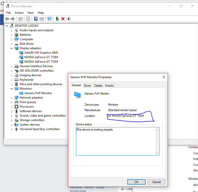

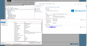

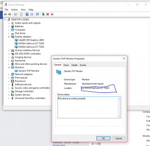

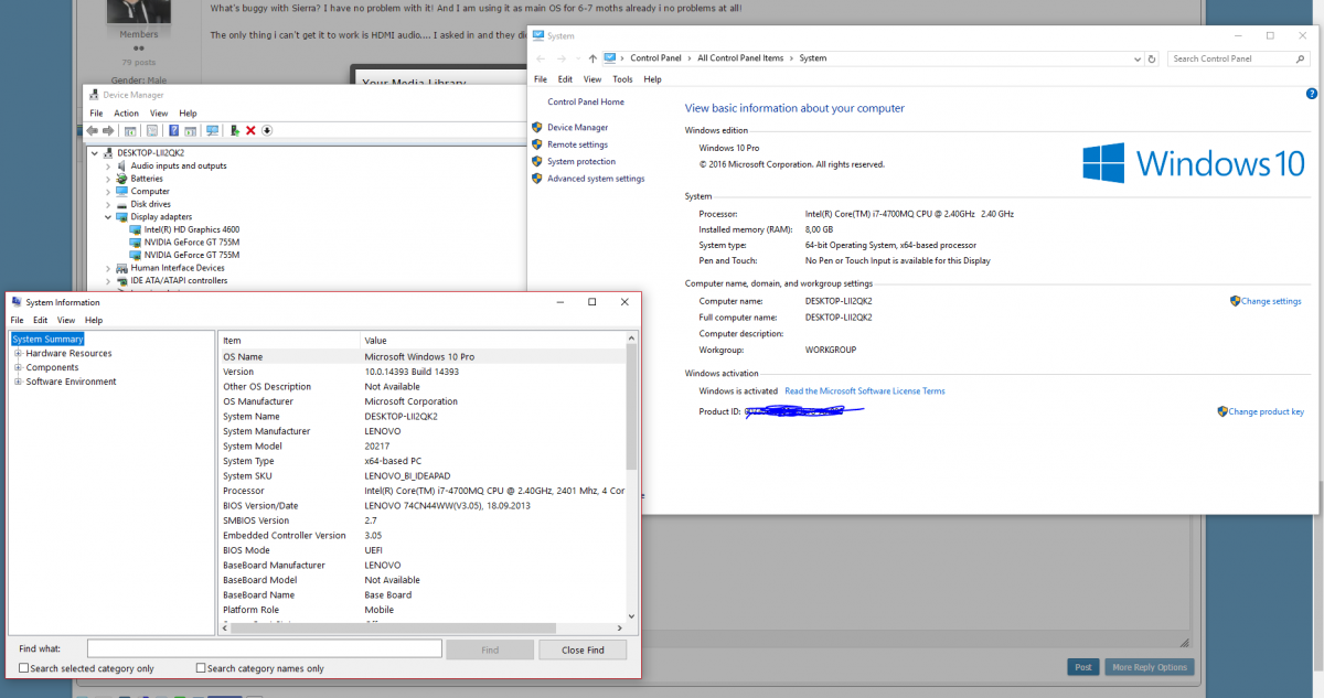

Hi Guys! I've just managed to BOOT Windows 10 with enabled both Intel and NVIDIA SLI. It would be very useful for booting OS X on notebook with pluuged in Ultrabay card.
That's very interesting .. would you share more info on how you did that?
It's quite easy. You just need modded BIOS. Then with Ultrabay card plugged in open BIOS setup and set Internal Graphics Device to Enabled. However in this configuration SLI doesn't work, but maybe we can do simple switch for that.
Hmm ... I'm on stock BIOS ATM. So were you able to boot into OS X this way?
There is one problem. Monitor is still attached to NVIDIA Card. I tried switching it in BIOS also, but I failed to boot, because I got blackscreen and I wasn't able to see BIOS later.
