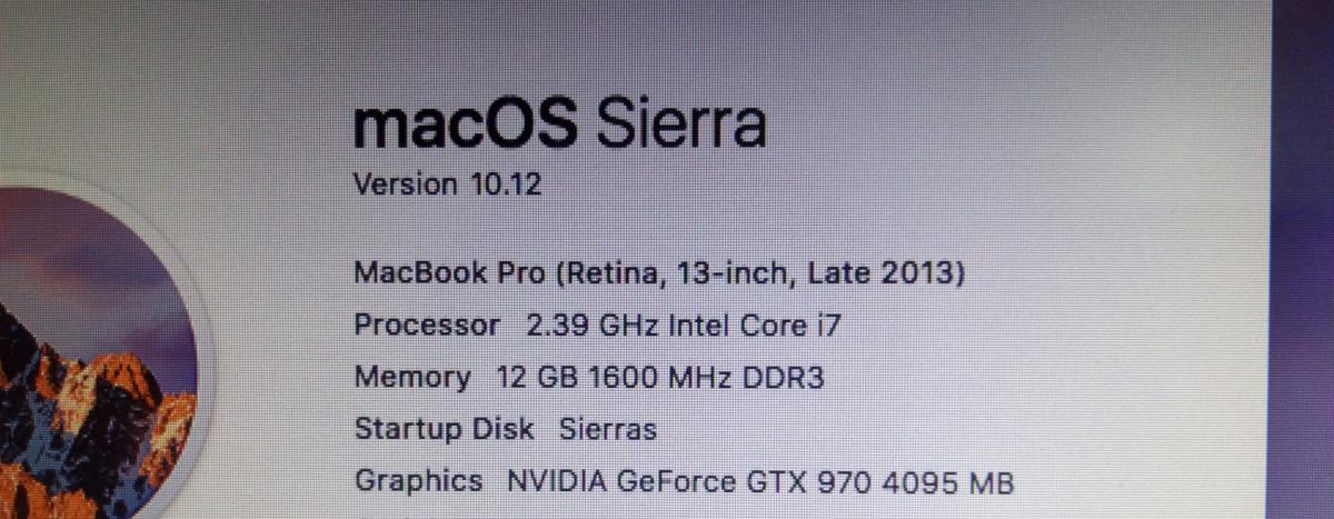

I have the same laptop like you. The single difference is gtx 970. The gtx 970 it is linked via mini pci(Wi-Fi slot).
Of course I copied folder CLOVER from page 1. I posted the folder on post where is nvram.
Yes I know, I remember when you talked about that. I just can't test anything without the exact same setup in hand. What I can say now is that if Intel HD work fine when you disable the GTX 970 then Clover is doing its job correctly. Otherwise, disconnect GTX 970 completely and let's discuss the problem.
If I disconnect gtx 970 laptop restart instantly :). Restart instantly after I copy it CLOVER folder on EFI. I tried to start from USB, the same problem, restart. Tomorrow I install again and delete nvram like you said. Thanks for helping!

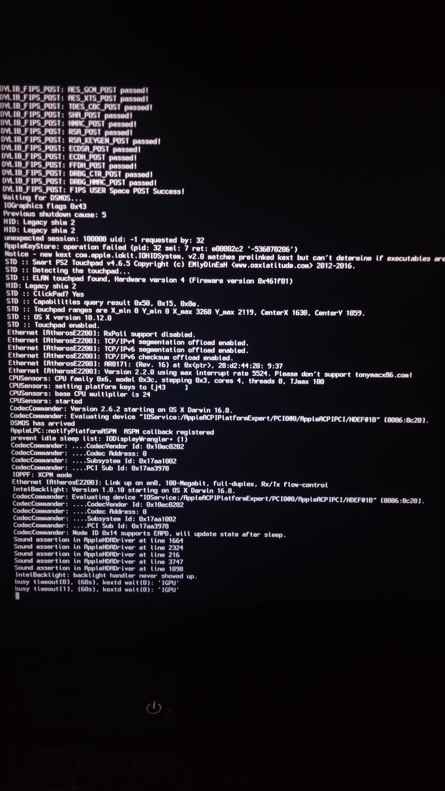

I reinstall on ssd without gtx 970 connected.
1 installed last clover
2 installed kext on S/L/E
3 replace CLOVER folder from EFI partition
4 add serial bios from clover configurator with plist.editor
5 delete from config.plist vdps2, I have smart touch pad
Stuck there, see photo.
Clover folder from efi part.
Sorry, can't find the problem  :no:
The solution is obvious from the pic you uploaded.
@ahmed_ais,
Take a look at your config.plist. It has no "Graphics" section.
Also, use a proper SMBIOS. Easy way is to use "Clover Configurator". But beware it'll mess up your config.plist file. Better way is to use a dummy config to create SMBIOS using cc and copy the data over to your main config.plist.
