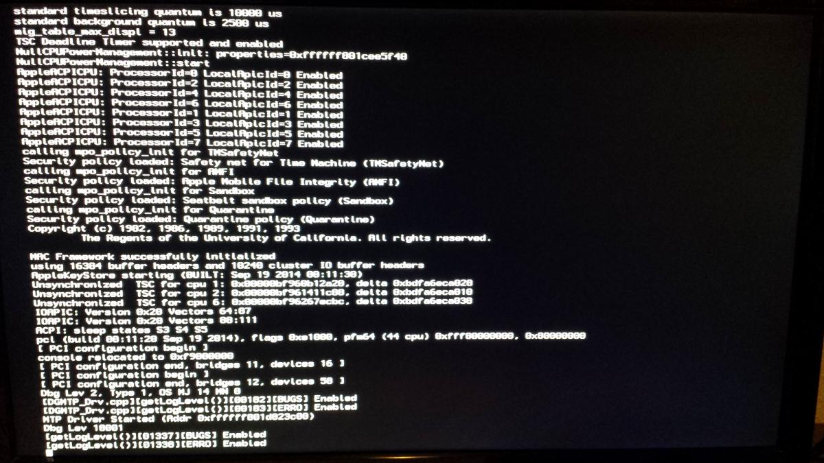

NapalmCandy Posted December 8, 2014 Share Posted December 8, 2014 Yesterday I updated to yosemite from Mountain Lion, the first boot was fine, but not the second, I tried a lot of this but nothing works until I reinstalled yosemite. Then the first boot was fine, and second boot, but now don't boot again and it stuck on same message (see photo) After a long time waiting (+10min) it appears two new lines, but after 1hour it don't change anything. (see photo) What can I do? What it is generating these problems? I feel I had two problems Link to comment Share on other sites More sharing options...

NapalmCandy Posted December 8, 2014 Author Share Posted December 8, 2014 Hi again. I can't boot to desktop so I can't put or remove any kext. If I try flags -x or -f it say can't find mach_kernel So I tried to boot with USB installation and fix permissions. Now stuck 8 lines later. Also I disconnected a SD-Card reader/USB that I think it is was generating the other message, now it don't appear. Link to comment Share on other sites More sharing options...

HUSABER Posted December 8, 2014 Share Posted December 8, 2014 try this flag on boot screen -v tscsync npci=2000 Link to comment Share on other sites More sharing options...
NapalmCandy Posted December 9, 2014 Author Share Posted December 9, 2014 I solve it. I reinstall yosemite and then I removed from org.chameleon.boot.plist the lines <key>kernel</key> <string>mach_kernel</string> also I add the lines <key>UseKernel</key> <string>No</string> Link to comment Share on other sites More sharing options...
