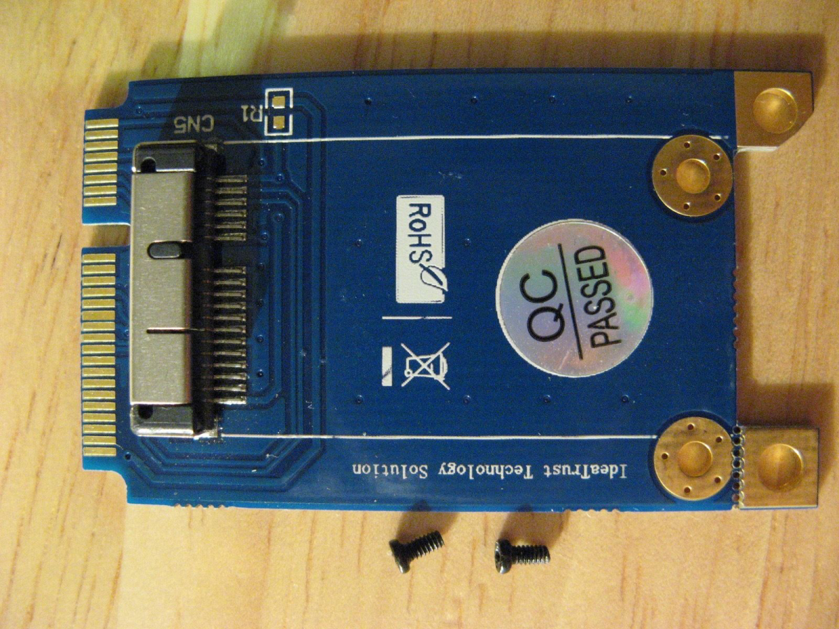

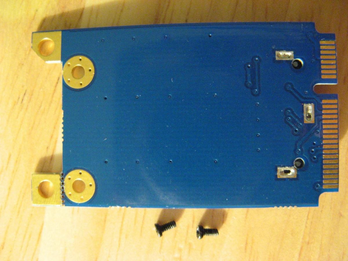

I got this adapter but bluetooth part doesn't work. As far as I understand USB connection is missing on my PCI-E line. I'm handy with soldering but not sure where to solder what.

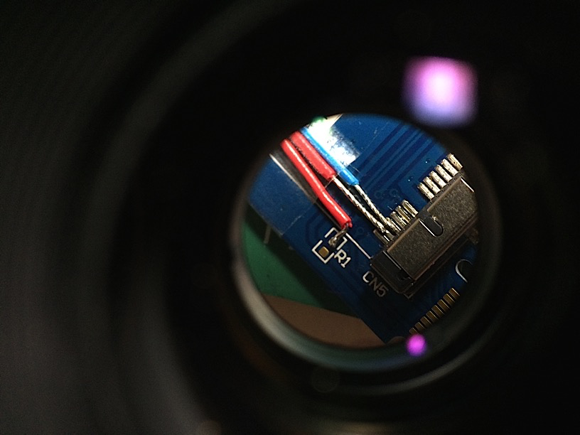

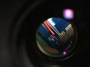

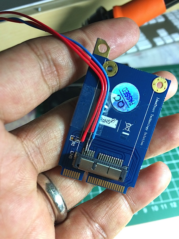

From the left;
the 1st pin is the 3.3v (bluetooth) power
the 2nd pin is the USB D+
the 3rd pin is the USB D-
credit to mhafeez
