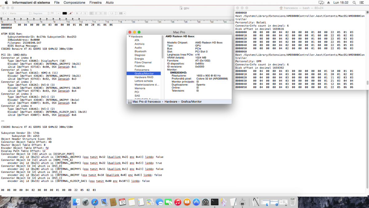

francescophp Posted November 10, 2014 Author Share Posted November 10, 2014 My gpu bios (Use 2 different bios decoder) ATOM BIOS Rom: SubsystemVendorID: 0x174b SubsystemID: 0xe253 IOBaseAddress: 0x0000 Filename: 253X03H0.S47 BIOS Bootup Message: C58203 Bonaire XT A1 GDDR5 1GB 64Mx32 300e/150m PCI ID: 1002:665c Connector at index 0 Type [@offset 43606]: DisplayPort (10) Encoder [@offset 43610]: INTERNAL_UNIPHY2 (0x21) i2cid [@offset 43716]: 0x90, OSX senseid: 0x1 Connector at index 1 Type [@offset 43616]: HDMI-A (11) Encoder [@offset 43620]: INTERNAL_UNIPHY2 (0x21) i2cid [@offset 43743]: 0x92, OSX senseid: 0x3 Connector at index 2 Type [@offset 43626]: DVI-D (3) Encoder [@offset 43630]: INTERNAL_UNIPHY1 (0x20) i2cid [@offset 43770]: 0x93, OSX senseid: 0x4 Connector at index 3 Type [@offset 43636]: DVI-I (2) Encoder [@offset 43640]: INTERNAL_UNIPHY (0x1e) i2cid [@offset 43807]: 0x95, OSX senseid: 0x6 Connector at index 4 Type [@offset 43646]: DVI-I (2) Encoder [@offset 43650]: INTERNAL_KLDSCP_DAC1 (0x15) i2cid [@offset 43807]: 0x95, OSX senseid: 0x6 —— C58203 Bonaire XT A1 GDDR5 1GB 64Mx32 300e/150m Subsystem Vendor ID: 174b Subsystem ID: e253 Object Header Structure Size: 355 Connector Object Table Offset: 48 Router Object Table Offset: 0 Encoder Object Table Offset: fd Display Path Table Offset: 12 Connector Object Id [19] which is [DISPLAY_PORT] encoder obj id [0x21] which is [INTERNAL_UNIPHY2 (osx txmit 0x12 [duallink 0x2] enc 0x4)] linkb: false Connector Object Id [12] which is [HDMI_TYPE_A] encoder obj id [0x21] which is [INTERNAL_UNIPHY2 (osx txmit 0x22 [duallink 0x2] enc 0x5)] linkb: true Connector Object Id [4] which is [DVI_D] encoder obj id [0x20] which is [INTERNAL_UNIPHY1 (osx txmit 0x11 [duallink 0x1] enc 0x2)] linkb: false Connector Object Id [2] which is [DVI_I] encoder obj id [0x1e] which is [INTERNAL_UNIPHY (osx txmit 0x10 [duallink 0x0] enc 0x0)] linkb: false Connector Object Id [2] which is [DVI_I] encoder obj id [0x15] which is [INTERNAL_KLDSCP_DAC1 (osx txmit 0x00 enc 0x10?)] linkb: false It boots only in safe mode Link to comment Share on other sites More sharing options...
francescophp Posted November 11, 2014 Author Share Posted November 11, 2014 My question is.. If i buy display port to hdmi converter.. For yosemite is the same as use a displayport to displayport? Ps: i tried use dsdt using rampagedev guide but when i boot i see black screen.. Link to comment Share on other sites More sharing options...
