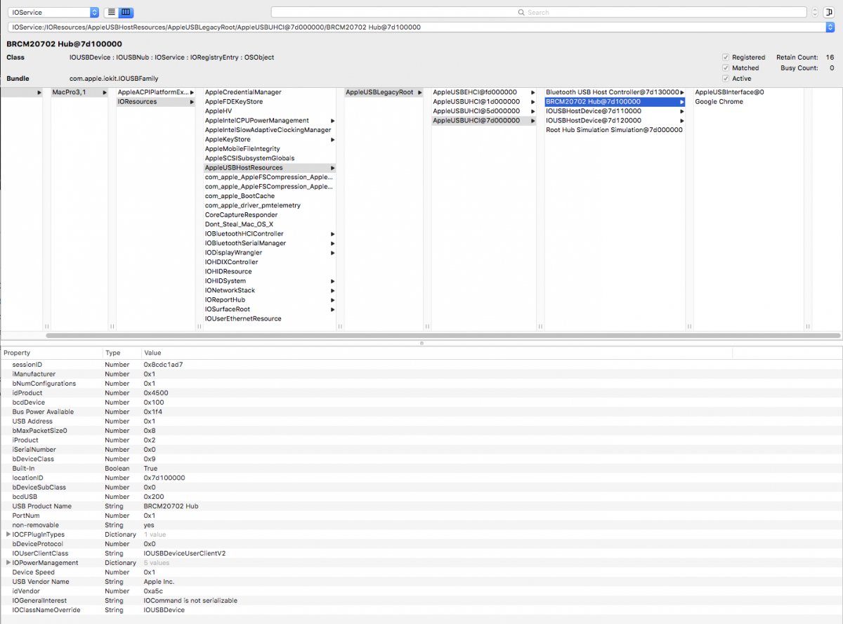

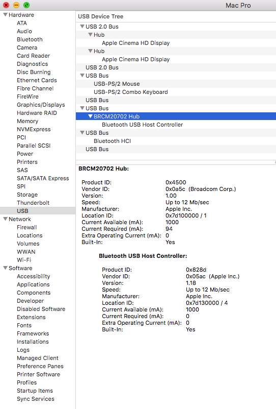

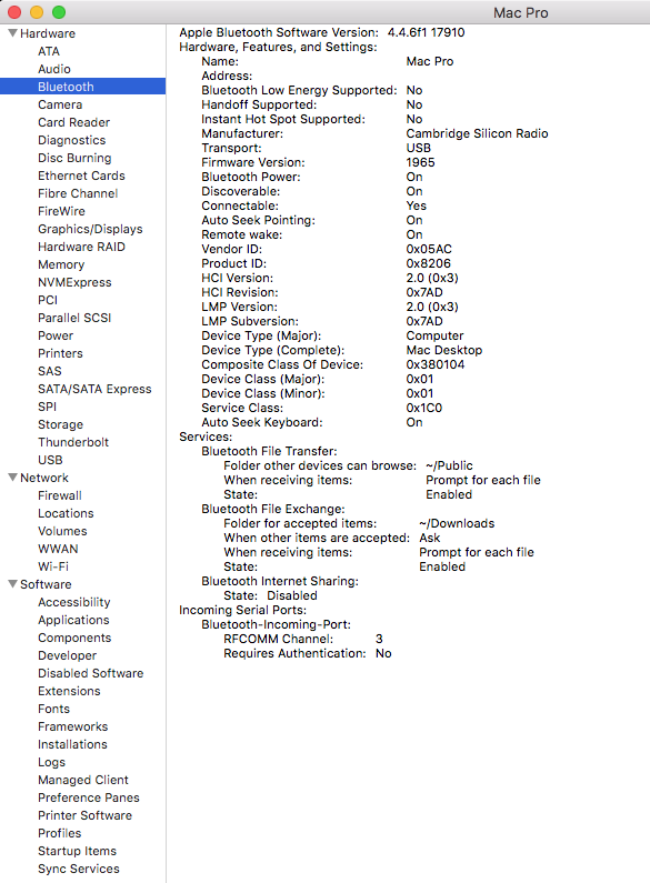

im using BCM94360CD on a macpro 3.1. with the upgrade to El Capitan from Mountain Lion, i lost my Bluetooth.
i can see the BRCM20702 Hub in Sys info, but the Bluetooth report says its using Cambridge Silicon.
ive installed the BRCMPatchRAM2 but doesnt seem to do anything.
i attach my sys reports. can you help?
SOLVED!
after all the searching, it turns out my USB were correclty working but OSX was defaulting the USB host controller to a secondary one.
i could see the Cambridge S Radio controller in the BT area but my Broadcom one was being ignored.
i tried to switch adapters using Bluetooth Explorer App, but it wouldnt let me switch.
i finally used terminal to force the switch:
sudo nvram bluetoothHostControllerSwitchBehavior=always
rebooted and Voila! all working again.;-)
