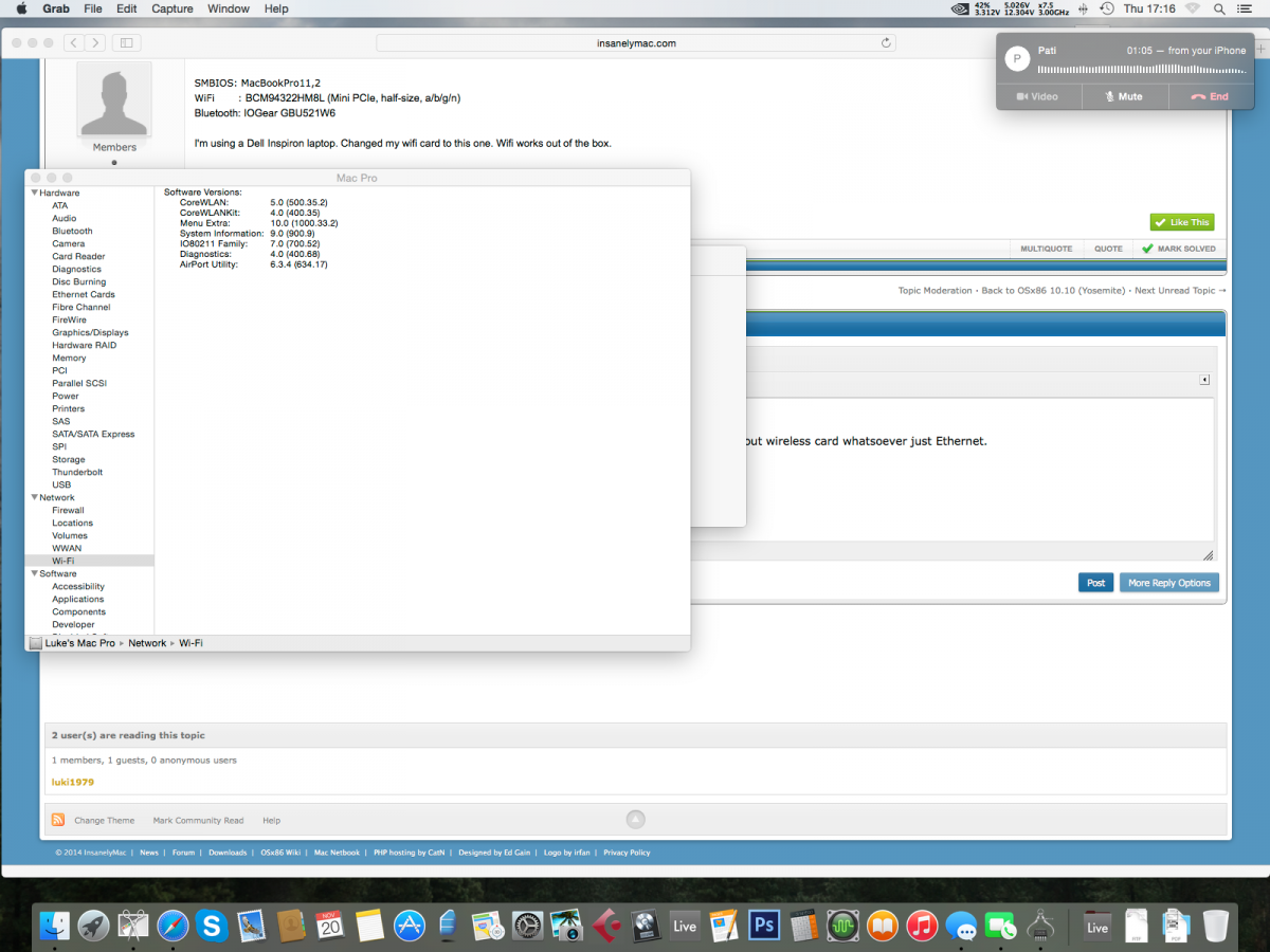

Here are my configurations:
SMBIOS: MacBookPro11,2
WiFi       : BCM94322HM8L (Mini PCIe, half-size, a/b/g/n)
Bluetooth: IOGear GBU521W6
I'm using a Dell Inspiron laptop. Changed my wifi card to this one. Wifi works out of the box.
Instant Hotspot also works but the very first connection is a bit difficult to establish.
Thanks for the specs. I updated main post.
While I'm waiting for BCM94331CD to arrive from China .....
I got working Firewire PCI card and connected my Isight camera. I can call mobile phones and receive calls from FaceTime without wireless card whatsoever just Ethernet as I sold my Atheros card.
I know but this is part of Continuity, obviously we discussing Handoff in this thread but I personally thought that you need to meet the same requirements for calling as for Handoff. Silly me.
IPhone needs to be on Wi-Fi and nearby as stands in FaceTime preferences but Mac can use Ethernet. Anyway I like that feature.
