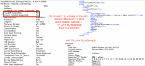

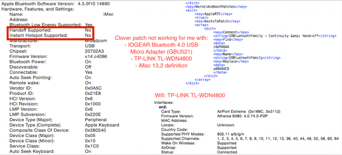

I use iMac13,2 definitions and an USB Iogear gbu521. Patch didn't work for me.
Thanks for pointing that out.

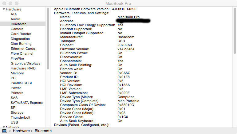

I have an IOgear dongle pluged in USB3, and after applied the patch does not work for now, this is my hardware:
Hardware Overview:
  Model Name: iMac
  Model Identifier: iMac13,2
  Processor Name: Intel Core i7
  Processor Speed: 3.50 GHz
  Number of Processors: 1
  Total Number of Cores: 4
  L2 Cache (per Core): 256 KB
  L3 Cache: 8 MB
  Memory: 16 GB
 Apple Bluetooth Software Version: 4.3.0f10 14890
  Hardware, Features, and Settings:
  Address: 00-02-72-DA-23-63
  Bluetooth Low Energy Supported: Yes
  Handoff Supported: No
  Instant Hotspot Supported: No
  Manufacturer: Broadcom
  Transport: USB
  Chipset: 20702A3
  Firmware Version: v14 c4096
  Bluetooth Power: On
  Discoverable: Off
  Connectable: Yes
  Auto Seek Pointing: On
  Remote wake: On
  Vendor ID: 0x0A5C
  Product ID: 0x21E8
  HCI Version: 0x6
  HCI Revision: 0x1000
  LMP Version: 0x6
  LMP Subversion: 0x220E
  Device Type (Major): Computer
  Device Type (Complete): Mac Desktop
  Composite Class Of Device: 0x380104
  Device Class (Major): 0x01
  Device Class (Minor): 0x01
  Service Class: 0x1C0
  Auto Seek Keyboard: On
  Software Versions:
  CoreWLAN: 5.0 (500.35.2)
  CoreWLANKit: 4.0 (400.35)
  Menu Extra: 10.0 (1000.33.2)
  System Information: 9.0 (900.9)
  IO80211 Family: 7.0 (700.52)
  Diagnostics: 4.0 (400.68)
  AirPort Utility: 6.3.4 (634.17)
  Interfaces:
en2:
  Card Type: AirPort Extreme  (0x14E4, 0x88)
  Firmware Version: Broadcom BCM43xx 1.0 (5.10.131.36.16)
  MAC Address: 00:1f:5b:b4:21:e4
  Locale: FCC
  Country Code: US
  Supported PHY Modes: 802.11 a/b/g/n
  Supported Channels: 1, 2, 3, 4, 5, 6, 7, 8, 9, 10, 11, 36, 40, 44, 48, 52, 56, 60, 64, 149, 153, 157, 161, 165
  Wake On Wireless: Supported
  Status: Connected
What am I doing wrong? do I have bad hardware?
big tks
Guys, it won't work with TP-Link cards as wi-fi or any other Atheros card. I tested myself.
With Atheros it will either kill bluetooth or just not work.
Alex Mac I've seen your hardware working but macbook pro smbios. It's all very confusing.  This patch is for people who got the hardware already just to try.
So far nobody except laptop users with Broadcom Wi-Fi confirmed USB dongles working.

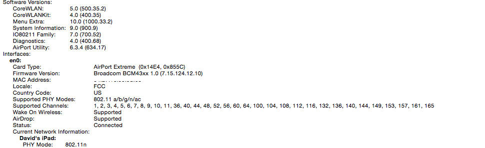

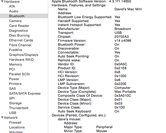

GMYLE working with the patch in combination with BCM94352. The BT on the combo card has been disabled as I got fed up with the unreliability. Dongle features working well including instant hotspot and airdrop between iOS (on a 4G enabled iPad Mini 2) and Mac and vice versa. Handoff in applications working well. I don't though have a recent iPhone to test the calling capabilities. Also the dongle is giving me much better BT connection than the BT part of the combo card ever did....
Note:
The wifi card has the cosmetic patch for Airport Extreme as well as the 5GHz fix.
