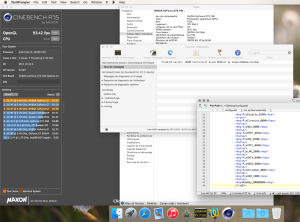

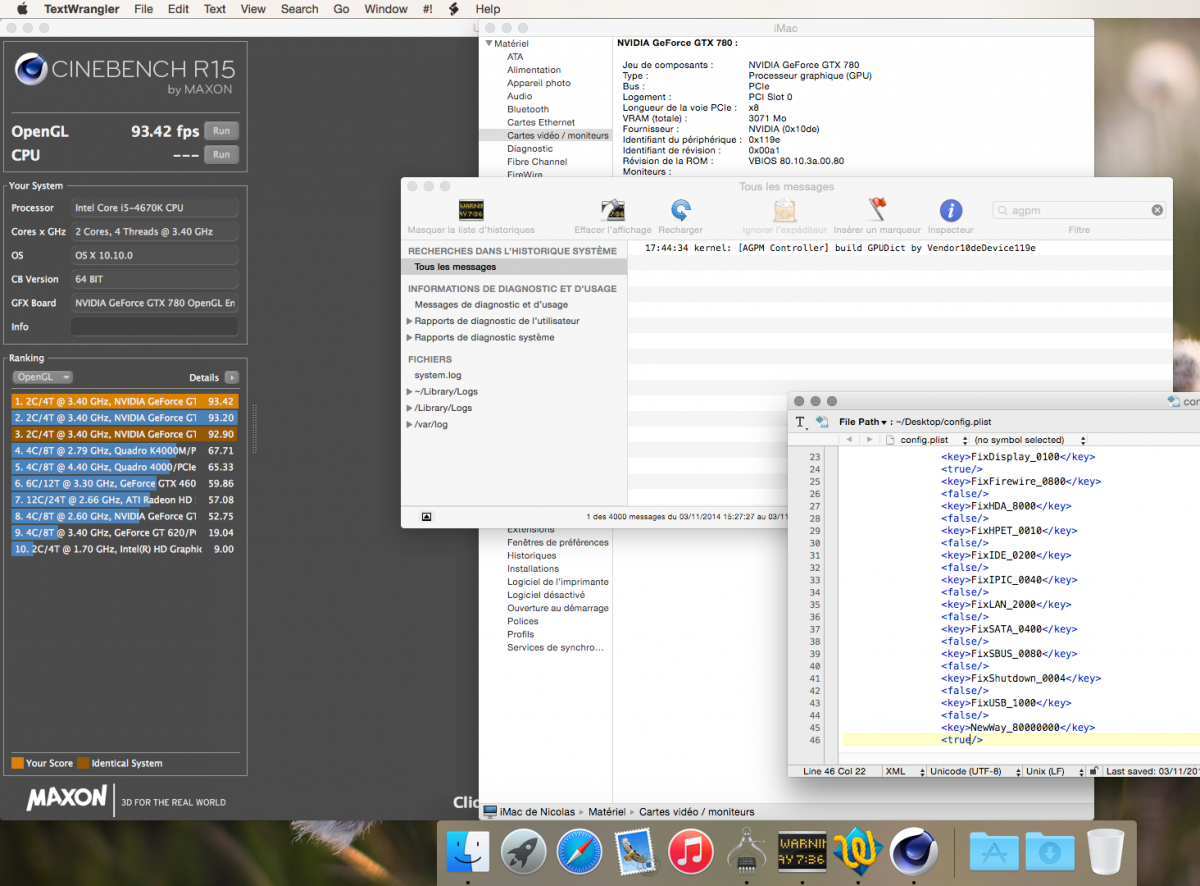

Here is what i have done for my GTX 780 ; update proof method :
Rig set as iMac14,2 with matching (SMBios) Mac-xxxxxxxxx number in AGPM ; in the related section of AGPM, i picked 10de 119e (GTX 780M) to inject via Clover.
Then in config plist :
<key>FixDisplay_0100</key>
<true/>
<key>NewWay_80000000</key>
<true/>
<key>NVidia</key>
<string>0x119e10de</string>
(FakeID)
Leads to :
03/11/2014 17:44:34,000 kernel[0]: [AGPM Controller] build GPUDict by Vendor10deDevice119e

@ magnifico, use in Clover the 10de 119e  + Mac-27ADBB7B4CEE8E61 (iMac14,2)
@ davidcmc, not random, in the AGPM, browse till Mac-27ADBB7B4CEE8E61 and you will find 10de 119e (it's GTX 780M). But you can try firstly to inject just the fakeID ; see what happens. I suppose your GTX 7xx is correctly reported in system profiler?
I have switched today my 780 for a 780 Ti ; same method is valid.
