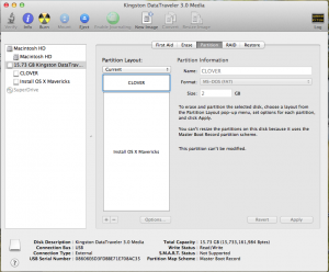

barracudamuscle Posted October 31, 2014 Share Posted October 31, 2014 Hello, Been lurking and decided to take the plunge into a hackintosh. My hardware Asus G74SX Bios 203 fresh install of windows 7 UEFI enabled in bios. Nvidia GTX 560M 16GB ram, 2 750GB HDD. Ive been following the guide from the genius bar by pokenguyen.. -Ive created the thumb drive partitioned with Clover(FAT)and Untitled(MAC OS ext journeled) MBR. -Utilized Vietnam tool and selected sandy bridge mobile for cpu, nvidia for GPU, and SST is custom from rehab mans ssdt.zip with the name shortened to ssdt.aml -I boot into the Clover Boot ROM, select install and get the blank screen. I went back tried different configurations and get the same result. I did try the boot flag verbose and all the configs get the same result: efiboot loaded from device: Acpi(PNP0A03,0)/PCI(1C|3)/PCI(0)/Usb(2, 0)/HD(Part2,Sig000000) boot file path: I cant type anything with a usb keyboard or my laptop keyboard. Where am I going wrong? Attached is a couple screen shots... I appreciate any and all help. New to the hackintosh idea and following the guides and spent 5 hours trying to wrap my head around this. Quote Link to comment Share on other sites More sharing options...

barracudamuscle Posted November 1, 2014 Author Share Posted November 1, 2014 Hi Pimentel, Thank you again for your continued support helping me. The link you referenced for the guide to try is exactly the guide I am following. The link #6 "Installing mavericks with clover UEFI" is what I've been utilizing. Have you or anyone else seen the error I received in the second picture I uploaded in the first post? Im not a cod ereader so not sure what that means to begin fixing it. Thank you all for any and all help! Quote Link to comment Share on other sites More sharing options...

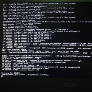

barracudamuscle Posted November 1, 2014 Author Share Posted November 1, 2014 Alright so I've made some progress and learned some things...... First I discovered the previous issue I had with the boot file to be because I used the wrong clover.zip files. I was copying the extras folder from the latest clover boot loader and not using the pre patched ones talked about in the guide. Once I got all that cleared up I got a different install screen background and tried to install. I was unsuccessful and it hung at the apple screen before the installer. Reading the recovery/partition method may cause computers to lock up on that screen I utilized the directions as instructed 2-6 for chameleon legacy bios. Made the Installer ESD, followed them through the pacifist procedure then put it on the root section of the usb installer. I ran into the same issue so used the boot flag -v to see whats going on. It seems to be hanging at this part shown in the picture. I'm not entirely sure what that is that is causing it but perhaps it will make since to some one else that knows way more then I do and maybe with any luck I can fix it to be able to install. Thanks for reading and any help is appreciated! Quote Link to comment Share on other sites More sharing options...
Pimentel Posted November 1, 2014 Share Posted November 1, 2014 Hello Use legacy mode please I thought that you have UEFI mobo. Other this problem is about graphic issue.... Try boot with: -x -v -f If it doesn't work remove all intel graphic kext from folder S/L/E. Use transmac for this job. Quote Link to comment Share on other sites More sharing options...
