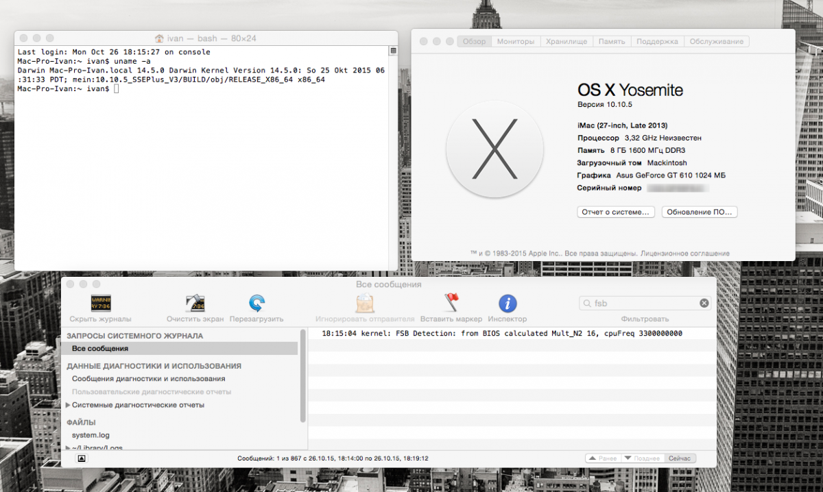

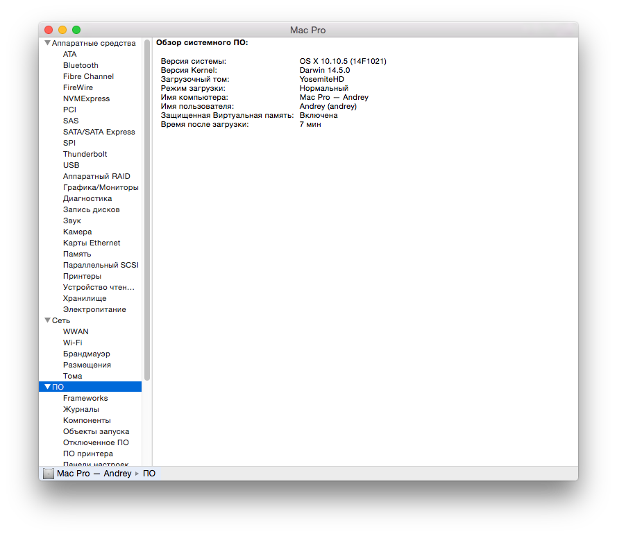

Hi there, so today I was updated to 10.10.5 (with 10.10.5_SSEPlus_V2 kernel) and Xcode to 7.1.
All works fine, but Xcode simulator.
Got this when trying to launch:
$ /Applications/Xcode.app/Contents/Developer/Applications/Simulator.app/Contents/MacOS/Simulator
dyld: warning, LC_RPATH @loader_path/../../../../Library/PrivateFrameworks in /Applications/Xcode.app/Contents/Developer/Applications/Simulator.app/Contents/MacOS/Simulator being ignored in restricted program because of @loader_path
dyld: Library not loaded: @rpath/SimulatorKit.framework/Versions/A/SimulatorKit
  Referenced from: /Applications/Xcode.app/Contents/Developer/Applications/Simulator.app/Contents/MacOS/Simulator
  Reason: image not found
Trace/BPT trap: 5

I was caught this before (with 10.10.4), so was fixed with kernel update. Any ideas about again raise?
UPD: after some fun with LLDB I found a reason: csops syscall returns CS_RESTRICT flag. May be an issue in kernel code. When manually clean this flag (by LLDB) before check Simulator starts normally.
UPD2: same issue with 10105R1 kernel.
Trace/BPT trap: 5

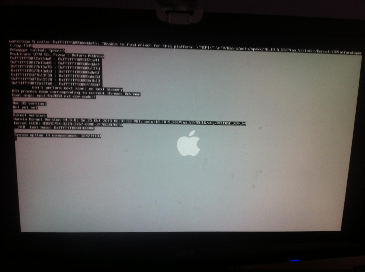

Thanks for such an excellent new kernel which is working for Yosemite 10.10.5 with AMD CPU Athlon 64 x2 6000+ in Asus M4A78 Plus MB.
However both V2 and V3 versions are not working for Yosemite 10.10.5 with AMD CPU Phenom 9850 in Asus M3A MB, in which only 10.10.5R1 works.
During booting by V2 or V3 kernel always very fast showing opcode errors with instant reboot, I could not catch its error message by computer.
Maybe try to use patched pthread.kext uploaded by Tora Chi Yo. ==> 10102-UPD-Patch-pthread.kext.zip
Also you can read this post: #1077, here Tora Chi Yo explaining about occuring the opcode error. I hope it will be useful for you.
No, your CPU is supported by the kernel !!

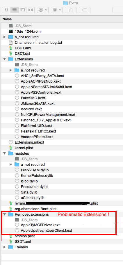

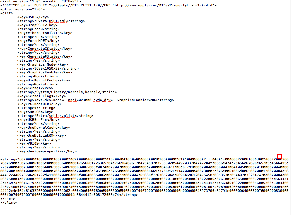

How to install:
1. Starting with a clean install, do not change as much as possible in  S/L/E (this experience we have made in recent weeks !!) AMD Radeon and NVIDIA graphics cards---> to remove the two problematic Extensions from S/L/E: AppleTyMCEDriver.kext and AppleUpstreamUserClient.kext (repair disk permissions in S/L/E )
2. Install the Chipset-, Nullpowermanagement.kext, Keyboard -and Mouse drivers etc.  in the folder Extra/Extensions.  (I use an additional a custom DSDT.aml and a rom-file for my nvidia Graphics card)
3. install Bootloader
4. for FX-CPUs: when system fails to boot, then install the packet of Carlo_67
but there are also different statements with package Contents. for some making problems for the other works very well .... for X4 CPUs ...? I do not know, but Should be similar to my Phenom II X6 CPU ....
..... for Nvidia graphics cards, install the Nvidia Web drivers or Cuda, if they are supported.
....if the system during the boot process ends in a black screen, then fix the problems by patching the AppleGraphicsControl.kext with the smbios.plist that you use, see the instruction from pikeralpha
here a picture from the contents of my Extra folder and my boot-file
about the sense/nonsense of some entries in my bootfile - not bothered by it., but my system work well
.... according to this principle, I have a lot of systems (more then > 20) successfully installed.
I hope that this information will help them further.
Edited by spakk

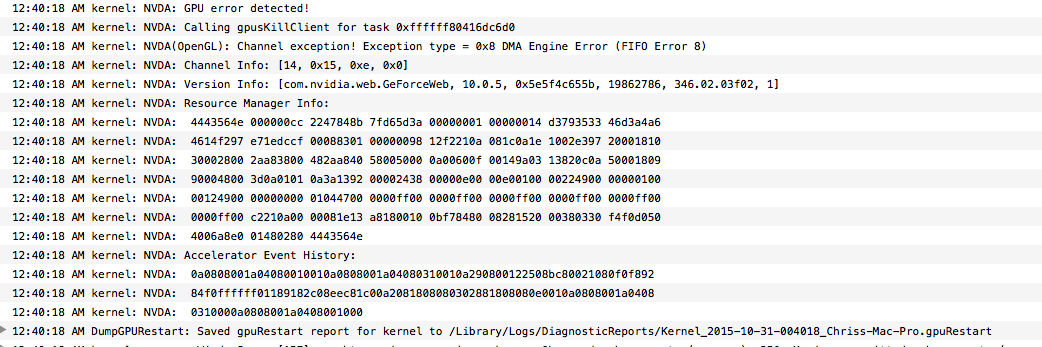

I have sort of an odd predicament that I can't seem to figure out. I've narrowed it down to issues between the kernel and NVIDIA Web Drivers. Sometimes (and it's very unpredictable), I'll have a "bad boot" and have some serious issues with mainly Finder and Safari hanging the system while loading. I have checked the console and I see the GPU restart every time this happens. I am currently running 10.10.5 (14F1021) with the v3 kernel linked a few pages back. My processor is an AMD A10 - 7850K. I have an EVGA GTX 960 ti with the latest version of the NVIDIA Web Drivers. This is a clean install with only NullCPUPowerManagement and FakeSMC installed. I primarily run Clover in UEFI as my boot loader, but this also happens with Enoch. I had zero problems on 10.10.4; these are unique to 10.10.5 and had the same issues before and after the security update. Also, they don't happen on every boot.
Sometimes, regardless of whether or not I have changed anything (and I usually haven't), it will boot up perfectly. Everything will run smooth as butter as it should. And at other random times, it will simply have a bad boot with these issues. If it was very intermittently and could knowingly be fixed by just one reboot, then I wouldn't worry about it, but sometimes I'll have to reboot 2 or 3 times for it to be fine.
I have attached a screenshot of my console and the actual GPURestart log. I should also add that I've tried about 2 or 3 different kernels (I think all three versions of the 10.10.5 kernel on this thread) and I have faced the same issues.
GPURestart.txt

we can not discuss these Problimatic here, because we come now off topic.
--> Nvidia graphics card problems-> delete the two Problematic drivers and patch the AppleGraphicsControl.kext, repair the disk permissions.
install the Web drivers and use a modified DSDT.
... or open a new page in which we discuss specially your problem, AMD A10 is something special.
