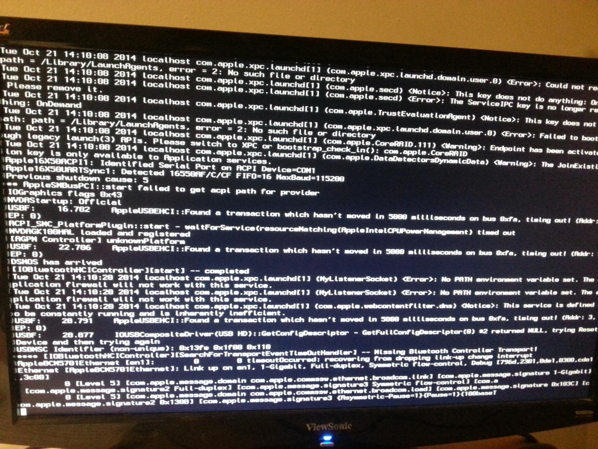

Hi, guys, help is needed.
I am trying to install Yosemite (14a389) to my HP z800 workstation, which has two Intel Xeon E5520 CPU and 96 GB ram. However, I am stuck at this screen and followed by a black screen (the screen is totally off).
Attached File  20141021_211112.jpg   234.98KB   25 downloads
To install it, I have installed only one SSD (tried on both SATA and SAS port, which is recognized by bios) and Nvidia GTX 760.
For install, I used the latest chamelon (on a USB thumb drive) for boot and another SSD for install file disk.
Boot arguments:
1. -v -f kext-dev-mode=1
2. -v -f kext-dev-mode=1 npci=0x2000
The hardware specs:
Chipset Intel 5520
2x Intel Xeon E5520, 2.26 GHz, 8 MB cache, 1066 MHz Memory, 5.86 GT/s QPI, 80W
96 GB (12x8 GB) DDR3-1333 ECC Registered RAM 2-CPU
Nvidia GTX 760
Thanks!

If you use the ##### method, then you'll be able to boot into the installer
Only issue is that it won't recognise any of your drives... the AHCI drivers aren't present
I managed to install Yosemite on an external USB HDD, but it was slow as hell... not even usable enough to run ##### to attempt to fix the AHCI driver issue :-/
I guess you could try to put them in Extra on the ##### stick

Try to boot with -v kext-dev-mode=1 GraphicsEnabler= No
If still see black screen add more PciRoot=1

to solve you problem you need use clover boot loader r3050
in folder /clover/EFI/CLOVER/kext/10.10 copy FakeSMC.kext & NullCPUPowerManagement.kext  (by tonymacosx86) LegacyIntelACPI.kext
link to SAS kext http://www.insanelym...aid-sas-family/
in clover options don't use "NewWay" & "Patch Darwin" - this causes panic
others have virtually  practically no effect
start flag -v -x npci=2000
but i have problem normal work graphics nvidia
in safe mode system start
if you know how to fix nvidia it write a PM
if I find something I'll let you know
how you run setup ? without acpi kext ?
in clover problem in acpi, without legacy don't detect hdd or ssd
good luck

Hi, guys,
Thanks for your help. I finally got 10.9.1 runs on my HP z800 and everything runs very well. I use boot flag "GraphicsEnabler=no PCIRootUID=0 -v -f". It seems that, I need to use 10.9.1 and nothing later than it will work. Perhaps I need to roll back some kexts.
The detailed step is described in http://167.88.47.13/?p=261
