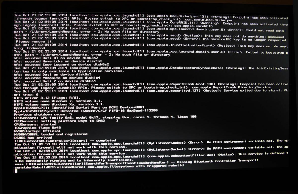

RichieKotzen Posted October 21, 2014 Share Posted October 21, 2014 to install, I'm using r2953 Cloverhere's the picture where it stops.there is also my config.plistmy configuration isMotherboard Asus P5Q Pro TurboNvidia GeForce 9800GT2.68 GHz Quad-Core Intel Xeon config.zip Link to comment Share on other sites More sharing options...

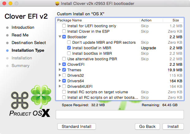

johncool Posted October 22, 2014 Share Posted October 22, 2014 Follow this link. That's how I installed Yosemite with Clover on my 775 board. http://www.skylineosx.com/installation/switching-from-chameleonchimera-to-clover/ Link to comment Share on other sites More sharing options...
luki1979 Posted October 24, 2014 Share Posted October 24, 2014 Yes just follow that guide but with this clover (2953) settings: Make sure you got Mac Pro 3,1 in smbios use Clover Configurator to edit config file on your USB you might need these boot flags for Xeon: npci=0x2000 cpus=1 If you need cpus=1 install tscsync package to enable all cores on your Xeon tscsync.pkg.zip Link to comment Share on other sites More sharing options...
