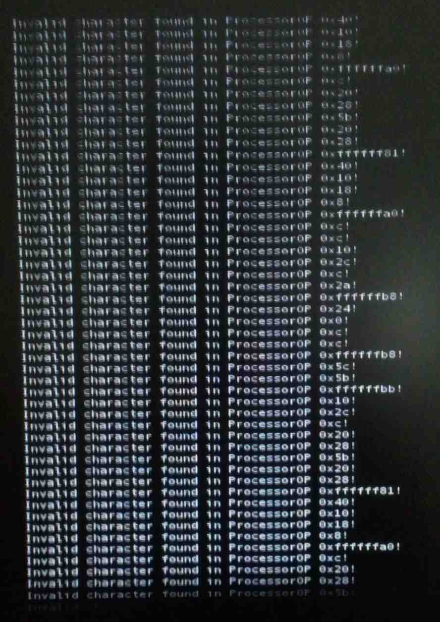

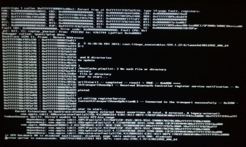

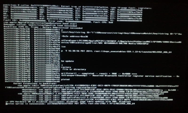

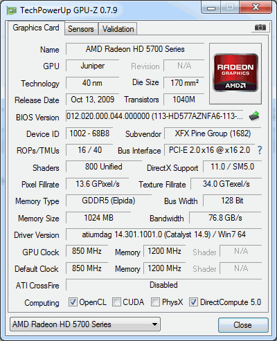

tntmaxx Posted October 21, 2014 Author Share Posted October 21, 2014 Thank you I attached : - the full report of DarwinDumper - GPU-Z screeshot (Windows program) - Camera Picture of Verbose Mode of Kernel Panic when GraphicsEnabler=No DarwinDumper_2.9.6_Chameleon_2.2_X64_Yos_terence.zip Link to comment Share on other sites More sharing options...

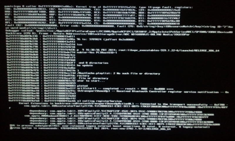

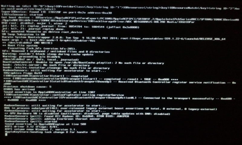

tntmaxx Posted October 21, 2014 Author Share Posted October 21, 2014 I attached : - Camera picture of Verbose mode with -x and without (Without your DSDT) - Camera picture of With your DSDT (Verbose mode with -x and without) - Screenshot of Post-Installation option (for me there is no graphics fix but I could be wrong) To install your DSDT, I renamed DSDT.dsl in DSDT.aml (I placed it in / Extra) then I said in org.chameleon.Boot.plist I have not had time to change SMBIOS information, but I will. Link to comment Share on other sites More sharing options...

tntmaxx Posted October 21, 2014 Author Share Posted October 21, 2014 I used the new DSDT, but the result did not change: - Kernel Panic when GraphicsEnabler=No - Versobe displayed only on monitor and GUI available by VNC only when GraphicsEnabler=Yes I am ready to resume my installation from scratch. http://wiki.osx86project.org/wiki/index.php/Installation_Guides#10.10_Guides This page offers installation method to Clover, but I find it very complicated. Could you give me some advice? Link to comment Share on other sites More sharing options...

tntmaxx Posted October 25, 2014 Author Share Posted October 25, 2014 I found this post and I tried these settings but I have no change: no GUI display on my HDMI monitor : http://www.hackintoshosx.com/topic/16981-guide-xfx-hd5770-triple-monitor-1083/ Attached the org.chameleon.Boot.plist used the + /Extra/1002_68B8.rom Kernel Panic with the boot options manually typed: GraphicsEnabler=No + PCIRootUID=0 GraphicsEnabler=No + PCIRootUID=1 GraphicsEnabler=No GraphicsEnabler=Yes + PCIRootUID=1 Standing with verbose GUI available for VNC GraphicsEnabler=Yes GraphicsEnabler=Yes + PCIRootUID=0 Be aware that the BIOS on my 5770 is this http://www.techpowerup.com/vgabios/91984/xfx-hd5770-1024-101101.html I put instead of /Extra/1002_68B8.rom but it gives the same results. 1002_68B8.rom.zip org.chameleon.Boot.plist.zip Link to comment Share on other sites More sharing options...
