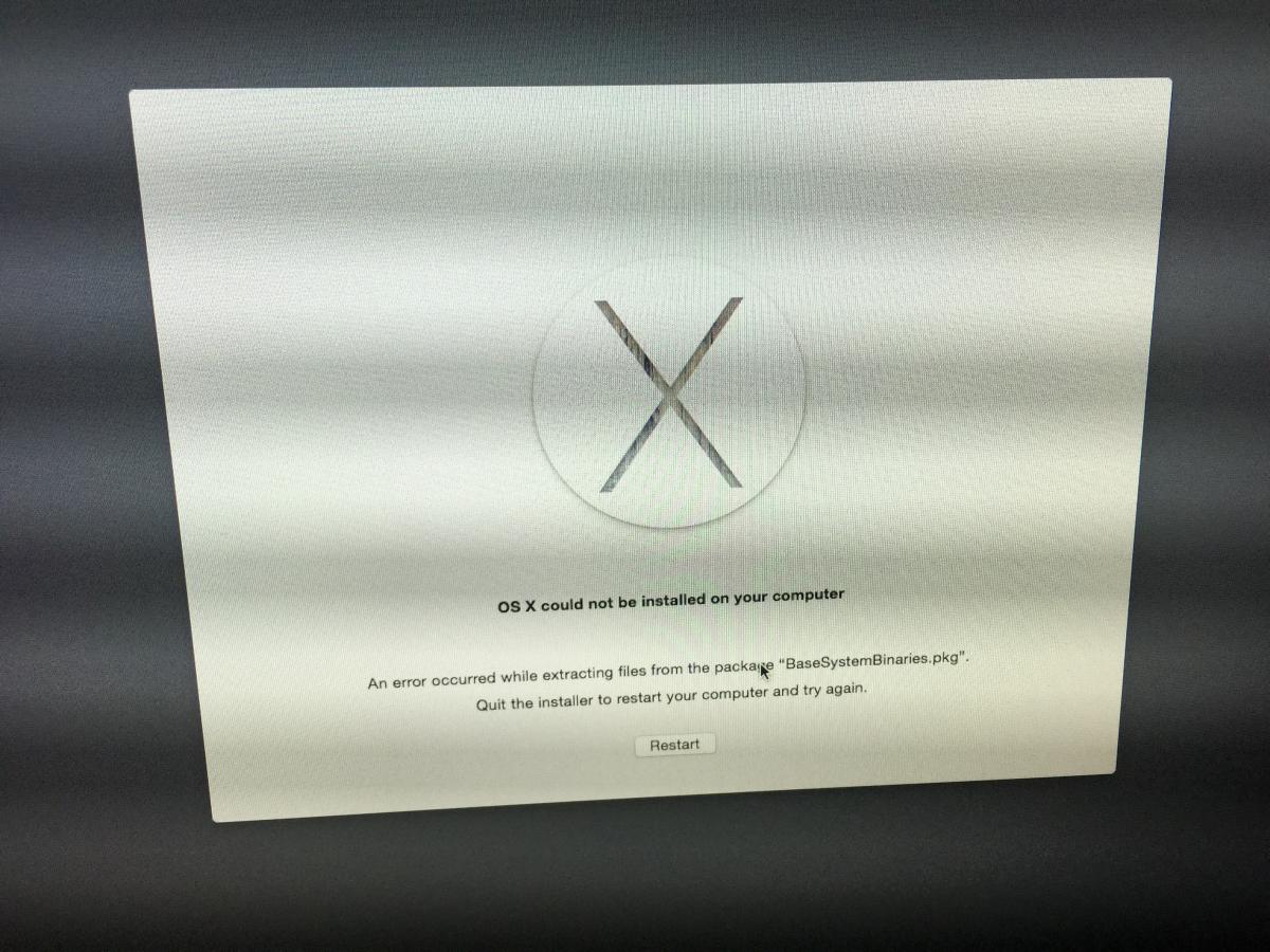

DSeven Posted October 18, 2014 Share Posted October 18, 2014 I have problems with Installing Process... Everything boot up super. But i'm stuck on Copying Files.. I'm tried 3 different USB Storage, no difference. i use Samsung Evo SSD 840 512Gig. Quote Link to comment Share on other sites More sharing options...
gils83 Posted October 18, 2014 Share Posted October 18, 2014 what méthode ? look #1 Quote Link to comment Share on other sites More sharing options...
DSeven Posted October 18, 2014 Author Share Posted October 18, 2014 I solved this problem using flags npci=0x2000 and maxmem=8192 ! Quote Link to comment Share on other sites More sharing options...
