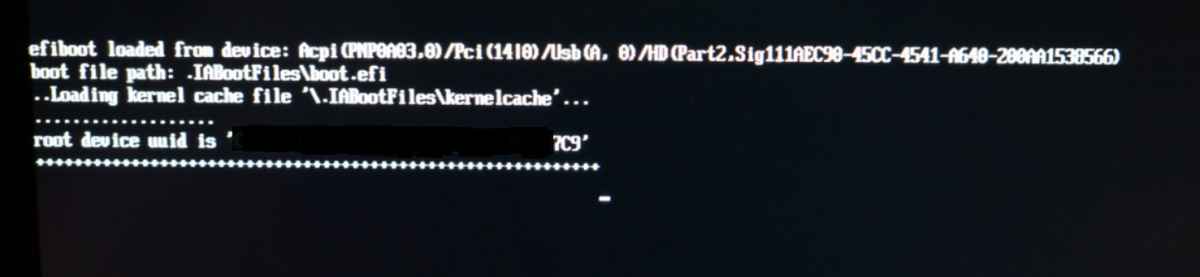

Windserfer Posted October 6, 2014 Share Posted October 6, 2014 Hello guys! I'm trying to install OS X on my new pc that doesn't have any option to "legacy" boot so no chameleon. To my understanding the only uefi bootloader available is Clover. I've succesfully installed it on an usb disk but when i load the usb Disk of Yosemite it loads the drivers and gets stuck after writing a lot of +++++++++. Anyone of you knows what it is doing or what the ++++ means? Thank You! Link to comment Share on other sites More sharing options...
artur_pt Posted October 6, 2014 Share Posted October 6, 2014 hello is stuck in cache.. if u use any third part kext in s/l/e must use flag kext-dev-mode=1 try to boot single user mode follow on screen instrucitions to mount the hd volume then kextcache -prelinked-kernel reboot good hack 1 Link to comment Share on other sites More sharing options...

Windserfer Posted October 8, 2014 Author Share Posted October 8, 2014 OK, so i tried to boot in single user mode without success so I had no way to reset the cache. I decided to try with 10.9 as it seems to be easier to boot, at least now. But it still hangs at the ++++++++++ This is the log of clover but it seems fine to me 194:170 49:274 StartLoader() start 194:248 0:078 Finally: Bus=99768kHz CPU=1995MHz 194:326 0:077 Kernel and Kext Patches: 194:471 0:144 Allowed: y 194:549 0:077 Debug: n 194:626 0:077 KernelCpu: n 194:739 0:113 Lapic: n 194:818 0:078 AICPUPM: n 194:895 0:077 AppleRTC: y 194:974 0:079 KernelPm: n 195:053 0:079 FakeCPUID: 0x0 195:129 0:076 ATIController: <null string> 195:208 0:078 ATIDataLength: 0 195:286 0:078 0 Kexts to load 195:364 0:078 1 Kexts to patch 195:441 0:077 KextPatch[0]: 8 bytes, AppleAHCIPort 195:518 0:077 Loading boot.efi 195:888 0:369 Corrected OSVersion: 10.9 195:967 0:079 EmuVariable InstallEmulation: orig vars copied, emu.var.services installed, CreateEvent = Success, done 196:376 0:408 SMBIOS and SPD contain no modules in use 196:453 0:077 NumberOfMemoryDevices = 0 196:530 0:077 Table 131 is present, CPUType=35 196:607 0:077 Change to: 605 196:685 0:077 RSDT 0xACFAE0C4 196:762 0:077 FADT from RSDT: 0xACFD7000 196:879 0:117 XSDT 0xACFAE188 196:956 0:077 FADT from XSDT: 0xACFD7000 197:034 0:077 Xsdt reallocation done 197:180 0:145 old FADT length=F4 197:257 0:077 Found OperationRegion(GNVS, SystemMemory, ACF8A000, ...) 197:334 0:077 Found OperationRegion(MCHT, SystemMemory, FED10000, ...) 197:412 0:078 Found OperationRegion(RP_X, SystemMemory, 0, ...) 197:491 0:078 Found OperationRegion(MBAR, SystemMemory, 0, ...) 197:568 0:077 Found OperationRegion(RP_X, SystemMemory, 0, ...) 197:645 0:077 Found OperationRegion(TNVS, SystemMemory, ACA9BE18, ...) 197:722 0:077 Found OperationRegion(PXVD, SystemMemory, 0, ...) 197:868 0:145 Found OperationRegion(MMMM, SystemMemory, 0, ...) 197:945 0:077 Found OperationRegion(PXVD, SystemMemory, 0, ...) 198:023 0:077 Found OperationRegion(PXVD, SystemMemory, 0, ...) 198:100 0:077 Found OperationRegion(MMMM, SystemMemory, 0, ...) 198:177 0:077 Found OperationRegion(RCRB, SystemMemory, FED1C000, ...) 198:253 0:076 Found OperationRegion(XHCP, SystemMemory, 0, ...) 198:331 0:077 Found OperationRegion(MCA1, SystemMemory, 0, ...) 198:476 0:145 Found OperationRegion(MCA1, SystemMemory, 0, ...) 198:592 0:115 Found OperationRegion(SDCH, SystemMemory, 0, ...) 198:669 0:077 Found OperationRegion(DMB1, SystemMemory, 0, ...) 198:746 0:077 Found OperationRegion(ICB1, SystemMemory, 0, ...) 198:824 0:077 Found OperationRegion(ICB1, SystemMemory, 0, ...) 198:903 0:078 Found OperationRegion(ICB1, SystemMemory, 0, ...) 198:980 0:077 Found OperationRegion(ICB1, SystemMemory, 0, ...) 199:057 0:077 Found OperationRegion(ICB1, SystemMemory, 0, ...) 199:204 0:146 Found OperationRegion(ICB1, SystemMemory, 0, ...) 199:282 0:077 Found OperationRegion(ICB1, SystemMemory, 0, ...) 199:359 0:077 Found OperationRegion(ICB1, SystemMemory, 0, ...) 199:435 0:076 Found OperationRegion(ICB1, SystemMemory, 0, ...) 199:512 0:077 Found OperationRegion(ICB1, SystemMemory, 0, ...) 199:589 0:077 Found OperationRegion(ICB1, SystemMemory, 0, ...) 199:667 0:077 Found OperationRegion(ICB1, SystemMemory, 0, ...) 199:744 0:077 Found OperationRegion(ICB1, SystemMemory, 0, ...) 199:890 0:145 Found OperationRegion(ICB1, SystemMemory, 0, ...) 199:967 0:077 DSDT len = 0x195AE new len = 0x1C863 200:122 0:154 Apply DsdtFixMask=0x9FCAE955 new way 200:199 0:077 drop _DSM mask=0x0000 200:277 0:077 ========= Auto patch DSDT Starting ======== 200:392 0:115 VideoCard devID=0xA268086 200:470 0:078 DisplayADR1[0] = 0x20000, DisplayADR2[0] = 0xFFFE 200:724 0:253 USBADR[0] = 0x140000 and PCIe = 0xFFFE 200:981 0:257 first CPU found at DD98 offset DD9C 201:127 0:145 score candidate at DD94 201:204 0:077 score inserted in acpi_cpu_score _PR_ 201:281 0:077 Found ACPI CPU: CPU0 And CPU1 And CPU2 And CPU3 And CPU4 And CPU5 And CPU6 And CPU7 within the score: _PR_ 201:977 0:695 Found PCIROOTUID = 0 202:054 0:077 Start RTC Fix 202:131 0:077 found RTC Length not match, Maybe will case CMOS reset will patch it. 202:208 0:077 found RTC had IRQNoFlag will move -3 bytes 202:286 0:077 ...len=195EB 202:460 0:173 new size written to 7D5C shift=0 len=195EB 202:576 0:116 len after correct outers 195EB 202:653 0:077 Start PIC Fix 202:730 0:077 PIC size=A5 at 7B82 202:808 0:077 found CRS at 7B96 size 8D 202:886 0:078 found PIC had IRQNoFlag will move -3 bytes 202:964 0:078 Fix Device PIC size -3 203:042 0:077 Start HPET Fix 203:121 0:078 patch HDEF in DSDT 203:199 0:078 Start HDA Fix 203:277 0:077 found HDA device NAME(_ADR,0x001B0000) And Name is HDEF 203:354 0:077 NewName HDEF already present, renaming impossibble 203:529 0:174 Start Add IMEI 203:606 0:076 deleting device CRT_ 203:684 0:077 deleting device DVI_ 203:762 0:077 deleting device SPKR 203:839 0:077 deleting device ECP_ 203:918 0:078 deleting device LPT_ 203:996 0:077 deleting device FDC0 204:074 0:077 deleting device ECP1 204:152 0:077 deleting device LPT1 204:232 0:080 Start PNLF Fix 204:309 0:077 found PWRB at 78AE 204:424 0:114 Start _S3D Fix 204:504 0:080 OperationRegion (GNVS...) corrected to addr=0xACF8A000 204:676 0:172 OperationRegion (MCHT...) corrected to addr=0xFED10000 204:754 0:077 OperationRegion (RP_X...) corrected to addr=0x0 204:831 0:077 OperationRegion (MBAR...) corrected to addr=0x0 204:908 0:077 OperationRegion (RP_X...) corrected to addr=0x0 204:986 0:077 indirect name=TMNA 205:064 0:078 OperationRegion (TNVS...) corrected to addr=0xACA9BE18 205:141 0:077 OperationRegion (PXVD...) corrected to addr=0x0 205:217 0:075 OperationRegion (MMMM...) corrected to addr=0x0 205:417 0:199 OperationRegion (PXVD...) corrected to addr=0x0 205:493 0:076 OperationRegion (PXVD...) corrected to addr=0x0 205:569 0:076 OperationRegion (MMMM...) corrected to addr=0x0 205:645 0:076 indirect name=SRCB 205:722 0:076 OperationRegion (RCRB...) corrected to addr=0xFED1C000 205:798 0:076 OperationRegion (XHCP...) corrected to addr=0x0 205:874 0:076 OperationRegion (MCA1...) corrected to addr=0x0 205:950 0:076 OperationRegion (MCA1...) corrected to addr=0x0 206:122 0:171 OperationRegion (SDCH...) corrected to addr=0x0 206:198 0:076 OperationRegion (DMB1...) corrected to addr=0x0 206:274 0:076 OperationRegion (ICB1...) corrected to addr=0x0 206:387 0:113 OperationRegion (ICB1...) corrected to addr=0x0 206:463 0:076 OperationRegion (ICB1...) corrected to addr=0x0 206:540 0:076 OperationRegion (ICB1...) corrected to addr=0x0 206:616 0:076 OperationRegion (ICB1...) corrected to addr=0x0 206:693 0:076 OperationRegion (ICB1...) corrected to addr=0x0 206:863 0:170 OperationRegion (ICB1...) corrected to addr=0x0 206:940 0:076 OperationRegion (ICB1...) corrected to addr=0x0 207:016 0:076 OperationRegion (ICB1...) corrected to addr=0x0 207:093 0:077 OperationRegion (ICB1...) corrected to addr=0x0 207:169 0:076 OperationRegion (ICB1...) corrected to addr=0x0 207:245 0:076 OperationRegion (ICB1...) corrected to addr=0x0 207:322 0:076 OperationRegion (ICB1...) corrected to addr=0x0 207:398 0:076 OperationRegion (ICB1...) corrected to addr=0x0 207:569 0:171 Start ADP1 fix 207:645 0:076 NewName ADP1 already present, renaming impossibble 207:722 0:076 Start SHUTDOWN Fix len=193B4 207:799 0:076 ========= Auto patch DSDT Finished ======== 207:875 0:076 Attempting to drop "DMAR" (52414D44) " HSW " (0000000020575348) L=296 207:951 0:076 Drop tables from Xsdt, SIGN=DMAR TableID=HSW Length=296 208:027 0:076 Xsdt has tables count=30 208:104 0:076 Table: DMAR HSW 296 dropped 208:276 0:171 corrected XSDT length=268 208:352 0:076 Attempting to drop "SSDT" (54445353) " CpuPm" (0000006D50757043) L=2776 208:433 0:081 Drop tables from Xsdt, SIGN=SSDT TableID=CpuPm Length=2776 208:547 0:114 Xsdt has tables count=29 208:624 0:076 Table: SSDT CpuPm 2776 dropped 208:700 0:076 corrected XSDT length=260 208:777 0:077 Attempting to drop "SSDT" (54445353) " Cpu0Ist" (0074734930757043) L=1372 208:853 0:076 Drop tables from Xsdt, SIGN=SSDT TableID=Cpu0Ist Length=1372 209:024 0:171 Xsdt has tables count=28 209:101 0:076 Table: SSDT Cpu0Ist 1372 dropped 209:177 0:076 corrected XSDT length=252 209:253 0:076 Patch table: SSDT ADebTabl 209:328 0:075 SSDT len = 0xB1 209:404 0:076 Patch table: SSDT DptfFfrd 209:481 0:076 SSDT len = 0x5D2E 209:558 0:077 Patch table: SSDT Tpm2Tabl 209:634 0:076 SSDT len = 0x48A 209:710 0:076 Patch table: SSDT MeSsdt 209:787 0:076 SSDT len = 0x4E 209:863 0:076 Patch table: SSDT PerfTune 209:939 0:076 SSDT len = 0x6B2 210:110 0:171 Patch table: SSDT PtidDevc 210:186 0:076 SSDT len = 0x2028 210:262 0:076 Patch table: SSDT HSW-FFRD 210:339 0:076 SSDT len = 0x1AA5 210:415 0:076 Patch table: SSDT sensrhub 210:498 0:083 SSDT len = 0x228 210:573 0:075 Patch table: SSDT SaSsdt 210:687 0:113 SSDT len = 0x342C 210:762 0:075 Patch table: SSDT CppcTabl 210:838 0:076 SSDT len = 0x6A7 210:916 0:078 Patch table: SSDT Cpc_Tabl 210:993 0:076 SSDT len = 0xAC4 211:164 0:171 Drop tables from Xsdt, SIGN=XXXX TableID= Length=0 211:240 0:076 Xsdt has tables count=27 211:316 0:076 corrected XSDT length=252 211:394 0:077 CPUBase=0 and ApicCPUBase=1 ApicCPUNum=8 211:470 0:076 Maximum control=0x14 211:546 0:076 Turbo control=0x1D 211:622 0:076 P-States: min 0x8, max 0x1D 211:699 0:076 SSDT with CPU P-States generated successfully 211:775 0:076 SSDT with CPU C-States generated successfully 211:850 0:075 EdidDiscovered size=128 211:926 0:076 Intel Intel HD Graphics 5000 [8086:0A26] :: PciRoot(0x0)\Pci(0x2,0x0) 212:097 0:171 Intel GFX revision =0x9 212:174 0:076 USB Controller [8086:9C31] :: PciRoot(0x0)\Pci(0x14,0x0) 212:250 0:076 stringlength = 1246 212:327 0:076 CurrentMode: Width=1920 Height=1080 212:403 0:076 FSInjection: skipping kext injection (not requested) 212:638 0:234 MSR 0x1B0 set to 00000000 212:714 0:076 RemoveStartupDiskVolume: 212:829 0:115 * efi-boot-device = Not Found 212:905 0:076 * efi-boot-device-data = Not Found 213:077 0:172 * BootCampHD = Not Found 213:154 0:076 Custom boot screen not used because entry has unset use graphics 213:231 0:076 Failed to initialize custom boot screen: Aborted! 213:307 0:076 Closing log I tried also playing with the kexts and drivers of uefi but again i get stuck at the ++++++++ Any other ideas? Thank you Link to comment Share on other sites More sharing options...
artur_pt Posted October 8, 2014 Share Posted October 8, 2014 hello try to boot space bar withoutCaches good hack 1 Link to comment Share on other sites More sharing options...
Windserfer Posted October 8, 2014 Author Share Posted October 8, 2014 ;( Nothing changed EDIT!!!! Ok, I solved the problem! It was somewhere in the confi.plist! I found one made by someone else for an HP pc and it worked! Thank You for your support! Link to comment Share on other sites More sharing options...
