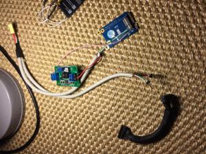

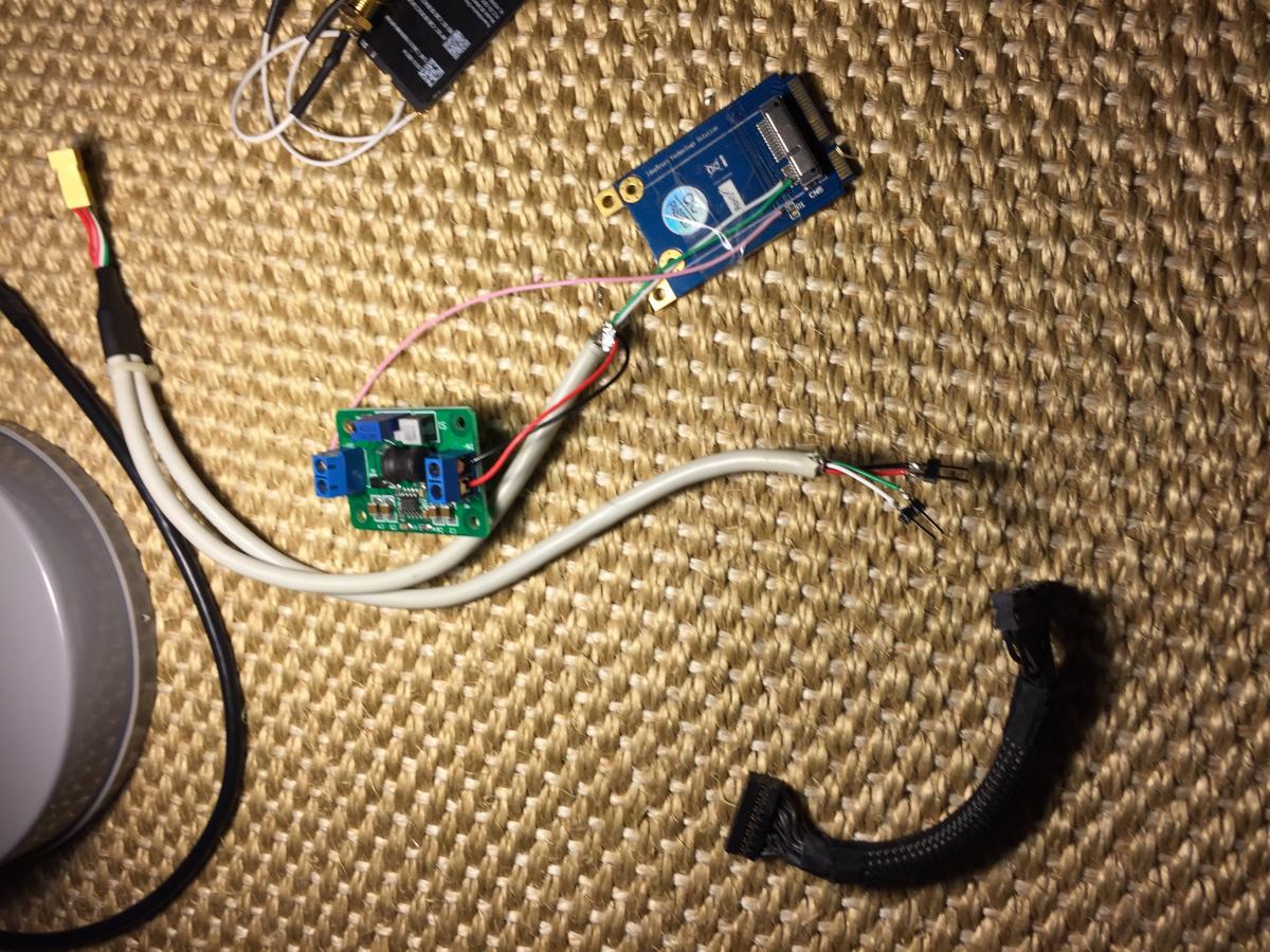

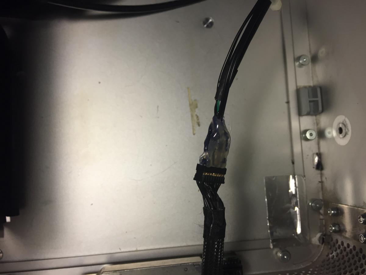

Just connected front panel, as I don't need front firewire or audio I connected PWR button ground to FW ground and LED to HDD LED on motherboard, only + was needed here as it fetches ground from USB connector. I finished connector in hot glue.
Ugly....... :(
Ugly....... :(
but safe :)

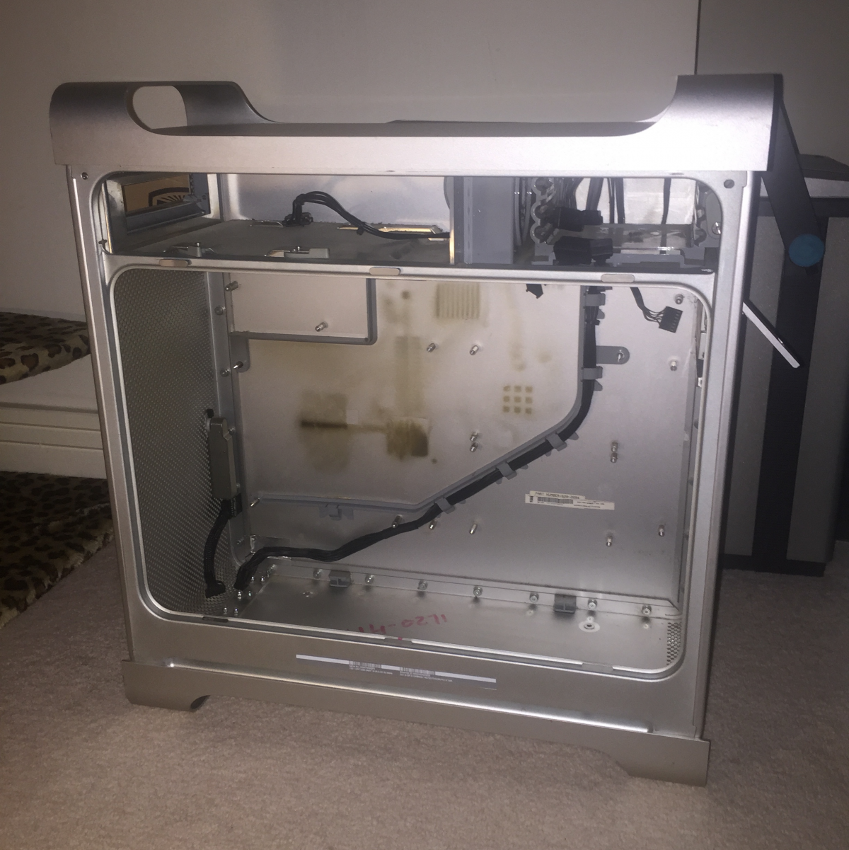

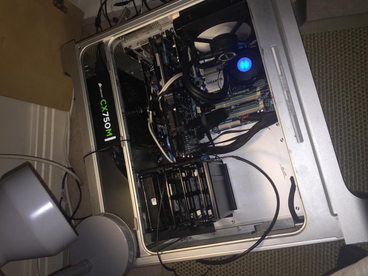

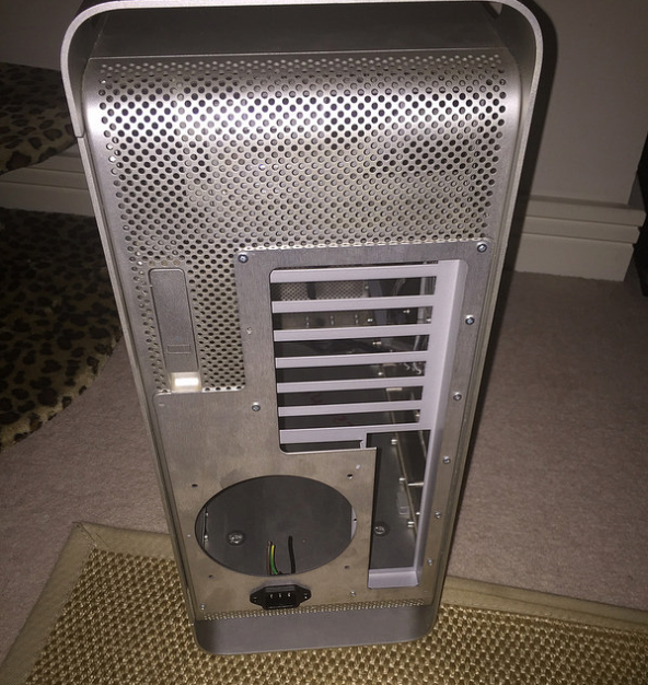

Pretty much finished now. I don't like red LED fan so I will replace with another Antec. There is one 120mm fan in front of SSD bay and one (freaking red) in front of recycled G5 HDD bay.
Case sticks out from my desk is so big but I like it, looks professional I'm glad I decided not to cut and paint.
I'll put more pictures up when 100% done

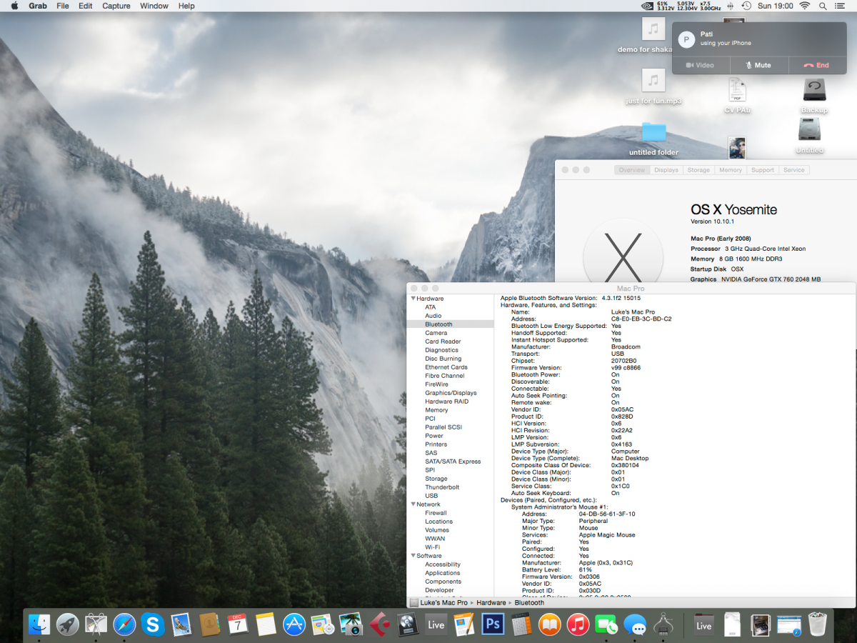

@husaber, Thanks a lot its working now, I can boot to Yosemite, happy.. :)
i'm Happy now :drool: another Xeon is running here.. :hysterical:
