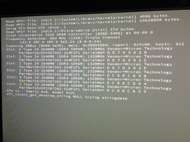

Matte82 Posted April 21, 2015 Share Posted April 21, 2015 This is where I get to. I didn't change anything on the USB stick. Just ran the installer as shown in the video. What do I do next? Link to comment Share on other sites More sharing options...
RiotMode Posted April 21, 2015 Author Share Posted April 21, 2015 Check your Bios Settings: Storage->Options->SATA Emulation = RAID+AHCI Security->Network Service Boot = Disable Advanced->Device Options->S5 Wake on Lan = Disable Advanced->Processors->Active Cores = All Cores. Advanced->Device Options->SATA RAID Option ROM download = Enable Next:try to boot with this flags -v npci=0x2000 If its not working, try to recheck SMBIOS.plist :SMBios with MacPro5,1 LGA1366 "Westmere" created via Chamäleon Wizard -v, USBBusFix=Yes, Enable C4, Ethernet-BuiltIn=Yes, C-States, Drop SSDT, DSDT & SMBiosnext:delete AppleTyMCEDriver.kext & AppleUserUpstreamClient.kext from S/L/E AHCIPortInjector.kext needed in S/L/E on USBTry to get this USB-Boot working for installation ... then u need your HDD/SSD in an external case, because your SATA isn't working properly without a JMicron-Controllerputting your Z600 hdd in an external case, gives you the possibility to install OSX on it... Link to comment Share on other sites More sharing options...
Matte82 Posted April 21, 2015 Share Posted April 21, 2015 I keep getting stuck around the same place. I tried all your steps, and nothing really changed. When I changed the plist with the changes you suggested, it stops at CPU is , family 0x6, model 0x2c Which is the line before where it was stopping. I double checked that I had the same BIOS settings. I even remembered there was a Nvidia Quadro 580 card I could try out of another PC. At least until I get this one sorted. I'm just not sure what else to try. I appreciate the help for sure. Link to comment Share on other sites More sharing options...
RiotMode Posted April 21, 2015 Author Share Posted April 21, 2015 i don't think that the graphics are the problem, but i can't really tell you what your problem is BLUETOOTH.io....... are most common graphics issues, but you stuck a while before this... so u got some other issues here... I never had those errors, but i installed 10.9 on my Z600.... maybe there is some difference... I would recommend to ask a better "hackintosher" than me - i am not a pro - but got it to work .... with very helpful guys around the web... Did you already tried cpus=1 - to disable all those cores ? Did you already search for some AHCIPortInjector.kext !? and installed it ? - have u repaired the permission on the stick ? Sorry but currently i'm very busy and can't get much into this.... but if i find some time, i will translate the Z600 installation for you guys into english... and hope this will help a bit... but let me know how its going ! GOOD LUCK man! _ Never give up - i needed more then 6 Days to install the z600, but now i am very satisfied with it - so keep on it! 2 Link to comment Share on other sites More sharing options...
Matte82 Posted April 21, 2015 Share Posted April 21, 2015 I appreciate it. I haven't tried cpus=1. I will. And yes I found someone that had posted their kexts and extras file from a Z600. Don't remember where now. I didn't think the repair permissions. I will do that also. No rush. I am pretty stubborn and will figure it out. If I can get his sorted it will be my audio rig for a long time into the future. I'll see what other ideas I can come across. Thanks agian Link to comment Share on other sites More sharing options...
Matte82 Posted April 21, 2015 Share Posted April 21, 2015 Alright. I might, just might, be getting somewhere. Between the German forum and this http://www.insanelymac.com/forum/topic/280756-guide-the-all-in-one-guide-to-vanilla-os-x-including-chameleon-dsdt-for-beginners-updated-for-yosemite/, I got it to boot. I had to use the flags -v -x GraphicsEnabler=Yes. As expected it didn't see my Hard drive on Sata. So I put it in a USB adapter, and it's now installing. I'll let you know what else happens. Link to comment Share on other sites More sharing options...
