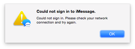

Hi, folks!
I just noticed a strange behavior with both FaceTime and iMessage, after not having been notified by iMessage on my Mac when them messages were arriving on my iPhone, for a while now. In fact, I think, since I installed DP4. I left it alone this time because of other priorities, but decided to fix it today. I obviously thought I was having some of that odd authentication issues, despite having done all the steps to get it set up properly. But when I opened Messages to check if I could log in, I realized I was already logged in! I tried to sign out and in, and it went without issues. But the issue persisted. Despite being logged in, I'm not receiving any iMessages. I'm not able to send any iMessages either: at first, all tries returned "this number/address is not registered to iMessages". Afterwards, the option was simply not available to any of my contacts!

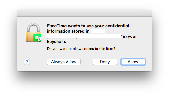

That's not all: I decided to check FaceTime, because the issues that affect iMessage use to affect also FaceTime, and I was worried for a good reason: FaceTime also logs in and out fine, but won't let me start a conversation, both audio and video, with any of my contacts!
Is there anyone experiencing the same kind of problems? If there is, I wonder if Apple decided to deliver us a sucker punch and changed (again) the way it authenticates its services...
All the best!
P.S.: I just realized I'm being consistently kicked from iMessage after a couple of minutes, having to log in again! If I try to log in to FaceTime, i'm kicked immediately! What the heck...?

Exactly the same message I get, ekika! Plus, I'm kicked from iMessage (which is not working anyway, despite log in successfully) every time I try to log in to FaceTime.

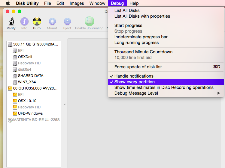

PS I find enabling the debug mode in Disk Utility and showing all partitions makes mounting the EFI very easy
defaults write com.apple.DiskUtility DUDebugMenuEnabled 1

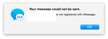

FaceTime and iMessage still don't work. Everything else is fine.

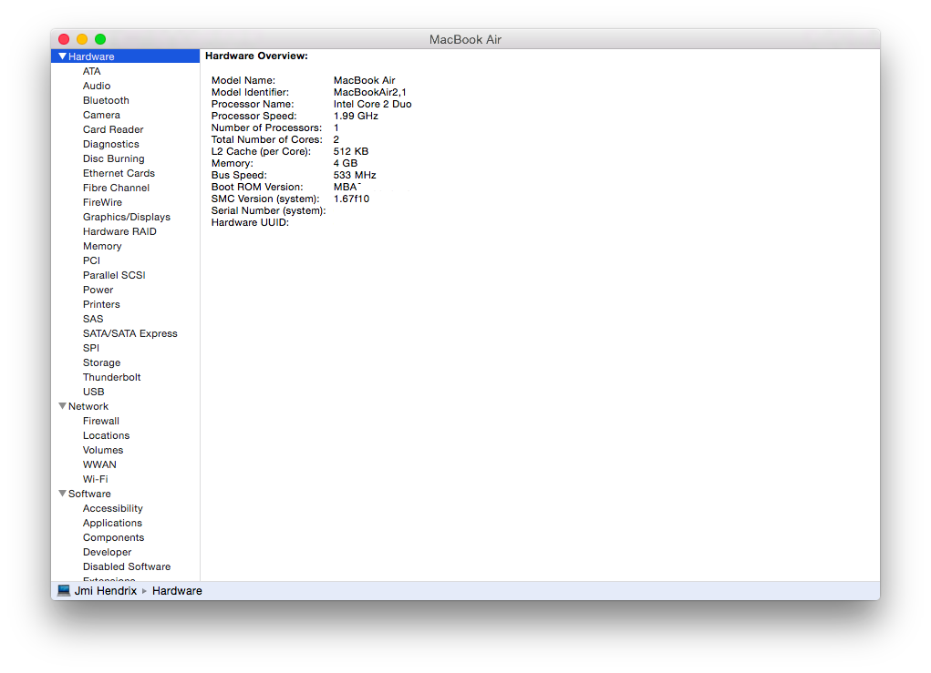

Applying MLB & ROM to the "RT Variables" section in Clover (and MLB in Main Board Serial key in SMBIOS section of config.plist) ----> your hack will show the same model in the "About this Mac" screen as the "donor" Mac but since everything else in the SMBIOS section is correct, then Clover uses the appropriate SMBIOS for power management, sleep etc.

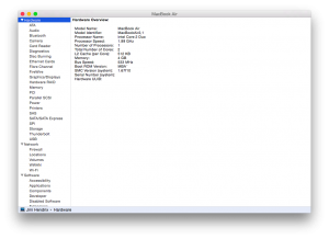

Well, the solution worked very well for my desktop mackintosh. Unfortunately, no luck for my 1201N: I still cannot log in to iMessage, getting a classic authentication failure or "check your network connection" box (attached below). About FaceTime, I can actually log in to it, but cannot stay so for more than a few seconds: soon, a keychain access message pops up (also attached bellow) and, no matter what I choose from the options presented, I'm kicked out from the server and cannot log back in. Also. I noticed that I still have MacBookAir 2,1 on my system report, instead of my "donor" MacBookPro 8,1 (attached bellow). At first I though I did something wrong with the config.plist, but I don't seem to find the eventual mistake (attached below). Can you take a look?
All the best!

The fact that "About this Mac" doesn't show the model of the "donor" Mac suggests that your config.plist isn't being saved correctly or being saved in the wrong location in the EFI.  See this post by @MilesTeg1 who had similar symptoms to you but later discovered that his config.plist wasn't being saved in the EFI!!!

P.s.: I'm worried my nvram isn't working properly, despite having a nvram plist at the root, because I'm prompted to input my iCloud password every time I start my computer.
