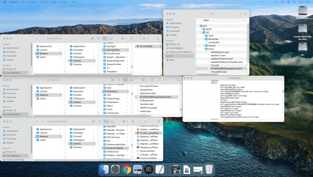

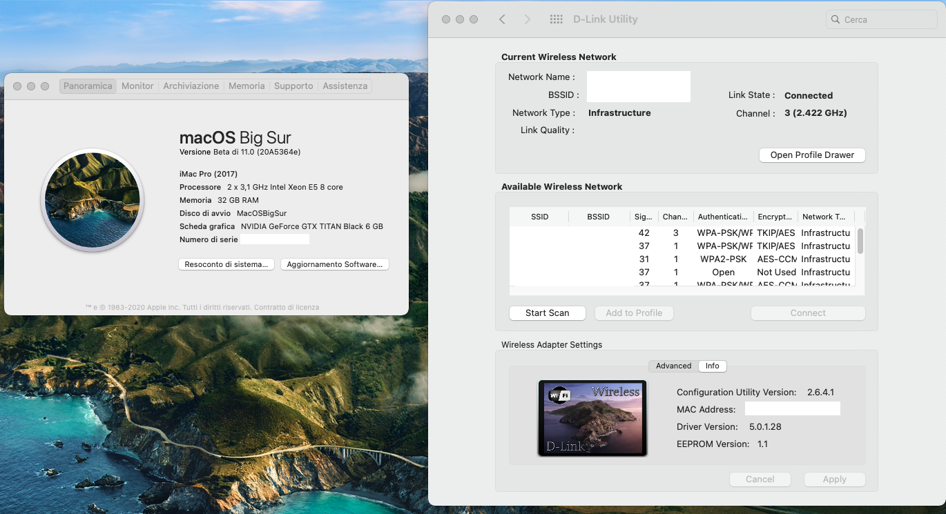

The only way I found with my mediatek RT2870 is to:
1- break the seal (disable csrutil and authenticated root)
2- delete existing snapshot(s) and tag an empty one to be able to boot
3- inject the kext with opencore (not needed if you are able to load the kext from /S/L/E..I don't know why but from beta 6 I'm not anymore able to load from that path at boot..)
4- mount / in read/write (-uw)
5- copy manually kext in /S/L/E, utility in /S/L/StartupItems, prefpane in /S/L/PreferencePanes and assign proper permissions
6- kextload the kext in /S/L/E so to be able to give permissions to Mediadtek in system pref pane / security and privacy / general

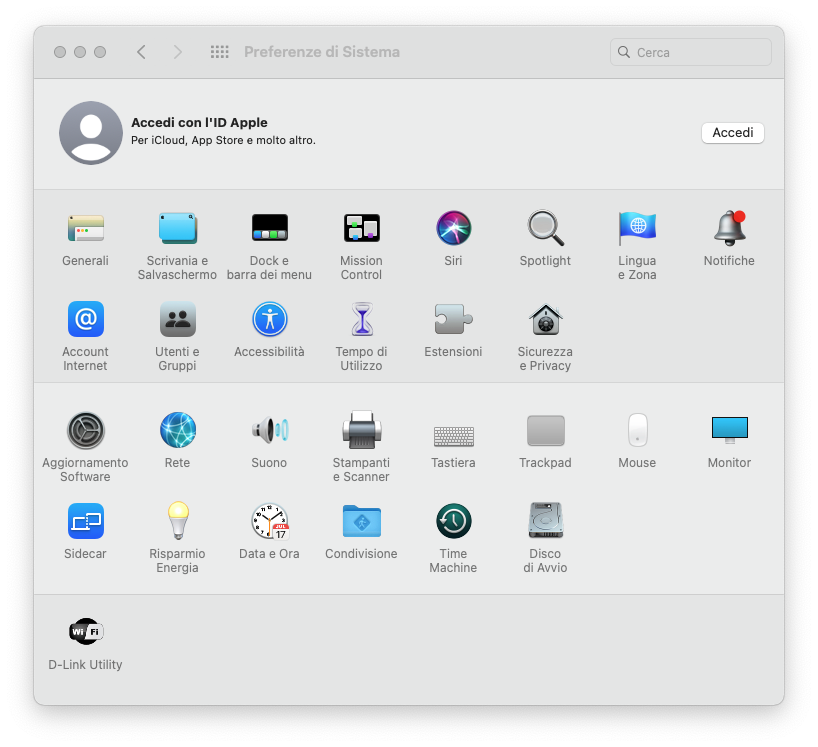

NB: copying the kext in /S/L/E is needed otherwise the D-link pane will force exit
NB2: D-link pane is hidden if you start system pref pane, but it is accessible from the top bar menu, once started it will be visible also in system pref pane
Spoiler
Files/Settings:
D-link pref pane in big sur beta 6
How to start D-link pref pane
D-link pref pane visible after starting from top bar
D-link pref pane not visible when starting system pref pane

1 hour ago, adamantinum said:
how can I extract from the Installer the needed kext and panes?
Use pkgutil --expand-full:
pkgutil --expand-full /path/to/pkg/to/expand.pkg /path/to/destination/of/extracted/files/Expanded
Note: do not create before folder "Expanded"
Then navigate to /path/to/destination/of/extracted/files/Expanded/ and you will find packageroot.pkg (this is for WIFI-Dlink Catalina-Panel-V2.pkg.zip available here).
Right click on packageroot.pkg and click show contents:
kext is in Payload/WirelessUtility/Driver/Catalina/
pref pane is in Payload/WirelessUtility/Other
wireless utility is in Payload/WirelessUtility/UI
  • Thanks 1

THIS IS NO MORE VALID
Ok, so ladies and gentlement, my daily updates about the RT2870 device and bug sur (I will name it bug on purpose :D).
Goal: have a working device with prefpane with all the files installed in the non /System folder.
Unluckily the goal is not reached, no luck in patching the wifi prefpane..but..I found a quite good way to have all working.
The following applies to current master version of opencore and it's working with bug sur beta 9.
I have iMacPro1,1 SMBIOS data.
We would want a sealed system, we don't want to delete snapshots, we would want SIP enabled and authenticated-root enabled: however this is not possible at the moment, because the utility needs some files copied to the /System directory.
What we will achieve by the following is a sealed system with SIP and authenticated-root enabled with a working device with a not working prefpane and a system not booting from the snapshot, but without breaking the seal; so, we can use the sealed system everyday or a system not booting from the snapshot, and in this last case, we will be able to switch to the sealed system in ?less than 5 minutes? instead of reinstalling MacOS to seal the system again.
As I wrote in the above post:
1- mount opencore EFI partition, copy RT2870USBWirelessDriver.kext in the EFI/OC/Kexts folder, modify config.plist to inject the kext on boot
2- copy D-LinkUtility to applications folder (not the pref pane, not the kext, only the utility)
3- go to ~/Library/Preferences (this is ok, since it's a folder under the control of the user); you need to create 2 files:
a) ActiveProfileSetting.plist
b) AdvancedProfileSetting.plist
4- Go to System preferences, users and groups and add applications/D-LinkUtility/MiniTaskUSB-DLinkUtility to automatically startup the utility
5- Verify that in the opencore config.plist SecureBootModel is set to "Disabled"
If you boot your system you will see that it will boot from the snapshot, SIP and authenticated-root can be enabled and the wifi will work, but not the prefpane.
If you want the prefpane:
6- Verify that in the opencore config.plist SecureBootModel is set to "Default" (by changing this the os will not boot from the snapshot!)
7- boot into recovery and disable SIP (csrutil disable) and reboot
8- mount / in read and write (sudo mount -uw /)
9- terminal: copy D-LinkWirelessUtility.prefPane in /System/Library/PreferencePanes/
10- terminal: copy RT2870USBWirelessDriver.kext in /System/Library/Extensions/
11- Assign proper permissions to D-LinkWirelessUtility.prefPane and RT2870USBWirelessDriver.kext (sudo chmod -R 755 and sudo chown -R root:wheel)
12- End: working wifi and working wifi preference pane
Now, let's suppose there's an apple update, to update apple wants a sealed system and booting from snapshot (probably also SIP enabled?)
All you have to do is to delete D-LinkWirelessUtility.prefPane and RT2870USBWirelessDriver.kext (not sure if it's a must, anyway delete them since we don't want a not bootable os), mount opencore efi and set back SecureBootModel to "Disabled"; if SIP must be enable for the os update boot into recovery, enable SIP and reboot; since you are now booting from a snapshot you will be able to update the os through the preference pane, you will have a working wifi, but without the pref pane; if you want to have the pref pane back just change SecureBootModel to Default.
Booting back from / (no snapshot, SecureBootModel=Default) and you will have again the working wifi prefpane (obviously after an os update you will have to copy again D-LinkWirelessUtility.prefPane and RT2870USBWirelessDriver.kext)
Edited by ghost8282
