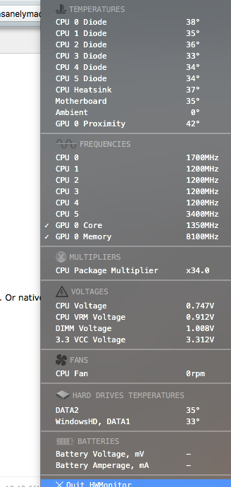

7) open up HWMonitorSMC.app and got this:
As u can see, it seems, that i have wrong settings for some of the values, like "Ambient = 0º" and of cause no Temps for my 2 PCIe Samsung NVMe SSDs (950 Pro and 960 EVO).
So i switched back to the ino.plist of W836x.kext and looked, i f i could change some values. But i really have NO intention, what these values means, neither where to get the correct names for it.
Also some of the "VINx" entries have given values via "dictionary setup and i don't know why or what for these values are good for.
I spend a lot of time with finding well documented Introduction to HWSensors 3 or either Kozleks HWSensor: but NOTHING
So i descided to make this post here and hope, that someone is willing to give some detailed information. But first i would like to introduce some information about Super Carriers HWSensor capability under WIN10.

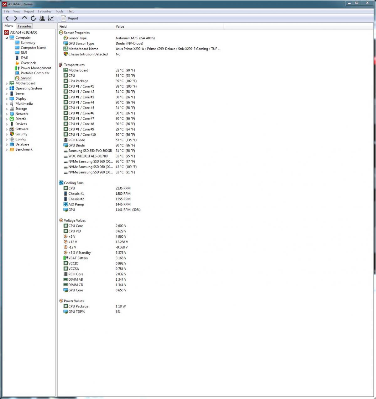

So, this is what i get, when booting under WINDOWS10 and use SIV64 (SystemInformationViewer) and read out all the sensor information with it:
As you can see here, the mainboard contains NUVOTON chip for LPCB. DonT hesitate about the much fans and temp sensors: they come from the us of CORSAIR Commander mini and Commander pro - and i know, that it will be impossible to read their sensor information under macOS.
And i have even more information from AIDIA64, like this one:
And with the help of AIDA64 i was able to make this output as a logfile:

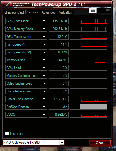

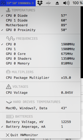

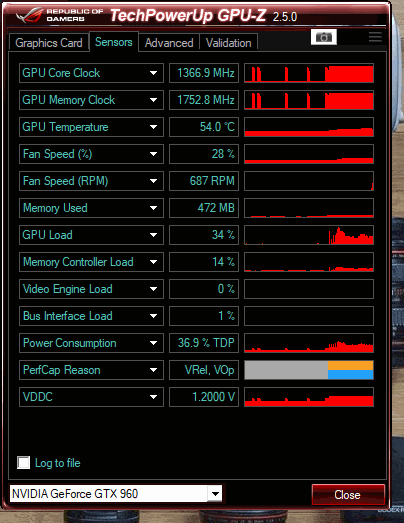

GeforceSensors is wrong.
For my Nvidia Fermi card family GF108 code NVC1 it shows frequencies 3x of real.
I can divide then by 3 but it will be wrong for other users. Any thought?
I corrected GeforceSensor for my card.
Take this driver and compare readings with Windows GPU-Z application. Or native control panel.
Use debug version if you see a discrepancy.

One last question, here is my AIDA64 sensors - which kext is for this, seems like texas instruments

Also in post 404, I put a screen shot of AIDA64 sensor, which kext does this chipset belong to ?
