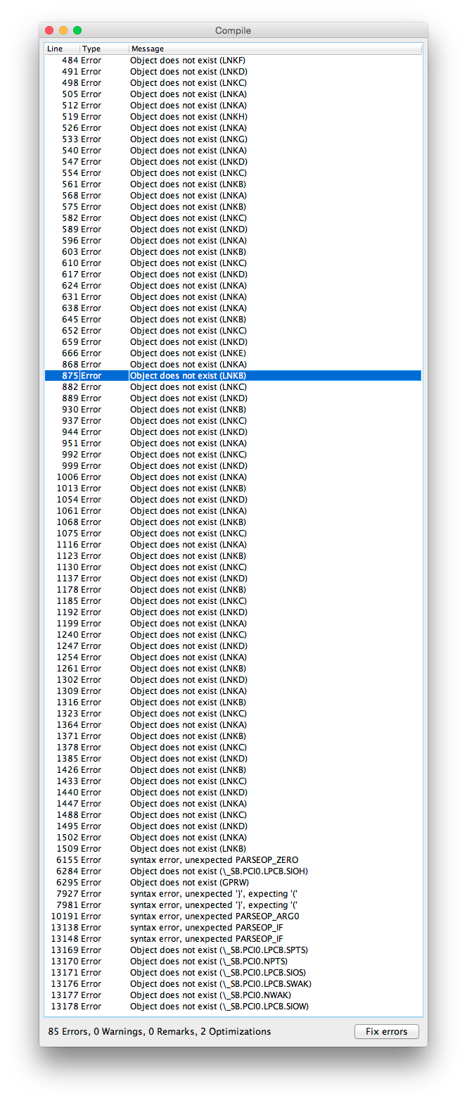

I'm trying to get my DSDT extracted but I can't seem to get it to be error-free.
So far I've tried MaciASL (never liked it, buggy interface), DSDT Editor (best one I know, but DSDT extraction is broken atm) and iASL (OS X acpidump is broken; needed Linux live disk for proper extraction). Every method seems to extract a different version of the same DSDT, for some reason, but all of them have the same 85 errors from the get go.

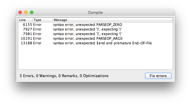

So far I've been able to auto-patch 80 of those using DSDT Editor. The few that remain are PARSEOP_ZERO pointing to ~30 lines of "Zero," PARSEOP_ARG0, Unexpected { which is completely weird because the syntax is correct from what I can tell, and unexpected $end.
I've also tried Pjalm's fix for my board but that truncates the DSDT in half and results in mismatched brackets.

*I used RampageDev's example of a fixed DSDT found here http://www.insanelymac.com/forum/topic/294513-haswell-i5-nuc-compile-errors/ and got it to compile without errors!
When the code specifies
If (xxxxxx)
    PS0X or PS3X
just change PS0X/PS3X to Store (Zero, PS0X/PS3X).
In the case of a PARSEOP_ZERO or PARSEOP_ARG0 error, just delete that section of zeroes or the problem-causing arg0.
Once all the other errors are resolved, the premature file termination error seemed to resolve itself.
