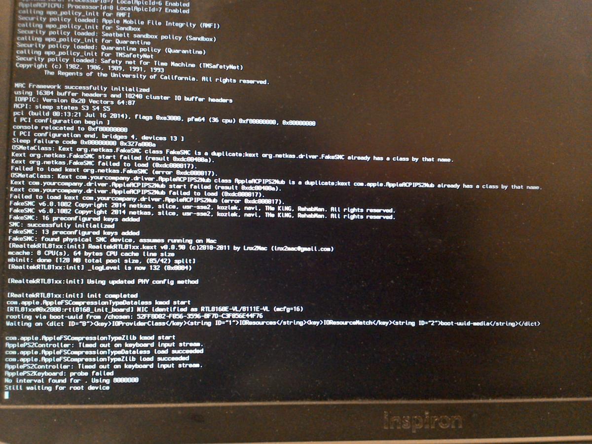

sorry, I should have mentioned that I use chameleon.  BTW, what version of chameleon would you recommend for this install?  A link or keyword to a working guide would also be much appreciated since I would also be attempting this on a Dell, which I notice happens to be the make of your yosemite hackintosh and historically, I've had more success working within the same make with hackintoshes.  Thank you!
the installation is the same as the other dps. you can follow any of the guides. i use the latest chameleon 2391 with the kernel in the root renamed as mach_kernel.
to spare you and others work, here is the kernel:
ps. if i cannot post it, just edit it please. it is already renamed to put on the root and be used with the latest chameleon.
mach_kernel.zip
Sorry.  I phrased that poorly.  I meant that I should reference the root in my org.chameleon.boot.plist as /mach_kernel in place of the one made by chameleon build 2390, which points to /s/l/e/kernel.  I initially built the pen drive using the installer and then I installed build 2391 over the existing version of chameleon.  I also installed it without any customization.  unfortunately, it's currently stuck on this message.
With every hackintosh, it always feels like I'm starting afresh with no experience. Buh.
i had the same problem, and i solve by changing the usb port at that point. when you get stuck, try to change from an usb 3.0 to an usb 2.0 or something like that. it keeps and works.
find the combination.
