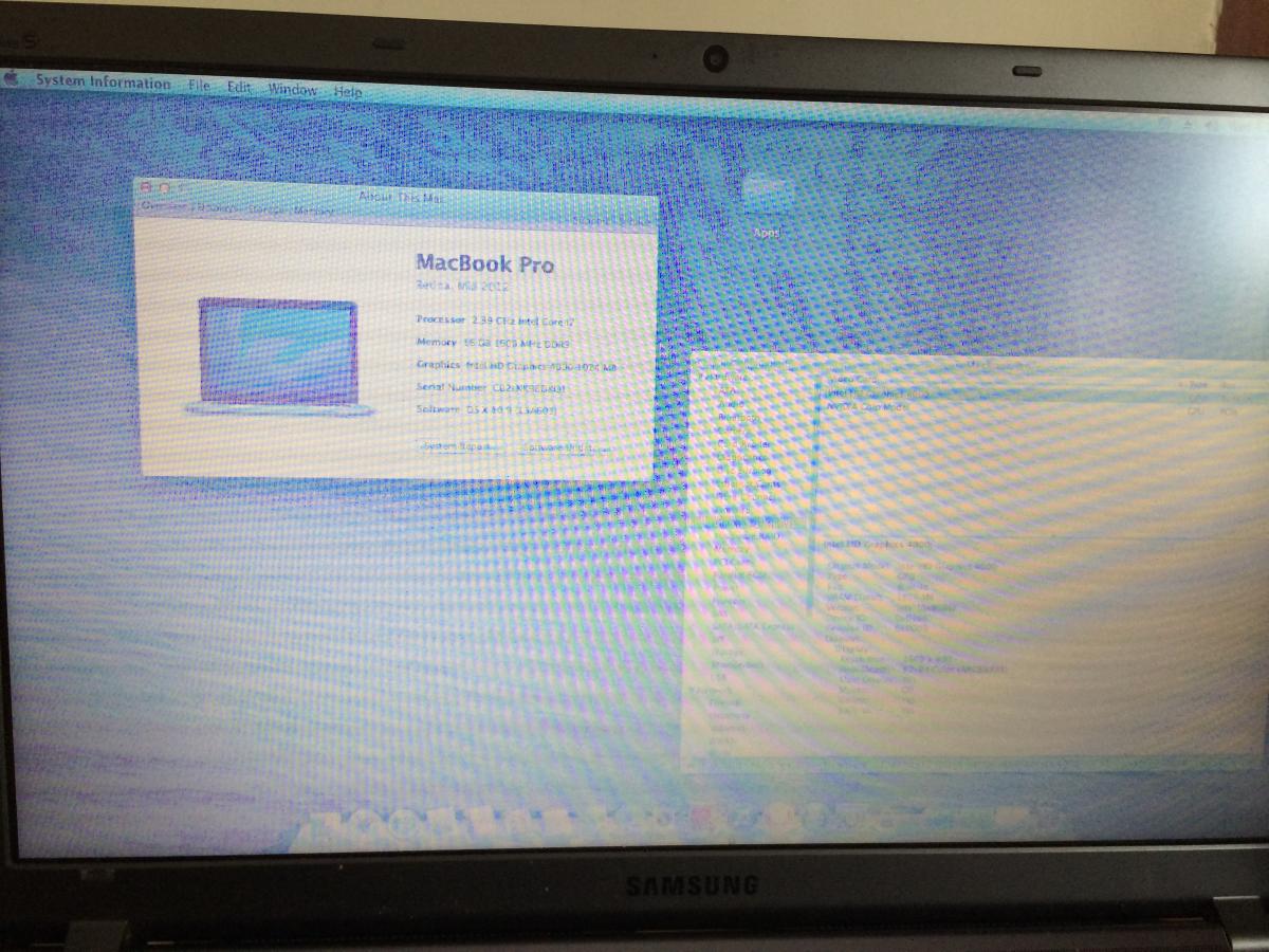

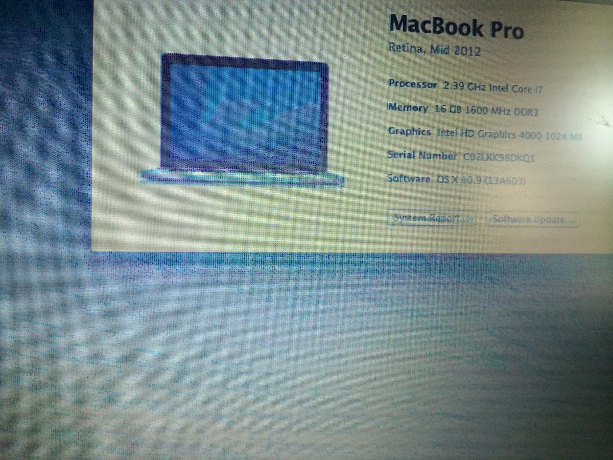

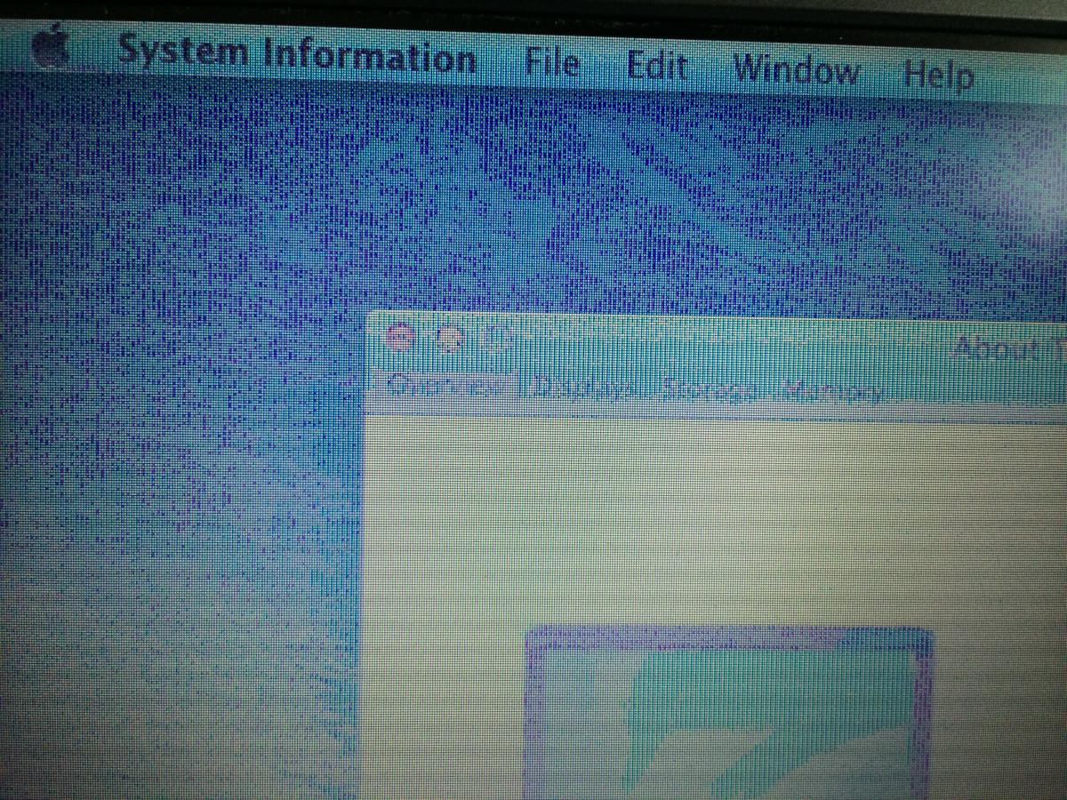

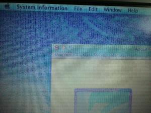

llsiddhantll Posted July 23, 2014 Share Posted July 23, 2014 Hey guys! I've run into this strange problem with my hackintosh. Everything is working, audio, sleep, etc, even graphics, with QE/CI, but the screen looks strange. On my laptop display, the colors are messed up, there is this bluish haze on top of everything, and I see small pinkish green dots in a lot of places. I've looked online a lot, but it seems no one else has this problem. I've attached a couple of pictures for you guys. Also, this does not occur on an external HDMI monitor. In my case, my TV. I made the USB installer manually, by mounting BaseSystem.dmg etc. Also, during the install, everything looked good, no distortions of any sort, even though I used the exact same boot flags during install and during boot. I used -v -f IGPEnabler=Yes IntelFBCapri=4 EnableDualLink=Yes I have Dual Link enabled using Chameleon, and I use an kg-platform-id of 01660004, otherwise the dual link patch does not get applied. Also, needless to say, I use Intel HD 4000 Graphics. I also followed this tutorial to no avail: http://www.insanelymac.com/forum/topic/208410-fixing-scrambledstretched-or-wrong-resolution-laptop-display-problems/ Any help is appreciated! Link to comment Share on other sites More sharing options...
Pimentel Posted July 23, 2014 Share Posted July 23, 2014 Hello I'll teach something to you that work right in HD 3000 and maybe work to HD 4000, i believe that you have a problem realted with your chipset, but what i'll teach you now is just a trick and i don't know if it'll work fine... Use at your own risk: Try edit kexts AppleIntelSNBGraphicsFB und AppleIntelFramebufferCapri...... inside de kext open AppleIntelMEIDriver and inside this file edit key IOPCIPrimaryMatch... For AppleIntelSNBGraphicsFB.kext add this info -------------------> 0x1C3A8086 For AppleIntelFramebufferCapri.kext add this info -----------------> 0x1E3A8086 Please make this texts... backup original kexts without modified and after modified them... Link to comment Share on other sites More sharing options...

Allan Posted July 23, 2014 Share Posted July 23, 2014 AppleIntelSNBGraphicsFB is for HD 3000, forget it. Send me your AppleIntelFramebufferCapri. What is the resolution of your monitor? Link to comment Share on other sites More sharing options...

Allan Posted July 23, 2014 Share Posted July 23, 2014 In your case it is necessary to change the values of the kext AppleIntelFramebufferCapri Read here to learn how to edit the values [Guia] Habilitar audio HDMI - Intel HD 4000 (Use Google Tradutor) And use this: @0, 05 03 00 00 02 00 00 00 30 00 00 00// (LVDS) @1, 02 05 00 00 00 04 00 00 07 04 00 00 // (DisplayPort) @2, 03 04 00 00 00 04 00 00 81 00 00 00 // (DisplayPort) @3, 04 06 00 00 00 04 00 00 81 00 00 00 // (DisplayPort) save and reboot Link to comment Share on other sites More sharing options...

Allan Posted July 23, 2014 Share Posted July 23, 2014 before changing your kext, use this flag -f -v GraphicsEnabler=Yes IntelCapriFB=4 Link to comment Share on other sites More sharing options...
