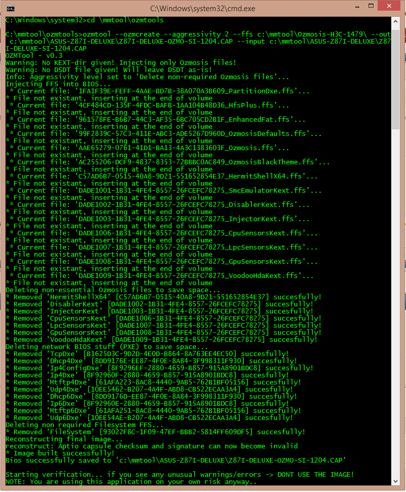

I've been having trouble getting my BIOS patched with Ozmosis.  I have an ASUS Z87I-DELUXE motherboard.  Every time I run the program, I get this message:
Treys-iMac:OZMTool_v0 Trey$ ./OZMTool --ozmcreate --aggressivity 1 -f ./ffs --dsdt DSDT.aml --out Z87ID-OZM.CAP --input Z87ID-1104-ORIG.CAP
OZMTool - v0.3
Warning: No KEXT-dir given! Injecting only Ozmosis files!
Info: Aggressivity level set to 'Delete network stuff from BIOS'...

Reconstructing final image...
reconstruct: Aptio capsule checksum and signature can now become invalid
reconstructVolume: 8C8CE578-8A3D-4F1C-9935-896185C32DD3: root volume can't be grown
ERROR: Image exploded...
! Program exited with errors !
Status code: 17
I'm not sure what to do next to solve my problem. Any ideas?

You need more room to put ozmosis stuff, try to use aggressivity switch
Dont use pure bios, it's CAP file it means it's' signed and any operation invalid the signing, if you try to flash with utility inside bios, fail because the signature is invalid due to manipulation.
Z87I-DELUXE-SI-Ozmo-1204.zip
This is your bios with minimal required ozmosis stuff, it's' missing DSDT because i cant edit

Thank you Aigors.  The way I've flashed Oz BIOS before was using the EZFlash button on the back of my mobo with the CAP file on my USB.  It seems to skip the signing/verification problems..
T
How would I flash the BIN file you gave me?  If I were to do it again, how would I get the BIN from the CAP file to patch with Ozmtool?
T
My fault, this is cap file with minimum ozmosis requirements
Z87I-DELUXE-OZMO-SI-1204-CAP.zip
