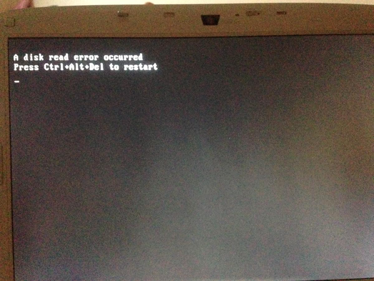

dsTny Posted July 19, 2014 Share Posted July 19, 2014 Hey guys, last problem to solve for me: I want to boot Yosemite or OS X with Clover. Both OS are on the same hard disk which is formatted as GUID. Yosemite is OS X Extended (partition 2) and Windows NTFS (partition 3). Partition 1 is EFI. I tried several things without solving this problem. The NTFS.efi (?) is inside the driver64 folder. Yosemite starts fine but if I want to start windows, after a short time the message "a disk read error occurred" appears. So can somebody help me, please? What I have to do to solve this? Thank you Link to comment Share on other sites More sharing options...

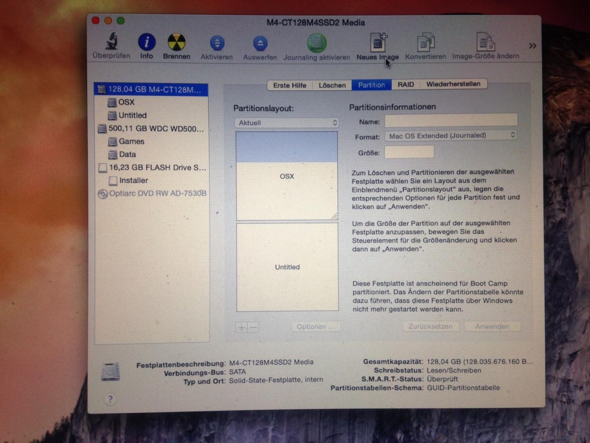

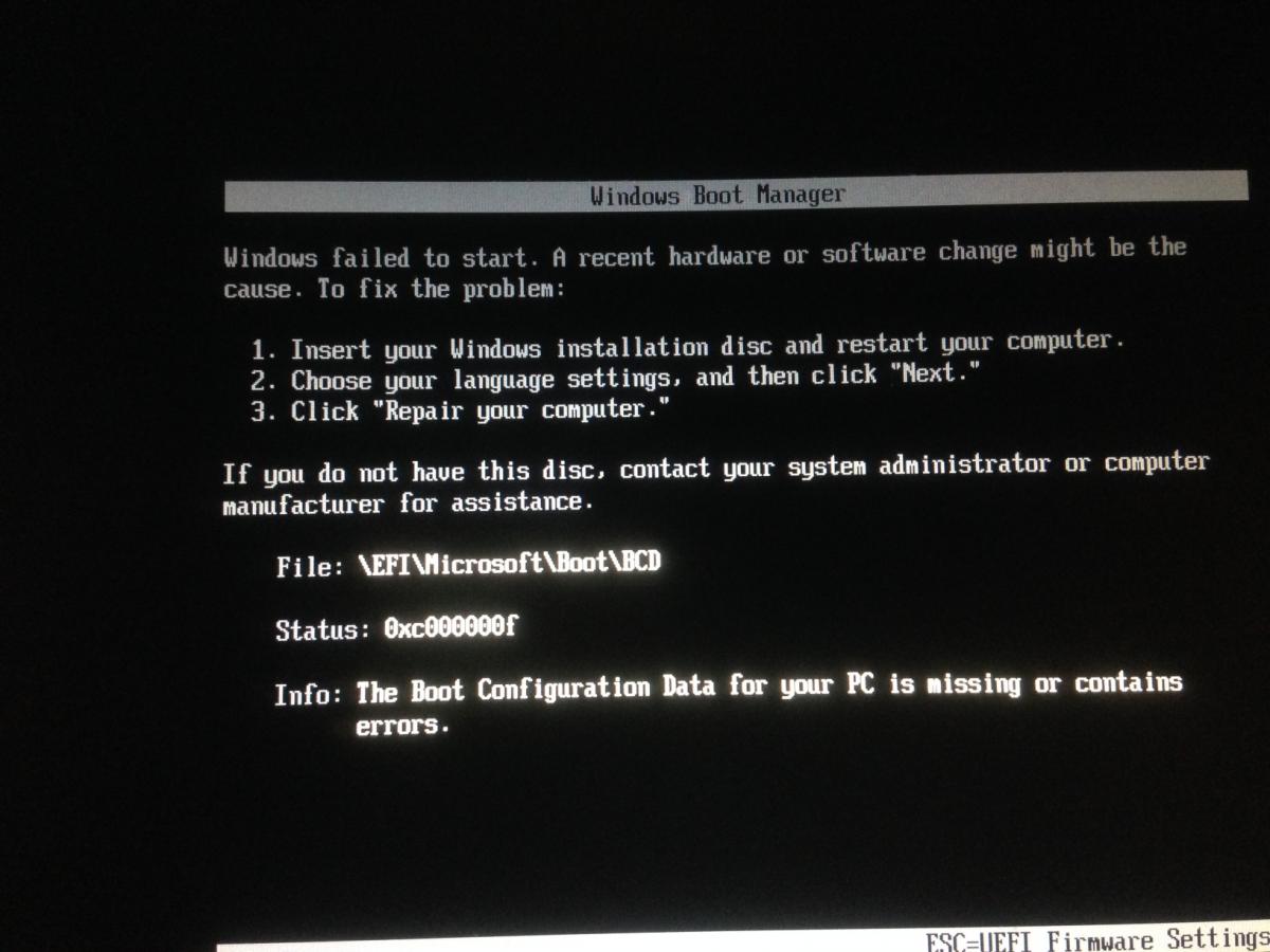

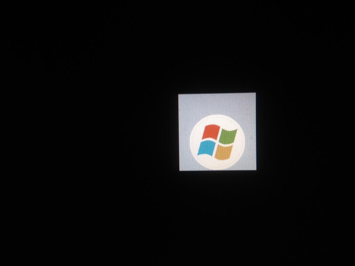

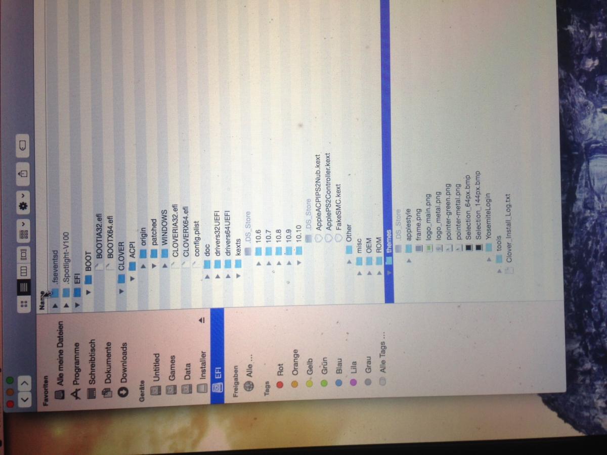

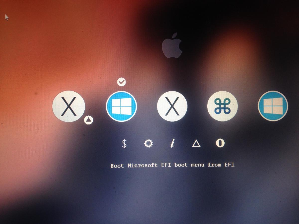

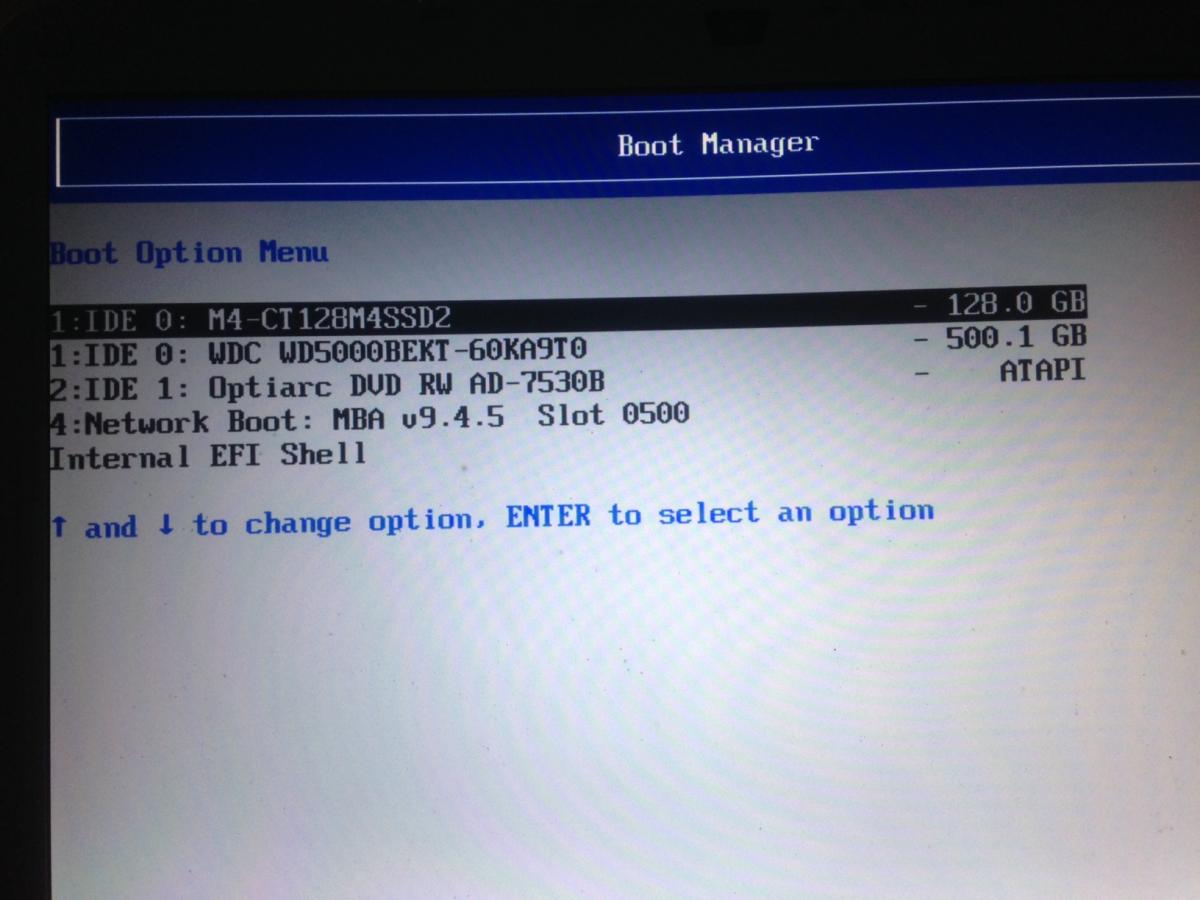

dsTny Posted July 21, 2014 Author Share Posted July 21, 2014 I followed this guide:http://www.niresh.co/osx86.html/hackintosh/articles/how-to-dual-boot-osx-windows-8-with-clove-r39/edit: Sorry that I have to disturb you again, but I don't get it I tried several guides but Windows 8.1 does not want to start.This is my current configuration, GUID, OS X has Mac OS Extended Journaled, Untitled (Windows 8.1) has NTFS, both OS on my SSD. EFI partition is active set by Windows 8.1This is my folder structure in the EFI partition of my SSDIf I start My system, I can choose following devices to startI'll take SSD (M4) and has following options to start.If I choose the one option of the picture above, I get this errorIf I choose following option, After some time with following icon I get this error.Please I need your help, I despair Link to comment Share on other sites More sharing options...

fusion71au Posted July 25, 2014 Share Posted July 25, 2014 @dsTny, You need to repair your Windows 8 UEFI bootloader. Create a UEFI Windows 8 USB installer or Recovery Disk and use it to boot into a command prompt. Follow the directions in this post from @Alex to restore the UEFI Windows bootloader and rebuild the BCD store in the EFI System Partition using the bcdboot command: bcdboot c:\Windows /l en-gb /s b: /f ALL where c:\ is your Windows volume, b: is the letter assigned to your EFI System Partition. After the repair, reboot the computer normally to Clover on the the hard disk ----> choose "Boot Microsoft EFI Boot Menu from EFI" ---->then select bootmgfw.efi from the submenu to boot (hopefully) into your newly repaired Windows 8. Good Luck! PS: That Niresh Guide is misleading and in fact gives instructions for dual booting OSX and Windows in legacy (hybrid/MBR) mode. If it has a "hybrid" MBR, use GDisk to write a new "protective" MBR on your SSD ---> ensures the disk is pure GPT and can install UEFI Windows for best compatibility with Clover. Download GDisk, Man page for GDisk. @pokenguyen's AIO guide Link to comment Share on other sites More sharing options...
