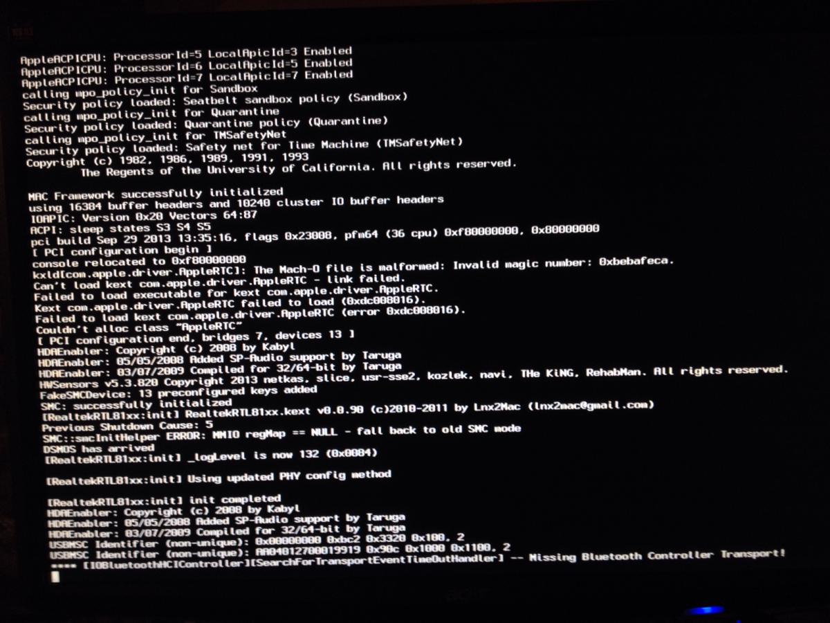

wreckthisplace Posted July 15, 2014 Share Posted July 15, 2014 Hey, I made a CCC clone of one OS on one hackintosh and put it onto a formatted partition on another hackintosh. I didn't expect it to be that easy though since both hackintoshs do not share the same hardware. I then installed the bootloader and the appropriate DSDT for my motherboard.This is what I'm getting at boot. I'm sure I'm very obviously missing something crucial. The hackintosh I cloned:Motherboard: MSI Z77 Thunderbolt atx Motherboard w/ usb 3.0 and Sata IIIIntel i7 3770k 4-Core (8-core) 3.5GHz CPU LGA1155 Socket (Newest Generation CPU) NVIDIA GeForce GT 640 2047MBThe hackintosh I want to put the clone onto:Gigabyte GA-P67A-UD3P-B3Intel Core i7-2600KASUS EAH6850Any help would be much appreciated.Thanks. Link to comment Share on other sites More sharing options...

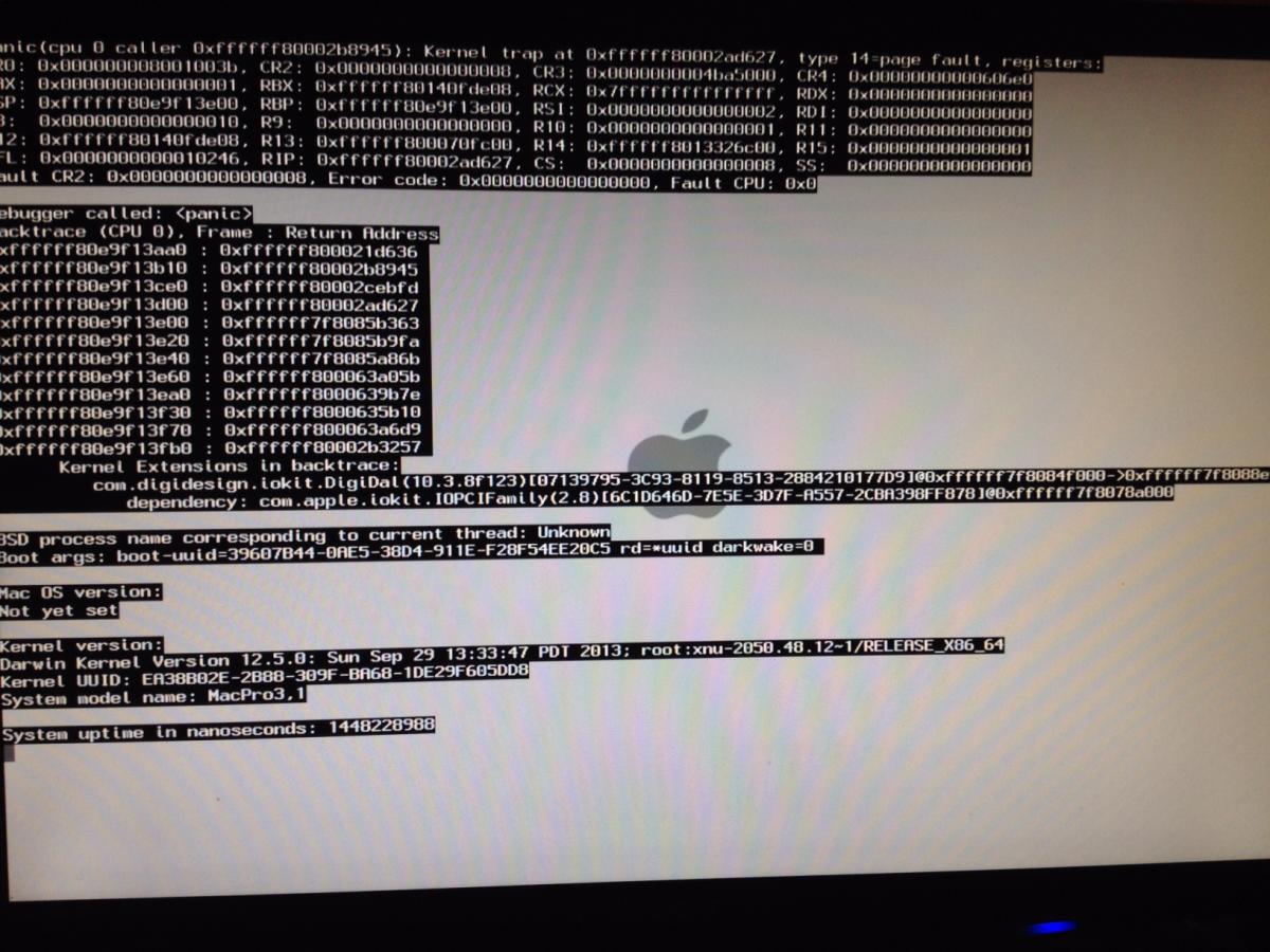

MacUser2525 Posted July 15, 2014 Share Posted July 15, 2014 The first picture showing it dying at Bluetooth indicates a graphic problem as that is what loads next second seems to be pro tools related if Google is any indication on it. You should make sure that you are correctly injecting your changed to ATI from nvidia card in the new machine and uninstall the pro tools. Boot the new drive in old machine make the changes shutdown and transfer to new machine probably the best way to do this. https://www.google.ca/search?q=com.digidesign.iokit.DigiDal+kernel+panic&btnG=Search&oe=utf-8&rls=org.mozilla%3Aen-US%3Aofficial&client=firefox-a&channel=sb&gfe_rd=cr&gbv=1 Link to comment Share on other sites More sharing options...

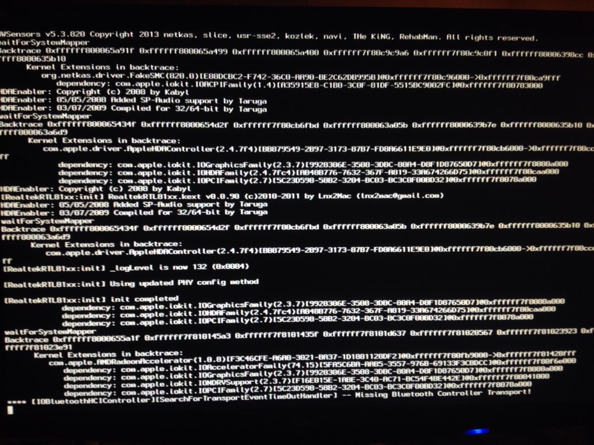

wreckthisplace Posted July 16, 2014 Author Share Posted July 16, 2014 Hey there, Thanks for the reply. I tried booting with both -v -f GraphicsEnabler=Yes and -v -f GraphicsEnabler=No and both came back with what looks like a lot of kext issues? I should also say again that I do have access to the cloned system drive as I can boot from another OS system in the same computer I'm trying to put the cloned one in. So I could essentially make any changed to the kexts, plists etc... I hope that helps. Thanks. Link to comment Share on other sites More sharing options...
