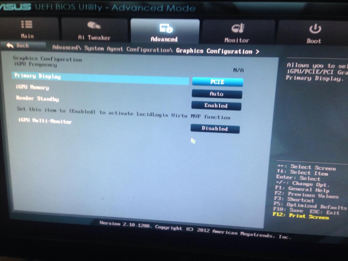

I used both settings iGPU and PCI in BIOS . iGPU with 64 MB . Every time it stuck there .

If he wants to use HD4000 and the nvidia card, the HD4000 must be set as primary display device in the BIOS.
I am using Intel HD 4000 which is enabled as igpu 64 MB in BIOS
SkipNvidiaGfx=Yes does not work either.
Still stuck after Missing Bluetooth Controller which I am sure after that Graphics is next. Althought booting in safe mode mode is working fine for me .
Yes, the BIOS settings are the same on my board (P8Z77-V Pro, same CPU as you).
Disable render standby as well, it's not needed since you won't be using the HD4000.
If it still doesn't work then the problem is not BIOS settings, because then you'll have the same settings as I do.
