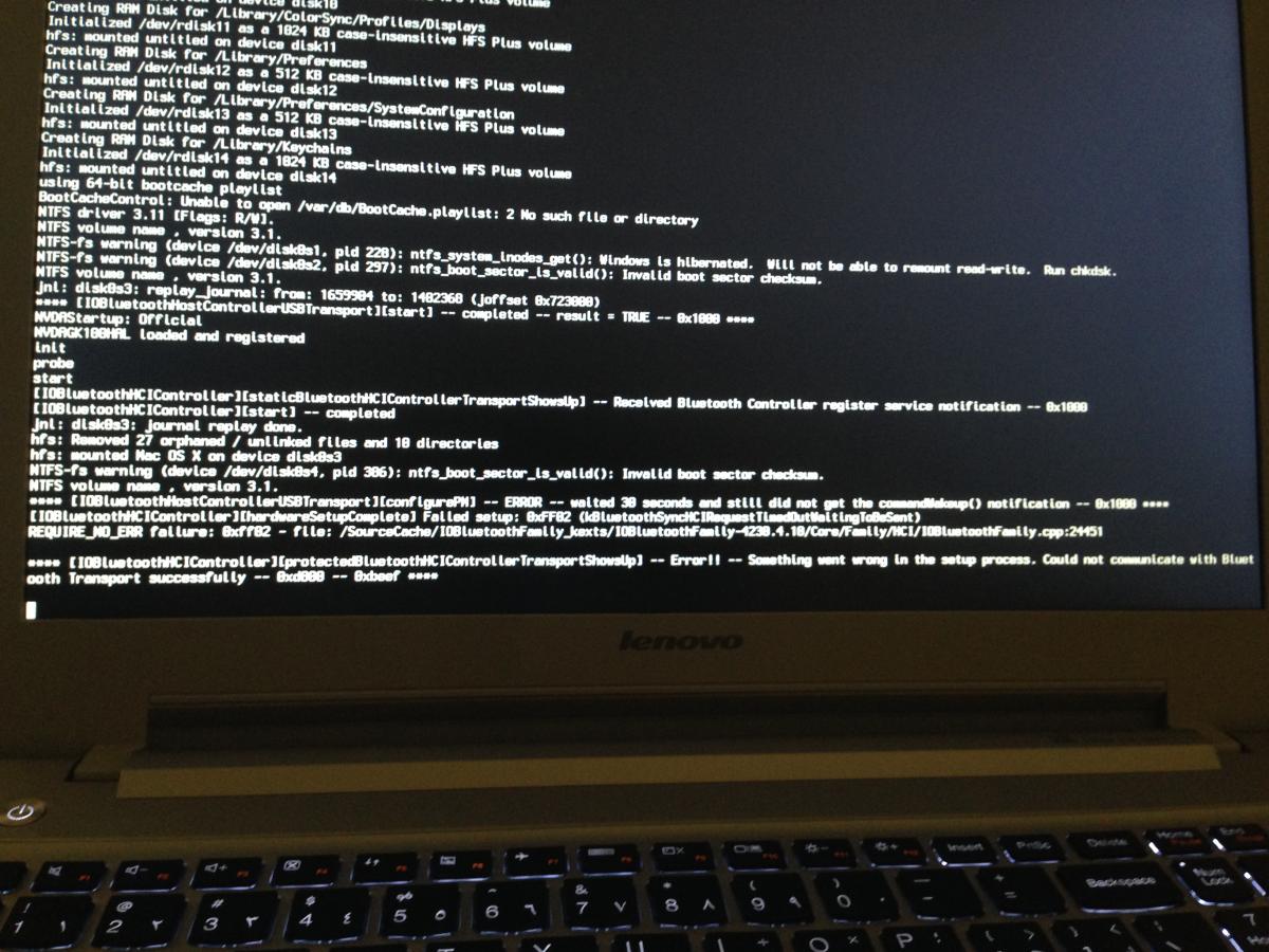

The problem was DromOEM option I switched it to false it passed, but now it seems I have a graphical problem, it stucks at that blutooth error -_-
No idea without photo...
That's what am getting :/ (injecting either EDID or Intel will cause early reboot)
You need to inject Intel to get ig-platform-id to have any effect.
And your nvidia drivers are loading and interfering. Remove them (NVDA*, Geforce*), or use FakeID to disable the nvidia device, or disable nvidia from BIOS.

I can't delete them because i used this way to copy mavericks on the usb http://cloverboot.weebly.com/copy-mavericks-to-usb.html (the second way is just stucking on bootcache even if the dropoem is set to false)
how to use the FakeID ? or what should I set it to ?

Look at NVDAStartup.kext/Contents/Info.plist. You'll see that IOPCIMatch is set to match on any nvidia gfx device: 0x000010de&0x0000ffff
FakeID documentation:
http://clover-wiki.zetam.org/Configuration/Devices#FakeID
So what you want to do is Inject/Nvidia=true, set FakeID/Nvidia=0x00018086. eg. setting it to a bogus Intel device should keep NVDAStartup.kext from loading. Hopefully, it doesn't match on class (IOPCIClassMatch) as there is no way to inject a fake class.
There is also a feature in Clover that allows you to block a kext: http://www.projectosx.com/forum/index.php?showtopic=2656&view=findpost&p=40305. In theory you could block NVDAStartup.kext with that feature.
If that doesn't work, then you should create your USB the other way (restore BaseSystem.dmg, remove Packages link, replace with Packages folder, etc.) that way you can remove the kext from SLE. I think this is what you mean by "second way" above... If you hang while using such a USB it just means you didn't create it correctly.

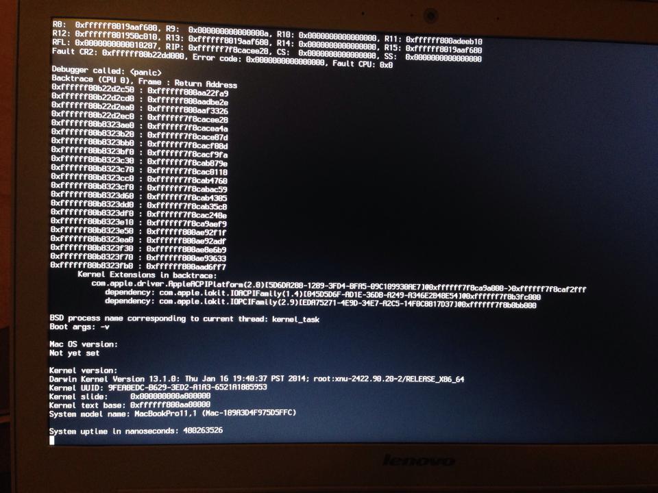

It seems like now i knew how to load the patched files because I am unable to boot XD boot in nano seconds: 7272819
I moved the ssdt-4 from windows it booted then what's wrong ?
Post a pic of the KP if you're getting a panic. Make sure you saved the files in the correct format (Format: ACPI Machine Language Binary). OS X doesn't like AML files that are actually text.
they are saved as ACPI Machine Language Binary(.aml)

Post a ZIP of the actual files you have there. Hard to tell from the photo of the KP because you cut off the top of the screen. When you take a pic of a KP, you need to capture the entire screen as the whole screen contains important information.

You didn't disassemble correctly. Use 'iasl -da *' to disassemble with all SSDT/DSDT, then edit exclusively the resulting DSL. Save to AML when you have your patches complete and place them in ACPI/patched. Never open an AML directly... always the DSL.
man still the same -_- it seems not going to work ever :/ I dissassembled them in linux once and osx once the same result
