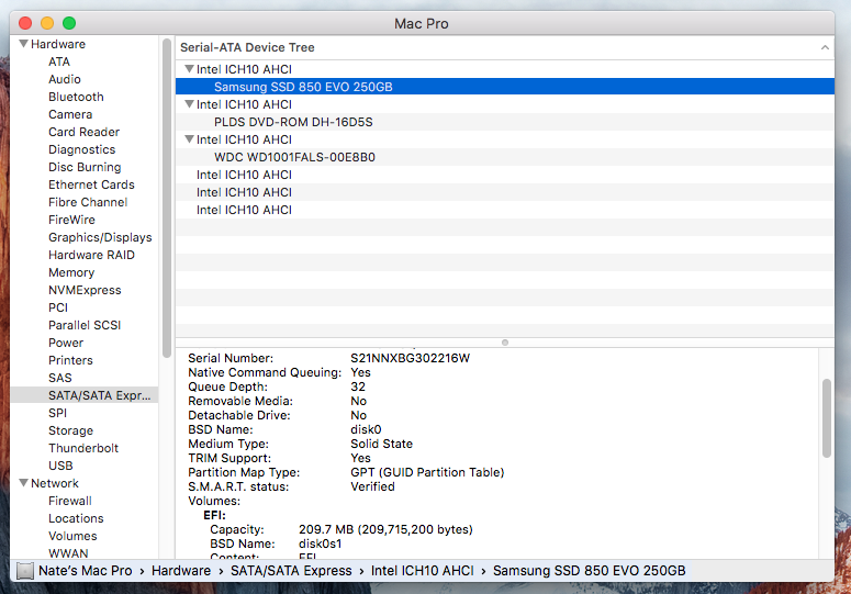

Hi there!
I just successfully installed Yosemite on a brand new Crucial MX100 256GB SSD I bought for the occasion.
I tried to enable TRIM using this method. In fact the KextPatch was already there, in Clover v2.3k r3185's default config.plist, I just had to uncomment the array.
Here's what my config.plist looks like at that point:

But I don't see TRIM showing up in System informations after reboot. What's wrong?
Use mine and all will works.

Hi, just a curiosity, I have on my plist the bellow Clover Trim patch, which seems different than the one posted here....but I'm not sure if that should be considered a problem or not. I got trim working, but....does it works with different patches?
<key>Comment</key>
<string>TRIM Enabler</string>
<key>Find</key>
<data>
AEFQUExFIFNTRAA=
</data>
<key>Name</key>
<string>IOAHCIBlockStorage</string>
<key>Replace</key>
<data>
AAAAAAAAAAAAAAA=
</data>
#127

It seems Trim Enabler remains persistent so far, seems to working fine in 10.10.3 Clover Patch Method.
<key>Comment</key>
<key>Find</key>
<data>
AEFQUExFIFNTRAA=
</data>
<key>Name</key>
<key>Replace</key>
<data>
AAAAAAAAAAAAAAA=
</data>
Nope same patch as mine.  If you use Clover Configurator, what you will enter and see is Hex rather than Base64 exactly as you posted.  I checked my Clover Config and its exactly as yours is.   The config file will show Base64 because Clover converts it to Base64.

I upgraded to 10.10.3 last night along with updating Clover to the latest release and updating FakeSMC to the latest.  Something I did caused my TRIM clover patch to break.
I can't seem to figure it out.  I'm going to try rolling back Clover, but does anyone know why this is a problem?
EDIT: Solved the problem.  All I had to do was apply the Clover patch, and do a COMPLETE shutdown.  I was always doing a reboot, which apparently isn't enough...

Applied with the Clover Configurator - TRIM is enabled on my Crucial BX100
Anyone know if TRIM will continue to function as OS X Yosemite receives updates using this Clover patching method?

So far, every Yosemite update reinstates the vanilla kext so, as long as the Clover patch is done on the fly you should be ok, otherwise you'll have to repatch after every update...

I have a Kingston KC100 120Gb and Trim Enabler worked for me!

Anyone suffered severe boot slowdowns after enabling TRIM? On my Dell Latitude E6440 (Intel Series 8 SATA-III controller) with 240Go Intel Series 330, I boot Mavericks and Yosemite in 7s to 8s without TRIM but boot time goes up to 45s to 50s when I binpatch IOAHCIBlockStorage binary and enable TRIM. For some unknown reason, I don't suffer the same at all on my older Latitude D630 with which I boot OS X in about 15s to 20s (ICH8M SATA-II controller).

Use 4th method and always work for you. I tested on many,many version of OS X!!!
