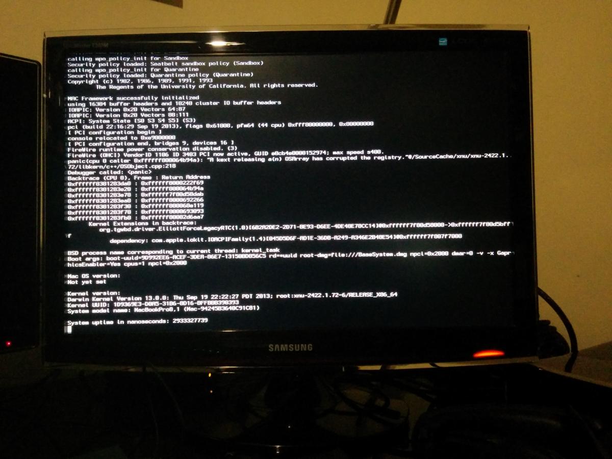

MrShinistro Posted June 1, 2014 Share Posted June 1, 2014 Hello Guys!I'm trying to setup my first Hackintosh, but can't even get to the installation page.. Here are my specs: MBO: INTEL DX79TO (VT-D Disabled, AHCI Enabled) CPU: I7 3930K GPU¹: GTX 680GPU²: GTX 460 2GBHDD¹: INTEL 120GB SSD (For Windows and MAC)HDD²: Barracuda 1TBRAM: 32G Hyper-XOk, when I tried installing, it came with this error:I tried -v -x GraphicsEnabler=Yes cpus=1 npcl=0x2000, everything! But nothing works If anyone can help me, thank you. Quote Link to comment Share on other sites More sharing options...
iFIRE Posted June 1, 2014 Share Posted June 1, 2014 delete the kext ElliotforceLegacyRTC.kext from Extra/Extensions, then -f -v -x npci=0x2000 1 Quote Link to comment Share on other sites More sharing options...
xpamamadeus Posted June 1, 2014 Share Posted June 1, 2014 GPU¹: GTX 680 GPU²: GTX 460 2GB gpu 1 require GraphicsEnabler=No gpu 2 GraphicsEnabler=Yes Its best to remove that gtx 480 from system for now. 1 Quote Link to comment Share on other sites More sharing options...
MrShinistro Posted June 1, 2014 Author Share Posted June 1, 2014 Thank you, but where do I delete? From the dmg? Cause I can't find where.. :/ I opened my DMG file, and couldn't find any file at Extra/Extensions.. There's only a 10.5 and 10.6 folder, but with nothing in it.. Also opened the System/Extensions, nothing... Quote Link to comment Share on other sites More sharing options...
