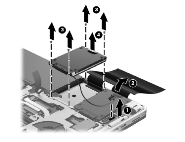

mnfesq Posted April 30, 2014 Share Posted April 30, 2014 I don't even remember seeing an empty slot, last time I opened that other side was back in '12 when I replaced my display assembly (a bug, yes literally, was stuck between the LCD panel and the screen. Weird). I'll have to check if I even have that slot since I got the 3D with 750gb single drive option. You know how HP is..... > I don't think you have a "single drive option." I think you have what I bought, which is a laptop with one hard drive installed and one empty drive bay with no hard drive caddy. (It does, however, have a SATA cable for the empty drive bay and a slot for an mSATA drive.) Here is a picture from the Service Manual for the HP Envy 17t-3200: The empty drive bay is the secondary drive and it cannot be made bootable because the HP BIOS does not allow it. The mSATA drive is shown in light gray in the middle at the bottom of the photo. You will see only the slot where it goes and not an actual installed chip. (BTW, when I received my mSATA drive, it did not come with an installation screw and I took one from the four screws that hold the hard drive caddy in place.) If you haven't seen the service manual for our laptop, here's the link: http://h10032.www1.hp.com/ctg/Manual/c03317166.pdf Link to comment Share on other sites More sharing options...
jamaly Posted April 30, 2014 Author Share Posted April 30, 2014 Just closed back the second side, I see now how I've always missed that mSSD slot now. HDD bays I know about, I use 2 different HDDs Link to comment Share on other sites More sharing options...
