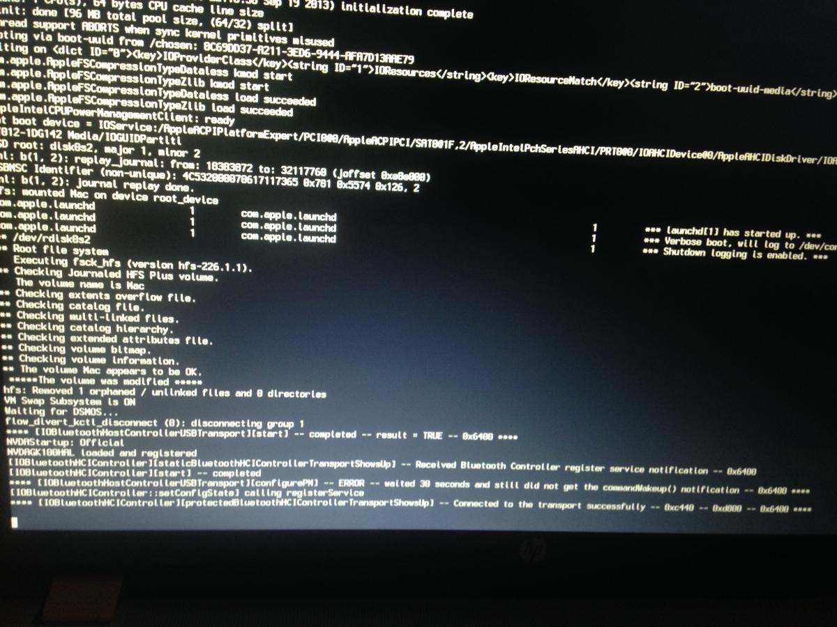

treyhamilton25 Posted April 10, 2014 Share Posted April 10, 2014 I have everything installed but I am stuck on the verbose screen after the Bluetooth thing. I attached a pic. The Args I've used range from just simple -f -v -x to throwing in PCIRootUID=1 cpus=1 and GraphicsEnabler=Yes/No. What is the trick to this? lol Link to comment Share on other sites More sharing options...

mnfesq Posted April 11, 2014 Share Posted April 11, 2014 Do you have FakeSMC.kext installed. It looks like it is stuck waiting for DSMOS. If it's not that, then it is likely your video kexts. You got past the ACPI kp that comes when there is no Lapic patch. You're pretty close to getting booted up. BTW - I have the HP Envy 17t-3200 CTO. Link to comment Share on other sites More sharing options...
treyhamilton25 Posted April 11, 2014 Author Share Posted April 11, 2014 npci=0x2000? replace mach_kernel? I tried those Do you have FakeSMC.kext installed. It looks like it is stuck waiting for DSMOS. If it's not that, then it is likely your video kexts. You got past the ACPI kp that comes when there is no Lapic patch. You're pretty close to getting booted up. BTW - I have the HP Envy 17t-3200 CTO. FakeSMC was installed in the Extra/Extensions folder. I tried to move the video kexts to a backup folder and got the same results. It was SO much easier to install it on my HP g7. I've been working on this laptop for the past 3-4 days trying different methods. I have the mach_kernal patched like it's supposed to be. Everywhere else I read says that when the last line is bluetooth it has to do with graphics. Maybe I need to move my intel graphics? Or ALL? Link to comment Share on other sites More sharing options...
iFIRE Posted April 11, 2014 Share Posted April 11, 2014 -f -x -v GraphicsEnabler=No cpus=1 and yes, remove all Graphics kexts from USBInstaller Link to comment Share on other sites More sharing options...
mnfesq Posted April 11, 2014 Share Posted April 11, 2014 Don't use Extra/Extentions. That is really an obsolete method. Everything needs to go into S/L/E. Put FakeSMC.kext in S/L/E and see if you don't get further in the boot process. Link to comment Share on other sites More sharing options...
