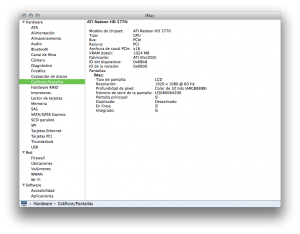

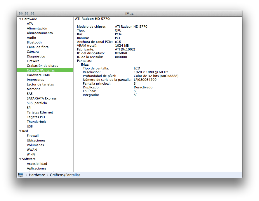

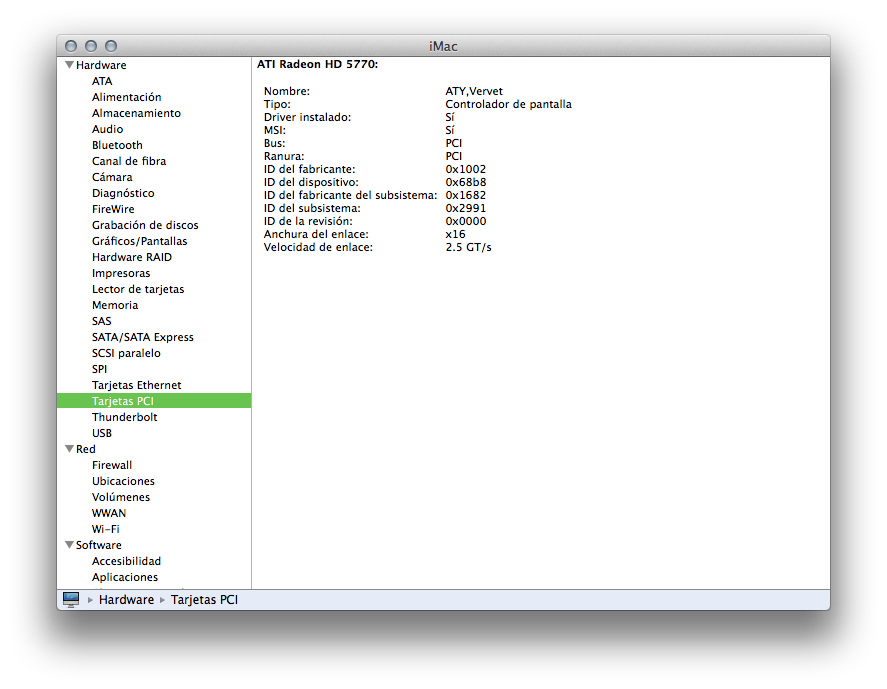

and this for HD5770 show like this: :P
           Device (GFX0)
                    Name (_ADR, Zero)
                    Name (_SUN, One)
                        Store (Package (0x0E)
                                "AAPL,slot-name",
                                Buffer (0x09)
                                    "PCIe-1"
                                "@0,name",
                                Buffer (0x0D)
                                    "ATY,Vervet"
                                "@1,name",
                                Buffer (0x0D)
                                    "ATY,Vervet"
                                "@2,name",
                                Buffer (0x0D)
                                    "ATY,Vervet"
                                "@3,name",
                                Buffer (0x0D)
                                    "ATY,Vervet"
                                "model",
                                Buffer (0x13)
                                    "ATI Radeon HD 5770"
                                "hda-gfx",
                                Buffer (0x0A)
                                    "onboard-1"
                            }, Local0)
                        Return (Local0)
                Device (HDAU)
                    Name (_ADR, One)
                        Store (Package (0x02)
                                "hda-gfx",
                                Buffer (0x0A)
                                    "onboard-1"
                            }, Local0)
                        Return (Local0)
