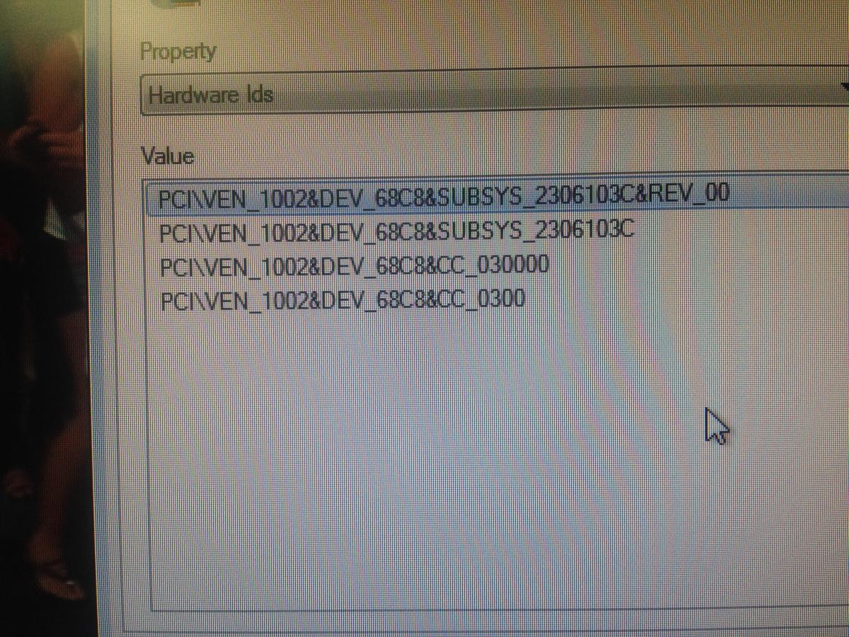

The vendor ID=68C8 (1002). I have a pic with the information, I just need you tell me which kext I will have to edit.

I think you have to add the device id in the following kexts (backup them before editing):
- AMDRadeonAccelerator.kext
- ATI5000Controller.kext
- ATISupport.kext
- ATIFramebuffer.kext
Do secondary click on the kext and select "Show Content". Open the info.plist with TextEdit (or any other editor) and look for device id "68D8" (this is HD5670). Replace it with your id (68C8).
Maybe you will have edit the driver itself. If so open the file inside the "macos"-folder with an hex-editor (e.g. 0xED) and replace like above.

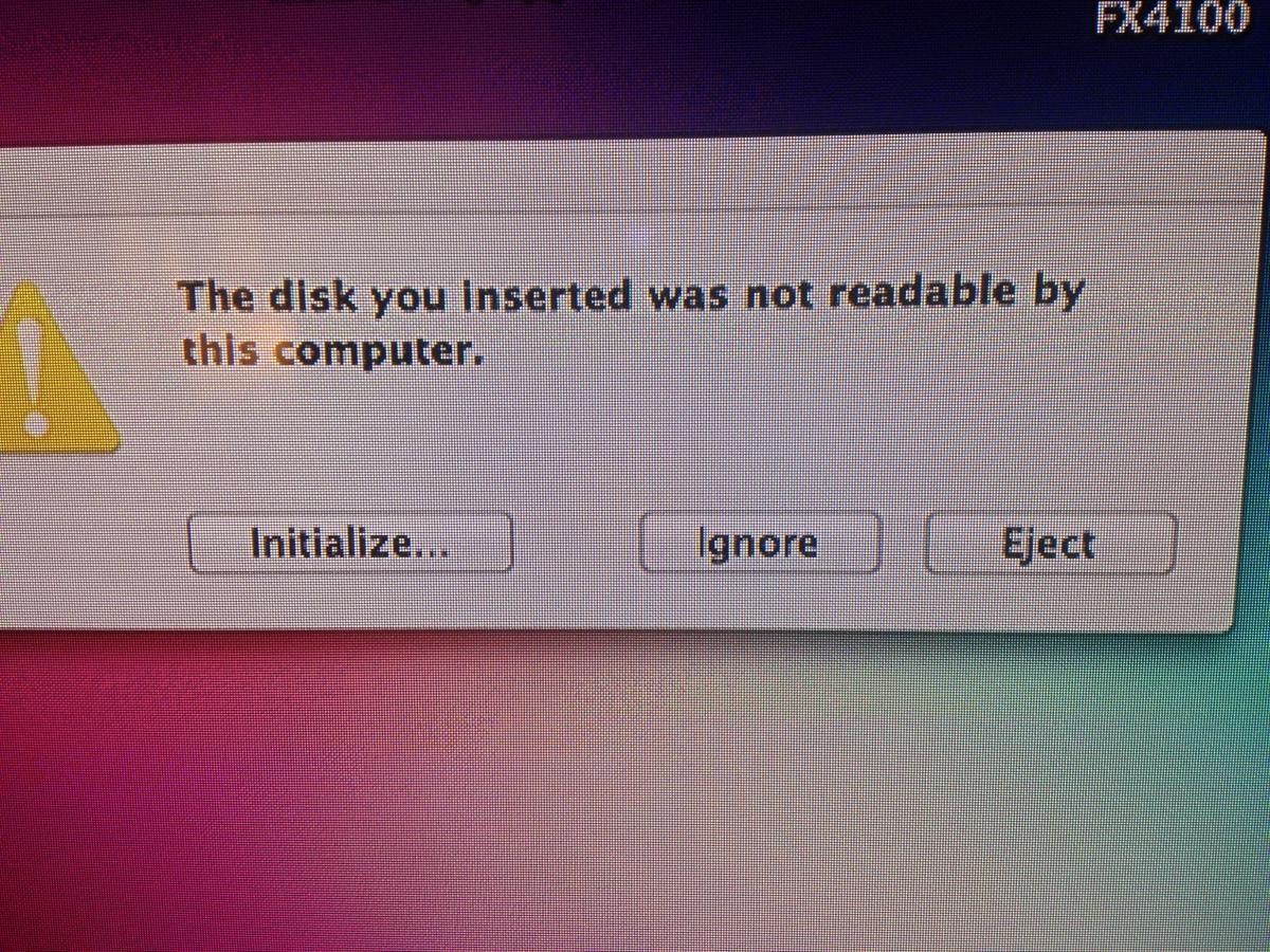

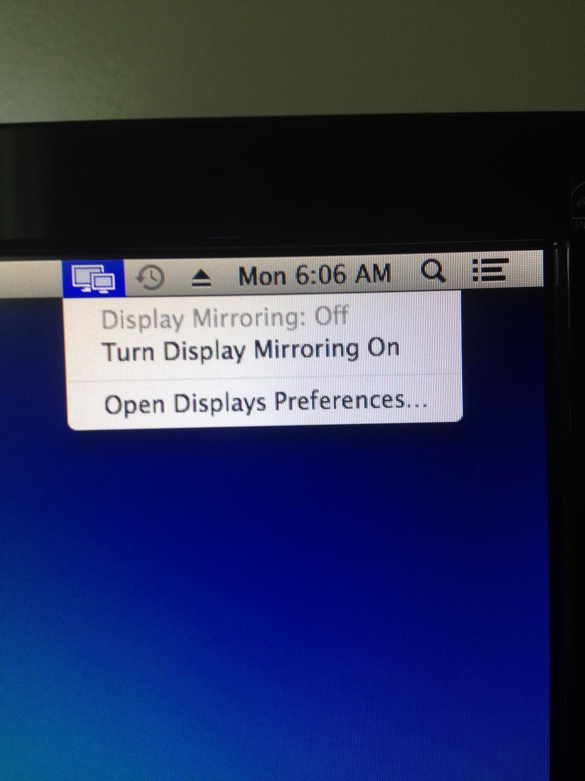

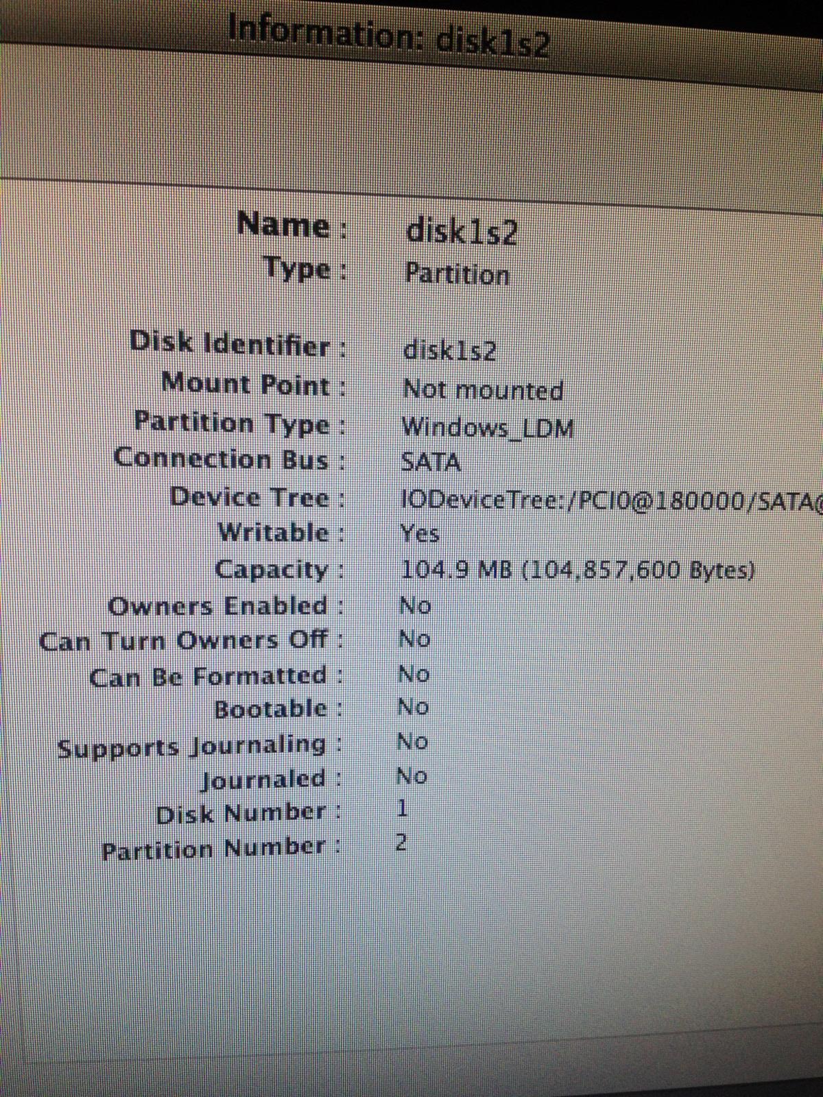

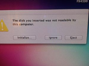

Thank you for all the information. I could install the Firepro, but when starting up the pc comes the screw up graphics. I can go on just with the -x, when the pc starts Its come with the Grey and only work if I turn on the tv to see what is going on. from there I can switch to the monitor. I dont know what to do to put the graphic card to work directly with the monitor, instead of the TV. I will post some pic maybe you can help me. Thank you for your support.
another problem is that I have windows in another HDD, but whe the OS starts bring a massage errror. that the disk you inserted was not readable by this computer. The disk have 3 partition or 4, it is 1 giga.

I'd guess that OSX chooses a wrong framebuffer.
You can assign a different FB with Chameleon and it's org.chameleon.boot.plist, but I don't the names for the framebuffers of that generation...

I may be wrong, but that looks a problem with personalities.
You can try other personalities with Chameleon Wizard.
Otherwise it may need patching. See here http://www.insanelym...radeon-hd45xxx/
