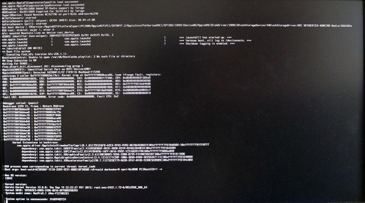

Alucardv8 Posted February 16, 2014 Share Posted February 16, 2014 Hello, I have installed mavericks but at the first boot I got this kernel panic. OSx MavericksAsus VL-k mobo intel core i7 3770k Gigabyte nvidia GTX 760 GPUG.skill ripjaws 8 GB ram. Please help.Regards, Link to comment Share on other sites More sharing options...
Gringo Vermelho Posted February 16, 2014 Share Posted February 16, 2014 Disable the on-die GPU in the BIOS and connect your display to the nvidia card. If you need to use both, you can work on that later. 2 Link to comment Share on other sites More sharing options...

Gringo Vermelho Posted February 17, 2014 Share Posted February 17, 2014 Your kernel panic indicates that drivers are loading for the on-die GPU. Therefore, I can only repeat what I've said: Make sure it's disabled. Don't use npci or PciRootUUID boot flags unless you are absolutely sure that they are necessary. Link to comment Share on other sites More sharing options...
Hackmodford Posted February 17, 2014 Share Posted February 17, 2014 I agree with Gringo. I have the same processor and had to disable the onboard HD4000 GPU via the BIOS, otherwise I get the same kernel panic. Link to comment Share on other sites More sharing options...
ashishpatelmac Posted February 17, 2014 Share Posted February 17, 2014 backup and delete Intel HD4000 kexts and Appleintelframebuffercapri.kext. i hope it boots normally. good luck Link to comment Share on other sites More sharing options...
