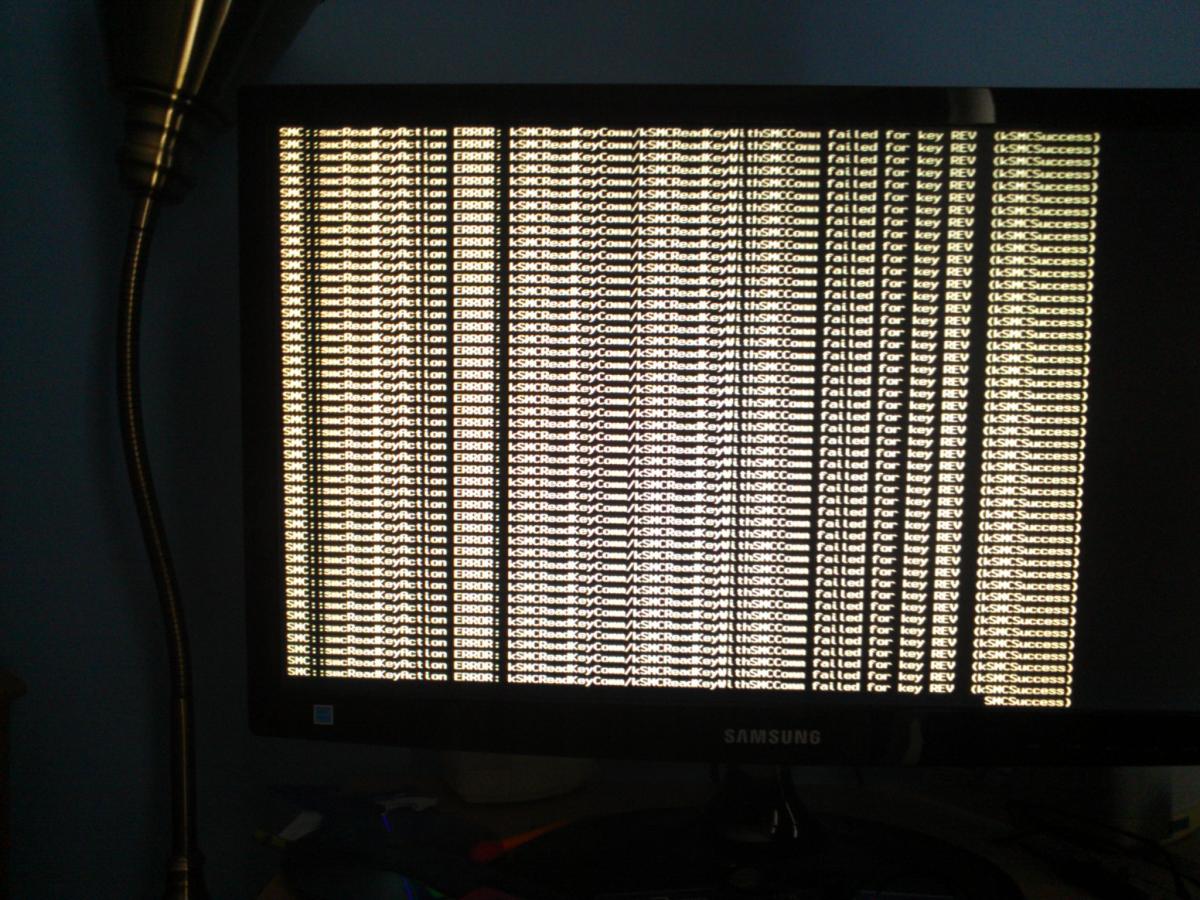

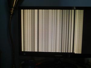

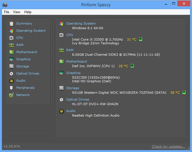

Goku123 Posted February 8, 2014 Share Posted February 8, 2014 I have a Dell Inspiron 660s (I know building a PC is better for Hackintosh) that I want to install OS X 10.9 Mavericks to. Made a USB with myHack and everything went fine as far as I know. I want to install on an MBR Partition so I made a Partition on my Drive of 100 GB called Macintosh. That seems to be fine as well. When I plug the USB in it boots the Apple Logo then it freezes. I did some research, and found that doing -x or -x GraphicsEnabler=No helps. But it didn't. I have attached my System Specs and my Verbose Mode. Quote Link to comment Share on other sites More sharing options...
Rampage Dev Posted February 8, 2014 Share Posted February 8, 2014 What is your GPU as that is what it is hung up on. Quote Link to comment Share on other sites More sharing options...
Goku123 Posted February 8, 2014 Author Share Posted February 8, 2014 My GPU is a Intel HD 2500 Quote Link to comment Share on other sites More sharing options...

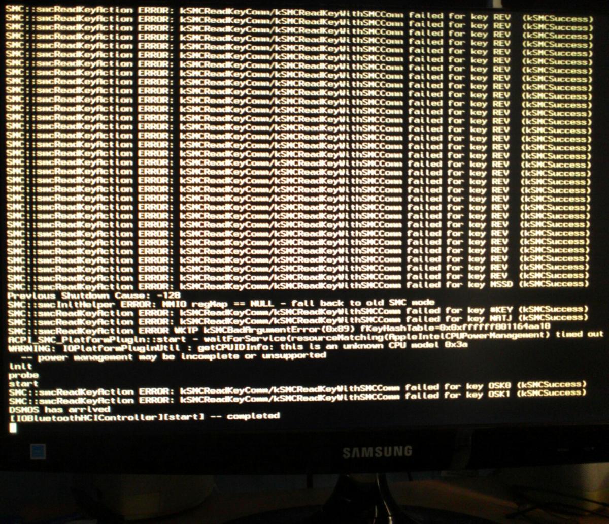

Goku123 Posted February 9, 2014 Author Share Posted February 9, 2014 I don't see any specific Intel Drivers. I do see AppleIntelGraphics.kext closest to it should I remove that. If so should I run myfix after that? Quote Link to comment Share on other sites More sharing options...
Goku123 Posted February 9, 2014 Author Share Posted February 9, 2014 Got this after removing the Apple Intel kexts Quote Link to comment Share on other sites More sharing options...
Pimentel Posted February 10, 2014 Share Posted February 10, 2014 Hello HD2500 doens't have support in OSX... You can enable it with this guide: http://www.insanelymac.com/forum/topic/287668-guide-intel-hd2500-full-resolution-and-qeci-1083/ But isn't vanilla support,you need edit the HD4000 kext for work as HD2500... And sometimes this work and sometimes not work... If this Dell is notebook, you can try enable your HD2500 using that guide... but it isn't 100% If this Dell is a Desktop, you can buy a dedicated graphic... GT610/620 work OOB in ML(since 10.8.3)and in MV Quote Link to comment Share on other sites More sharing options...
Rampage Dev Posted February 10, 2014 Share Posted February 10, 2014 Hello HD2500 doens't have support in OSX... You can enable it with this guide: http://www.insanelymac.com/forum/topic/287668-guide-intel-hd2500-full-resolution-and-qeci-1083/ But isn't vanilla support,you need edit the HD4000 kext for work as HD2500... And sometimes this work and sometimes not work... If this Dell is notebook, you can try enable your HD2500 using that guide... but it isn't 100% If this Dell is a Desktop, you can buy a dedicated graphic... GT610/620 work OOB in ML(since 10.8.3)and in MV Not true. The device ID is present in the Apple Drivers. And if I recall layout 6 is the default for HD2500. That said getting it to work out of safe mode has always been a challenge for myself. Quote Link to comment Share on other sites More sharing options...
