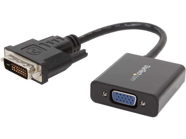

For some reason after installing 10.9.3 and updating the graphic drivers, I can only get signal when connecting my monitor thru the hdmi connection of my video card. Before the update, I was able to connect my monitor thru the dvi connection and get signal but not any more. What gives?
Hey, I assume you're using the NVIDIA Web Drivers because if that is the case, are using other kexts or DSDT edits to enable signal through DVI as well. I can only get signal through HDMI.
Ok, but the other DVI port's pin layout design is different from the one I am trying use. I am using a VGA to DVI adapter and its pin layout design is only compatible with one of the DVI ports on my video card. See picture below
Well maybe that's why. I don't know. Maybe analog out is broken or even deliberately ignored now.
