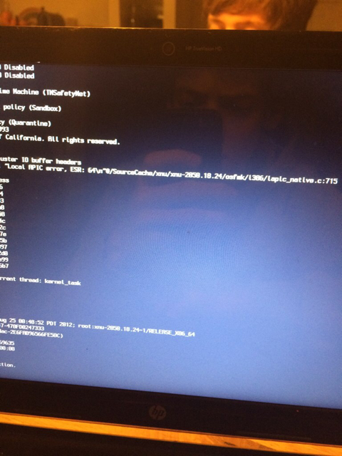

If you're using clover, enable the LAPIC and AICPUPM patches before booting.

cpus=1 make almost the same job of patch KernelLapic, but with flag cpus=1 you only boot with 1 core and KernelLapic patch enable you to boot with all cores.

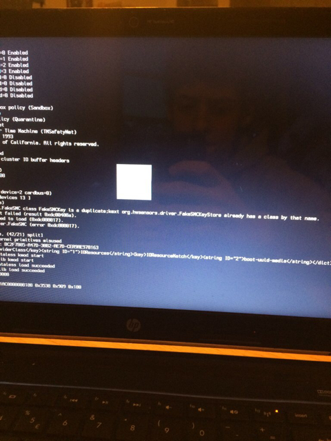

Got working usb but my trackpad doet het niet post-1296415-13914088952929_thumb.jpgpost-1296415-13914089141754_thumb.jpg

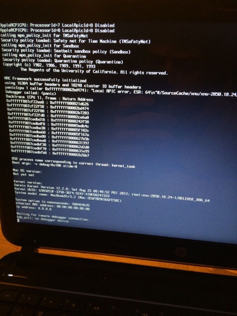

Get this without bootflags on clover anybody who can help with my mouse keyboard and this kernel panic
With: cpus=1 IGPEnabler=N -x -v -f UseKernelCache=N dart=0 GraphicsEnabler=N i got here post-1296415-13914094296869_thumb.jpgpost-1296415-13914094463613_thumb.jpg

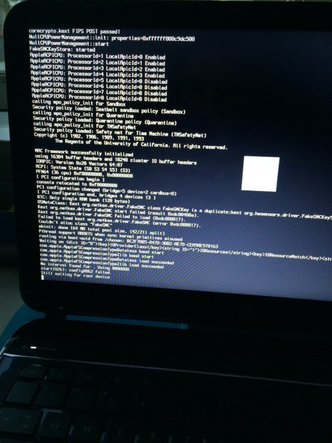

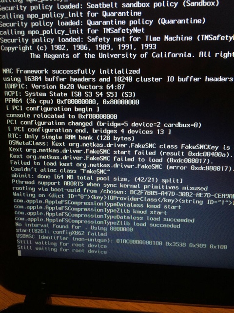

Then stuck waiting for root device

Try booting with just "cpus=1 GraphicsEnabler=Yes USBBusFix=Yes -v"
And make sure you spell those flags correctly.
Edit: And keep your drive plugged into the USB 2.0 (not the 3.0).

You need use GUID table(GPT) OSX only read this format.
Update your Bios for get option change Sata Mode for AHCI... if it doesn't work, maybe modify your Bios can enable it(but i don't advce modify your Bios, permanent problems will happen, use it if as a last resoucer)

Look, GPT(GUID) is standard parition, and OSX only boot with it. even to install Windows+OSX you need set for GPT(GUID)or nothing will boot.
Also, you need set for AHCI... or the problem: waiting for a root device will happen or other problems.
