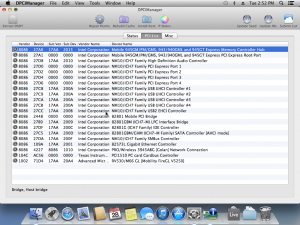

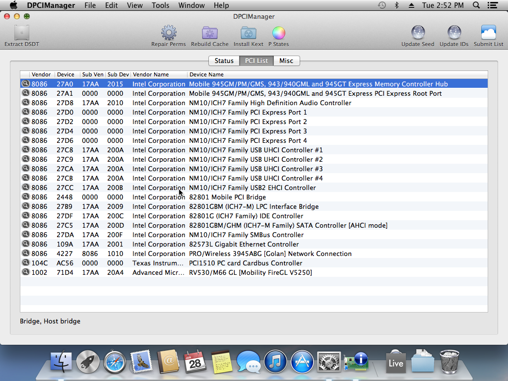

Dwors Posted January 31, 2014 Share Posted January 31, 2014 Hi all, I've had partial success with installing Mavericks onto my Lenovo Thinkpad T60p. However I've run into a few roadblocks for which I've been combing the web for solutions. I've found a few guides that could work but they are all 3-6 years old and any kext downloads are expired or gone. I'm posting out of desperation and semi-noobness in hopes that someone can help me and anyone else working with the same notebook. Here's a screenshot of my Device list from DPCI Manager. I know I need a new Wifi Card, I think I can manage to get the sound working, but the real trouble is that ATI Mobility FireGL V5250 Graphics. The computer is really laggy and the refresh rates are horrible. If I'm not mistaken I need to fully enable the Graphics. If anyone can lend a hand it would be AMAZING! Thanks in advance. Link to comment Share on other sites More sharing options...
dcai777 Posted January 31, 2014 Share Posted January 31, 2014 Get ATY_Init.kext 64-bit... 1 Link to comment Share on other sites More sharing options...
Laberlohe Posted February 1, 2014 Share Posted February 1, 2014 Hi Dwors, once I owned a T60p (14", 1440x1050, FireGL V5250) and had Lion beautifully roaring... You will need a modded bios in order to change WiFi card because Lenovo withelisted them. Try e.g. http://www.bios-mods.com/forum/Thread-ThinkPad-t60 The FireGL V5250 is basicly a Radeon X1700, so you can use kexts for this model (just add device/vendor id to kexts plist). To get display fully working (changing screen resolution, wake up, back light etc) I had the mess with EDID - maybe auomatic detection is better now. If there are ghosting windows then there is a problem with the syncing between the cpu cores - I fixed it with VoodooTSC.kext. Good luck! 1 Link to comment Share on other sites More sharing options...

sentabrina Posted March 23, 2014 Share Posted March 23, 2014 Dwors, Here are kexts I use for FireGL 5250. All is perfect. Try them, if it would not work for you, send me your ATIRadeonX1000.kext and I would try to hex it. I am sending you three kexts, be carefull not to install all of them at once! First of all isntall ATIinject.kext and ATINDRV.kext, reboot and install ATIRadeonX1000.kext All works perfectly on Leopard! Archive.zip Link to comment Share on other sites More sharing options...
downlord Posted April 30, 2014 Share Posted April 30, 2014 Hi, I'm running a T60p with 10.6.8 and ATI FireGL V5250, 64 Bit kernel, stock kexts (for video) It was a mess to get it up and running, and sometimes (5-10%) the video isn't detected (wrong EDID pickup) @Sentabrina: Lion and Mavericks are different beasts, the trick with the old Leopard drivers worked AFAIK till version 10.6.6 after that something changed (probably the OpenGL framework). ATINDRV comes from Leopard 10.5. Will someday have a try with ATY_Init.kext 64 Bit, will report... Link to comment Share on other sites More sharing options...
