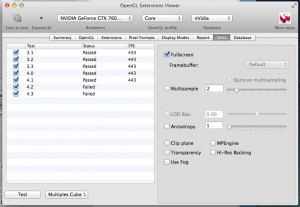

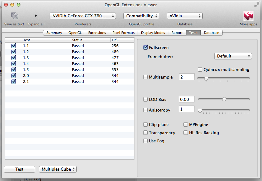

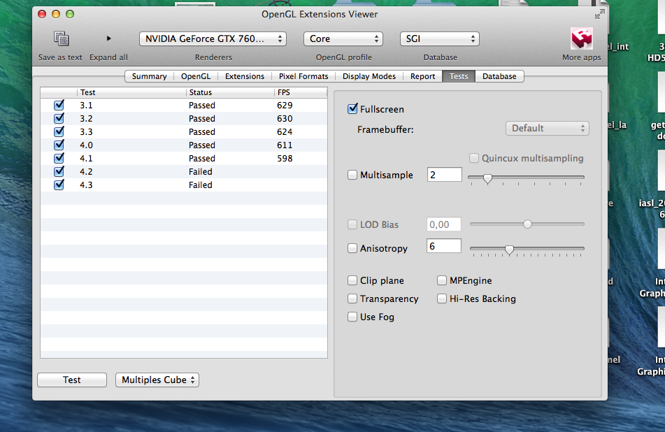

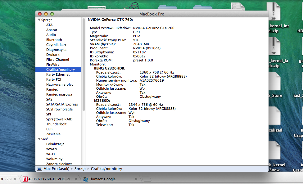

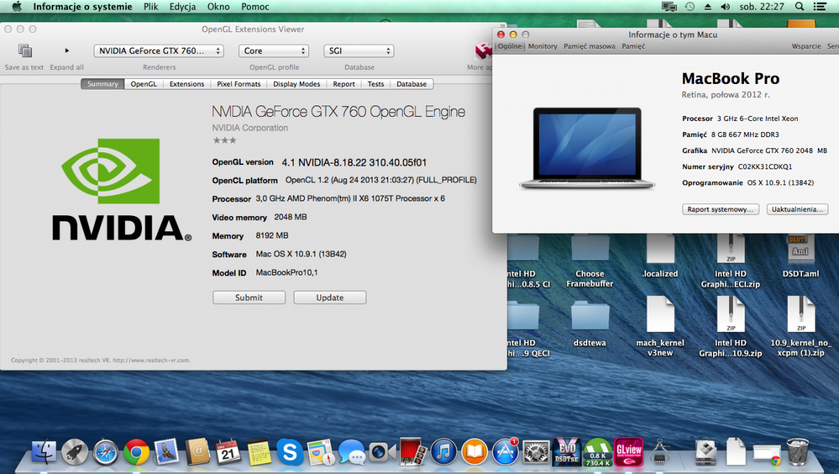

If someone have question about Mavericks 10.9.1 and GTX 760 i can tell is working on full and only GraphicsEnabler=No neded !exciting!!!post-1173135-0-35581800-1387661118.png if someone dont bellive me downsters is a png ile with a  proof ===========================================================>
Finaly triple boot (windows 8.1 Debian Linux + osx 10.9.1) on
Asrock 970 Extream 3
Phenome IIx6 1075t 3.0 Ghz - turbo off -issue for goed sound
Kingstone 8 Gb ram 1333
SSD Samsung 240
Asus GTX 760 2 GB ram (256)

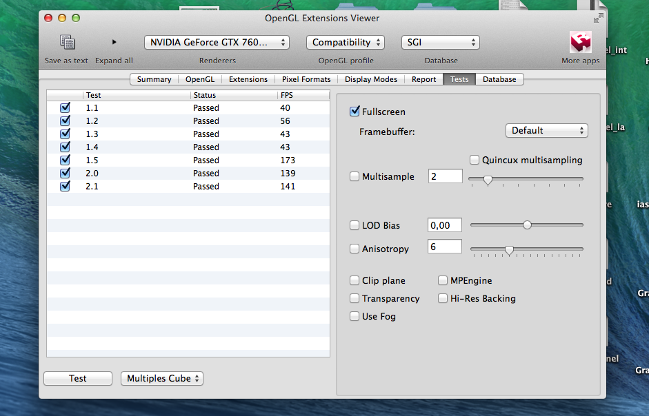

My score Procesor : ====> post-1173135-0-84856300-1387661903_thumb.png

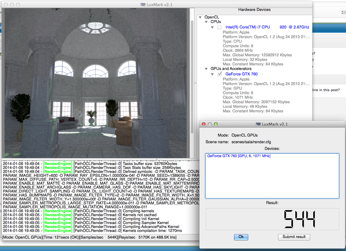

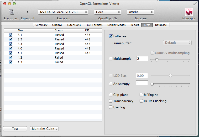

and Grafic Card :D =============>post-1173135-0-31279300-1387661959_thumb.png
Cheers !! :D :D :D :D

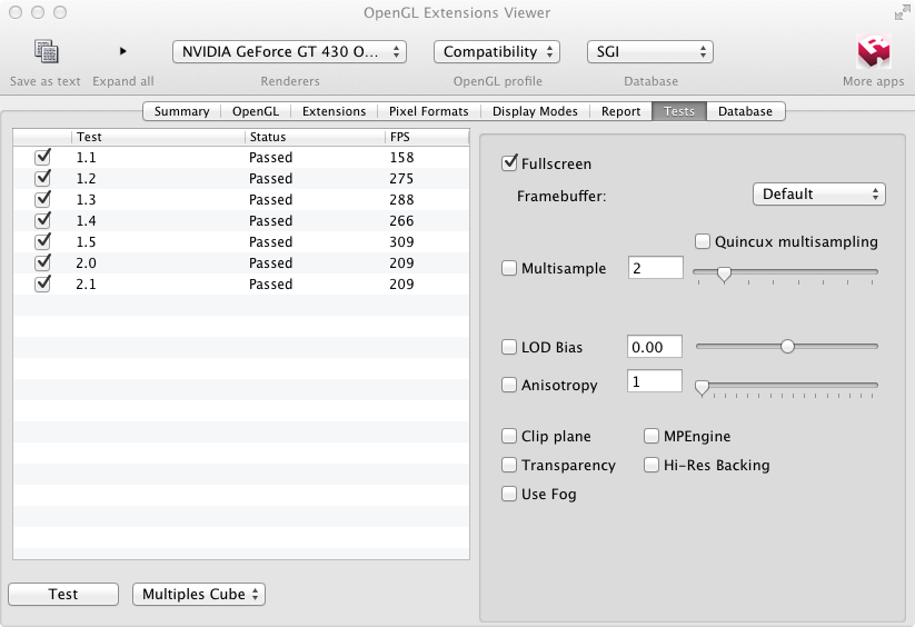

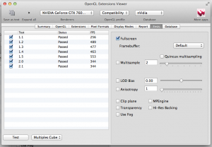

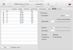

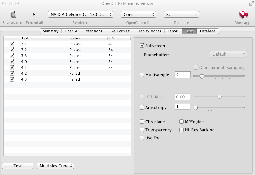

...forgive my forwardness, but here are my lowly scores in opengl extensions viewer  for a GT 430
...granted, you do beat me hands down in core scores
...and these "core" scores refer to your opengl core extensions not your processor...but i'm sure you knew that anyway... :smoke:

..not the same tests...try again with multiple cubes, just to show a clear comparison....the OP doesn't seem to have full acceleration :smoke:
and our tests are full screen

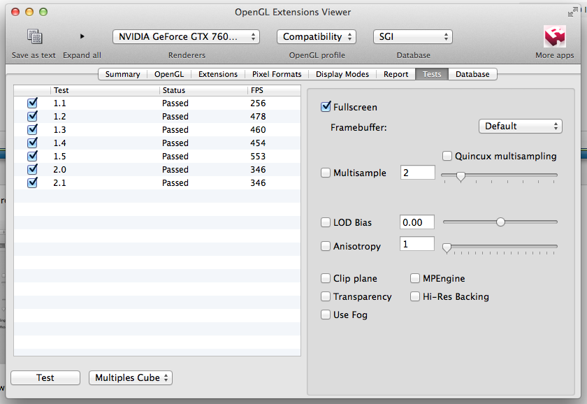

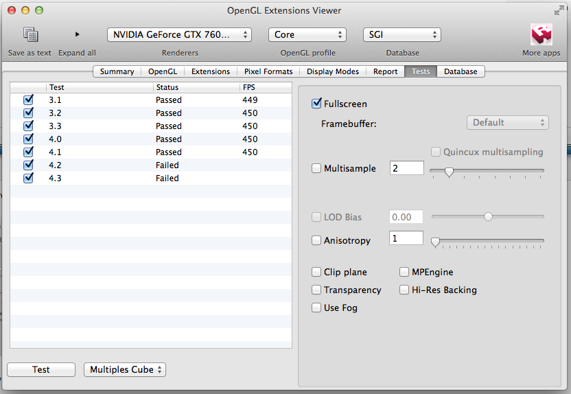

I just installed Asus DirectCU II OC GTX 760 2GB
While the OpenGL tests don't give the results as high as you guys, I am happy because HWMonitor reported much lower GPU Die temp.
After the test it hovers at 48c while with HD4870 it could hovers on 70c.
How to test if there is a full QE/CI? I tested the basic dashboard ripple test and chess game.

...hi, you may have to fine-tune your AGPM to get the most from your card(the hd4870 you mention seems to have had the same issue)...the gtx 760 may not be throttling up and down correctly...and the hd4870 seems like the high idle temps might be from not throttling down correctly...just my two cents worth :smoke:
RobertX,
You could be right, attached are the scores of tests.
I had edited AGPM kext duplicating one of the entries to match GTX760.
The machine is configured as MacPro5,1
Also installed CUDA Driver Version: 5.5.28 , GPU Driver Version: 8.18.22 310.40.05f01
Do you use GTX760? Could you share your AGPM setting?
