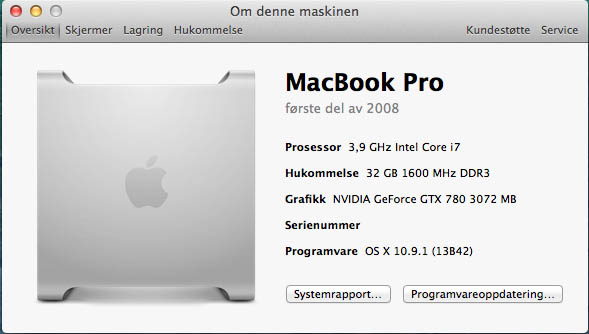

Hi. I finally built my first hackintosh, everything works perfect except preview, MS word, Quicktime and luxmark.
I have read a lot about the problems with the GK110 chip (rev. B?) and openCL. I thought the problem was reserved to the rev. B, while rev. A should work fine, have I missed something?
I have checked with cpu-z (windows) that it is true that I have a rev. A chip

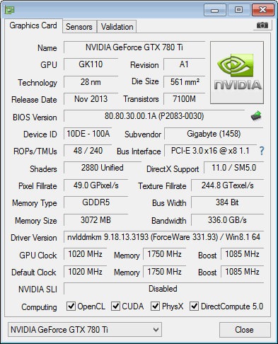

I also just built my first Hackintosh. I'm using a Gigabyte GeForce GTX 780 Ti WindForce 3X OC and have the same problems:

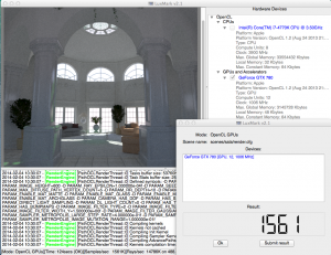

  • OpenCL apps crash on launch (I tried running LuxMark)
  • QuickLook can't display PNGs

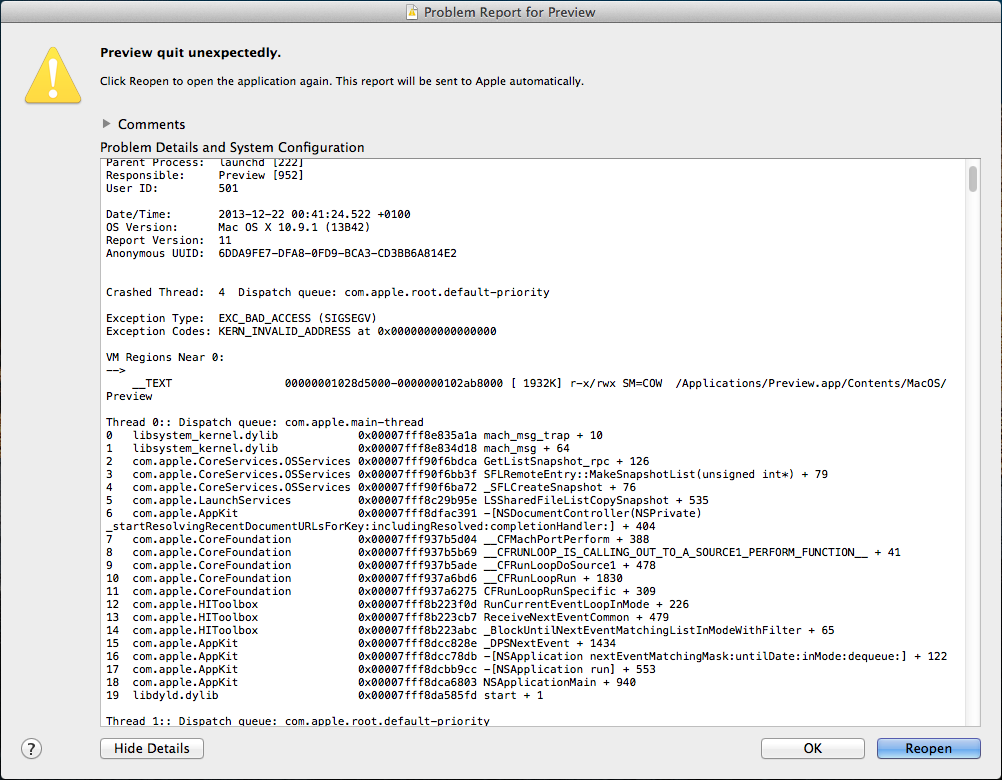

  • Preview.app crashes when opening a PNG
In addition to the above I seem to have trouble with OpenGL too: StarCraft 2 crashes after playing for a few minutes. Everything works fine in Windows 8 however, including running a FurMark stress test for 15 minutes.
BTW according to this netkas thread GPU-Z apparently reports revision A1 no matter what card your have. The tell is actually the BIOS Version it reports:
  • 80.10.* means Rev. A
  • 80.80.* means Rev. B

I did Luxmark
I obviously have bios version 80.80 ...  :( Thanks for helping out! I really hope nvidia release an update soon.

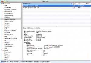

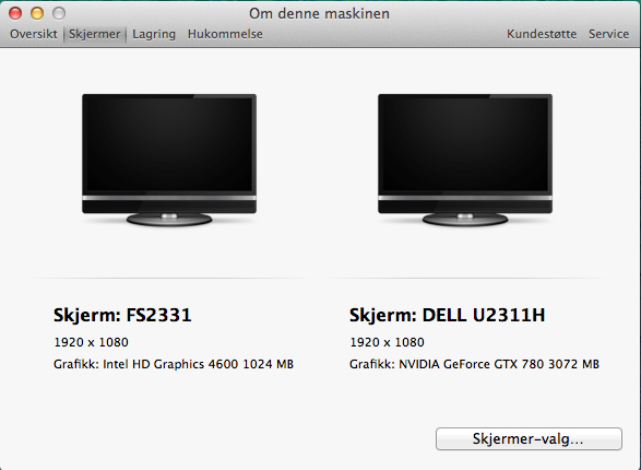

Unfortunately, I can not change the thread title. Wonder if it is possible to use the built-in graphics on the motherboard along with gtx780 in a dual screen setup?
Edited by Gringo Vermelho
Only staff can change thread title. Done.
FWIW I had to disable the CPU's built-in graphics, otherwise the Hack wouldn't boot with the 780 Ti - the boot process stopped after a message like missing bluetooth controller transport. From what I read the video driver is supposed to load after that IIRC.
I haven't tried using the built-in graphics together with the GTX 680 (yet), so not sure if the above is related to the 780 Ti in particular, GK110B in general or something else entirely.
@ boli:
I actually managed to use both graphics cards. The system works faster, and Preveiw works too :lol: The only negative so far is that Photoshop CC will not open, After Effects, Lightroom and Premiere works. (All of the Adobe apps worked when I used only GTX780)
Interesting, and good for you. :)
I tried enabling the Intel 4600 today, when the GTX 680 was in my Hack, rather than the 780 Ti. It didn't finish booting: stopped at grey Apple, likely the same as before (that's when the message I mentioned earlier was printed in verbose mode).
