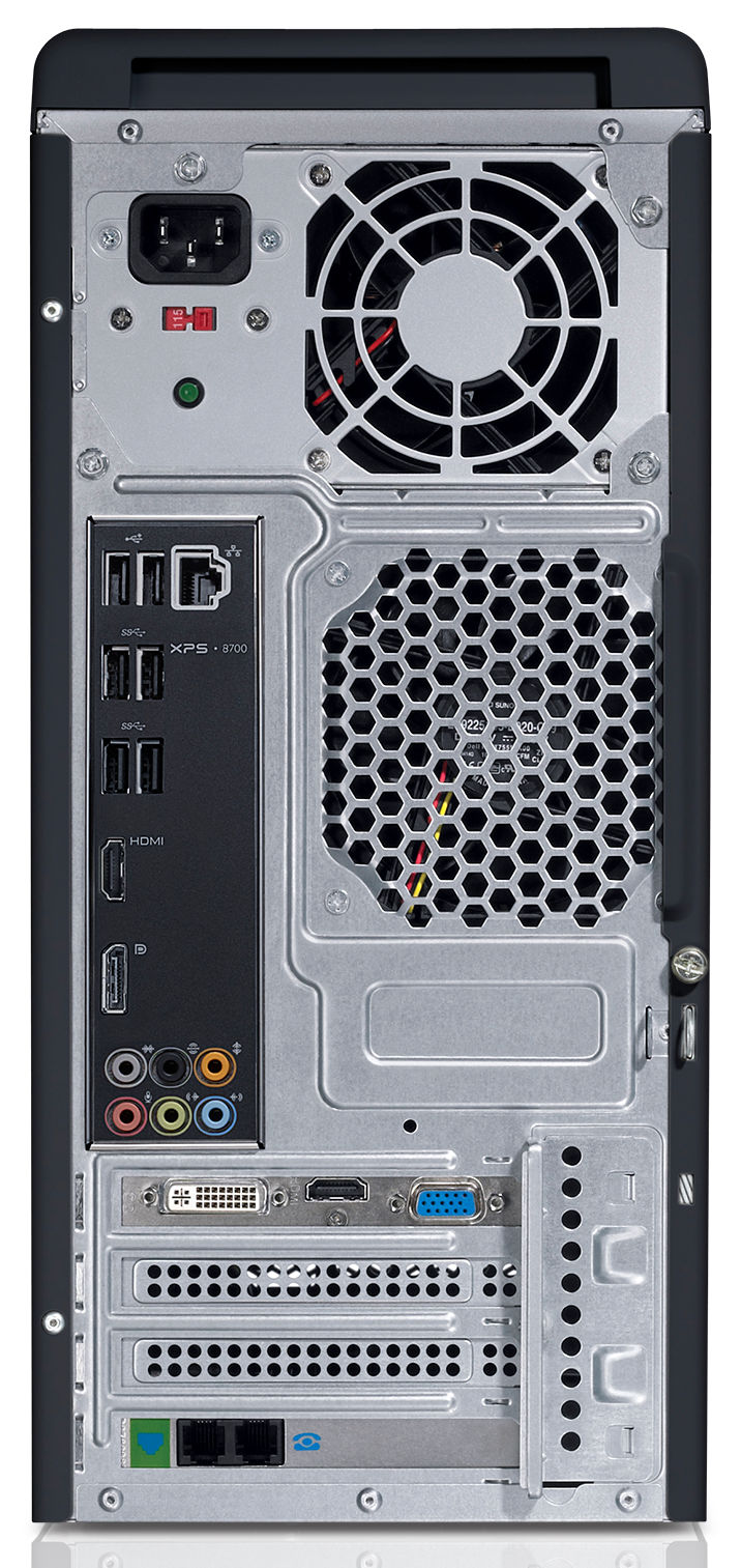

PlutoDelic Posted March 25, 2014 Share Posted March 25, 2014 Well, if we have the same machine than you do. Our board has a HDMI and DisplayPort, and i think using the display port u need a few extra bootflags. Those ports link to the internal gpu on the cpu. http://ark.intel.com/products/75122/Intel-Core-i7-4770-Processor-8M-Cache-up-to-3_90-GHz Processor Graphics ‡ Intel® HD Graphics 4600 Graphics Base Frequency 350 MHzGraphics Max Dynamic Frequency 1.2 GHz Heres the back of our machine, notice the video ports on the board interfaces. https://images-na.ssl-images-amazon.com/images/G/01/electronics/dell/cnet_dell_xps8700_gallery_04_lg.jpg PS, today during the chat, i was suggested to copy the patched kernel to the setup. What i did was only copy it to the root of the USB installer, and i thought the installer will copy to the drive what's already inside. I will do this test as soon as i get home, it seems like the last resort to me (unless Slave comes like a hero back) Link to comment Share on other sites More sharing options...

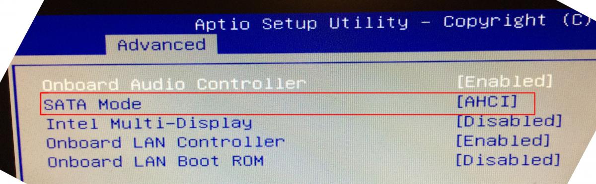

slave-zeo Posted June 8, 2014 Author Share Posted June 8, 2014 Stupid me. I had Intel Multidisplay enabled in the BIOS. I disabled it and then smooth sailing. For some strange reason when I tried to reinstall my system from an USB installer of 10.9.3 It won't boot properly. The USB drive was made form the 10.9.3 app store download. It installs fine using dart=0. It even boot into safe mode. But on normal reboot it hangs on the command right after the one where it throws a bluetooth error. I'm not sure what the offending command is since there's no output after the bluetooth error. I do not believe the bluetooth error is the problem, though. I'll post a pic of the error screen if I'm fast enough to catch it. You can get away from not patching the kernel by using the clover bootloader's KernelPM setting, setting it to true in the clover.config file. I've migrated from using chameleon to clover in the past couple of weeks. It has a lot of really nice features. Sadly my install does the same thing regardless of using a patched kernel/chameleon or clover. Has anyone else used the 10.9.3 download to install OS X on their 8700s. Just curious. Machine's specs are in my signature. I have managed to get installed OS X 10.9.3(first at 10.9.2) working on my Dell XPS 8700, Intel i7, 16gB ram, Nvidia GeForce GTX 660 with 1536 Video Ram. I used all the kext mentioned in this topic except: 1.) Audio doesn't work, my audio is a SB Recon3D PCI-e. Solution: Added VoodooHDA.kext (trashing AppleHDA on S/L/E) and leaving HDAEnabler1.kext too! 2.) Internal Wireless doesn't work, Intel Centrino Advanced-N 6235. Solution: Installed a USB Wi-Fi N 3. No restart/shutdown yet. Does anybody had a solution for item #3 (restart & shutdown fix)? Thanks for any help. Update: June 4, 2014 1) Restart/Shutdown miraCUOUSLY works but takes time to about 30s to restart and/or shutdown. As long it works, will investigate why in the next chapter. 2) Memory card reader also works. No Kext. it just works. :-) 3) Will try to install OS X Yosemite but I doubt it'll work. Watch in this channel/forum. I managed to install 10.10 DP1 on my 8700 but I'm getting the same boot error problem I get from 10.9.3. No boot, hangs after bluetooth error. Let me know if you figure anything out. Link to comment Share on other sites More sharing options...

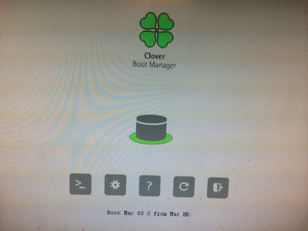

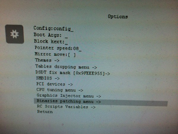

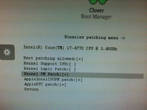

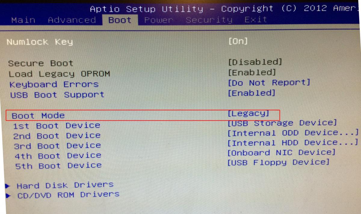

slave-zeo Posted June 21, 2014 Author Share Posted June 21, 2014 This is the start of the Dell 8700 Mavericks Guide. Please check here for further updates. First thing I did was take a look at the BIOS of the system. You can get to the system BIOS by pressing F2 at boot time. Make sure to Set the SATA to AHCI. You do this so OS X can read your hard drives. It should be set to AHCI already but make sure just in case. Next up make sure you set the Boot Mode to [Legacy]. This is so the bootloader can load. It's possible for Clover to work in UEFI, but I haven't been able to figure it out. So for now change it to [Legacy]. <The next part of the Guid will go here. Have patience, please.> What is your Clover setup like? I haven't used it but I'm interested in the unpatched kernel trick you spoke of. Honestly, I just installed Clover and it did its thing. I don't recall doing anything special. But if it automatically reboots when booting (normal unpatched haswell behavior) you can use the keyboard to go to settings on the Clover boot screen. Under Settings is Binary Patches and under it is a KernelPM option, make sure it's checked. But if I recall clover had it checked by default. Below are some photos to illustrate clover's boot time options for the kernel. Default unthemed boot screen, the gear is the Options button In the Options select 'Binaries patching menu' Finally, Make sure 'Kernel PM patch' is checked. This eliminates the need for a patched kernel. 1 Link to comment Share on other sites More sharing options...
