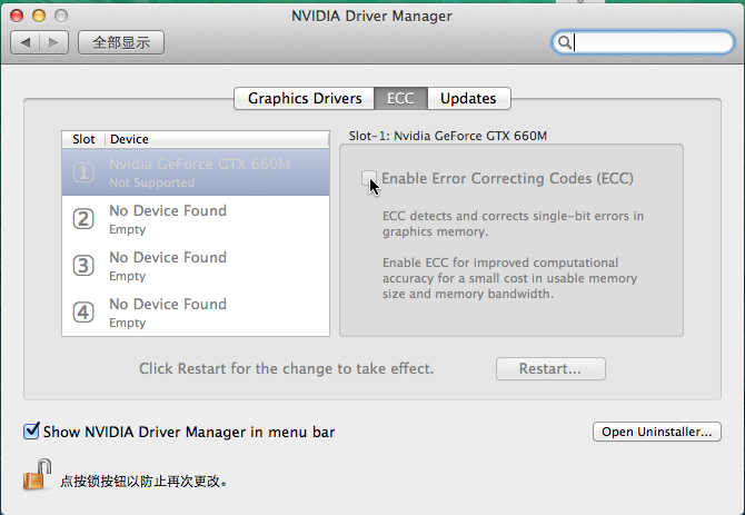

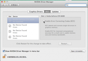

My G55VW-DH71's GTX660M is not supported by the webdriver. So I think my laptop problem is the driver, not the display port.
The driver says your card does´t support ECC memory, mine says that too but is working ( the only cards with ECC memory are the Quadro), I think your card has full support. Is your menu bar translucent? use OpenGL Extension viewer to test.

My laptop can't boot from internal display which has the LVDS port and is not 3D screen. When I remove the NVDAResman.kext or NVDAResmanWeb.kext, my laptop can go into the desktop without QE/CI.The printscreen above was got via VNC. Thank you, I will try the beta driver.

I use clover r2636 as the bootloader. When I set injectNvidia=Yes and put the vbios of my GTX660M in the "ROM" folder, Via VNC I find OS  X can recognize the GTX660M as "ASUS Gefore GTX660M" and the vram is 2048Mb. If I remove the vbios, OS X can't recognize the GTX660M and the vram is only 256Mb.
