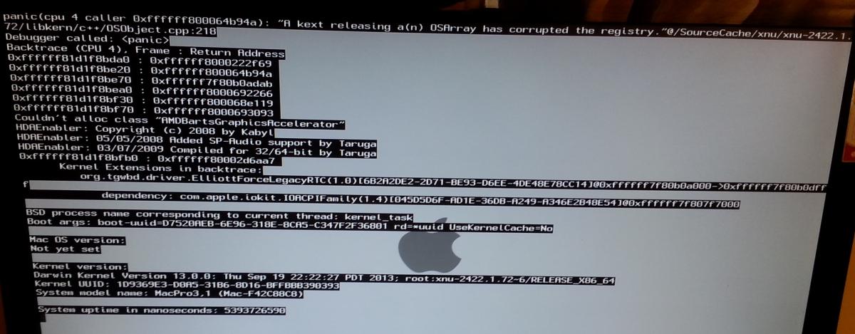

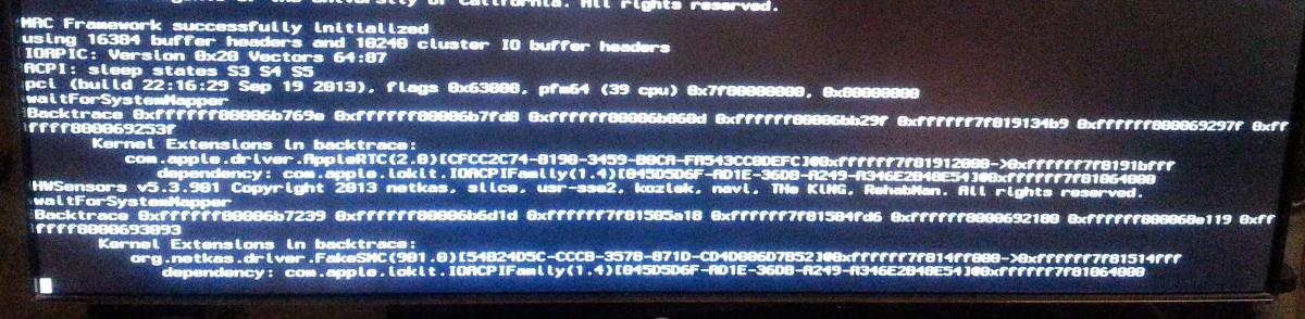

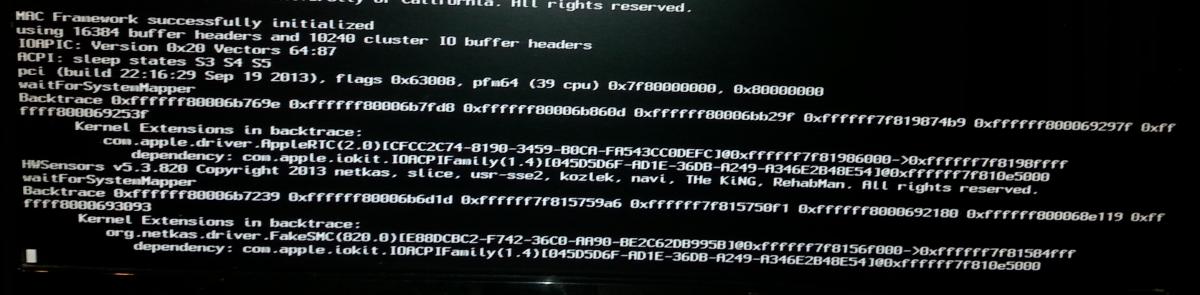

flashfreezer Posted October 24, 2013 Share Posted October 24, 2013 Hey, Yesterday I installed OSX 10.9. I installed it with the boot flag -x . Then I booted up and used [url="http://www.insanelymac.com/forum/topic/279450-why-insanelymac-does-not-support-tonymacx86/"]#####[/url] to install Chameleon and the other other stuff ([url="http://www.insanelymac.com/forum/topic/279450-why-insanelymac-does-not-support-tonymacx86/"]#####[/url] Option). Then I've got the following error message when I boot with -v : After that I installed the newest FakeSMC and then I got the same error with the newer version (5.3.901): I also read that I should boot with UseKernelCache=No then I've got a kernel panic: I hope you can help me Link to comment Share on other sites More sharing options...
StoneTemplePilots Posted October 24, 2013 Share Posted October 24, 2013 Hey, Yesterday I installed OSX 10.9. I installed it with the boot flag -x . Then I booted up and used ##### to install Chameleon and the other other stuff (##### Option). Then I've got the following error message when I boot with -v : IMG_20131023_192450.jpg After that I installed the newest FakeSMC and then I got the same error with the newer version (5.3.901): IMG_20131024_172055.jpg I also read that I should boot with UseKernelCache=No then I've got a kernel panic: IMG_20131024_171957.jpg I hope you can help me Do yourself a favour and try with CloverEFI, I uploaded a complete CloverEFI-ZIP package but you need to set serial and so on in config.plist ... Extract the ZIP to a FAT32 formatted USB stick and UEFI-boot from it. Reports if it worked are very welcome ! Link to comment Share on other sites More sharing options...
flashfreezer Posted October 24, 2013 Author Share Posted October 24, 2013 Do yourself a favour and try with CloverEFI, I uploaded a complete CloverEFI-ZIP package but you need to set serial and so on in config.plist ... Extract the ZIP to a FAT32 formatted USB stick and UEFI-boot from it. Reports if it worked are very welcome ! Thanks for your tip, but I fixed it myself. It was just a motherboard setting which wasn't correct. I disabled VT-d and now everything works fine :-) Link to comment Share on other sites More sharing options...
ameris_cyning Posted October 25, 2013 Share Posted October 25, 2013 Thanks for your tip, but I fixed it myself. It was just a motherboard setting which wasn't correct. I disabled VT-d and now everything works fine :-) You can reenable VT-d. All you need to do is add dart=0 to your org.chameleon.boot.plist Link to comment Share on other sites More sharing options...
