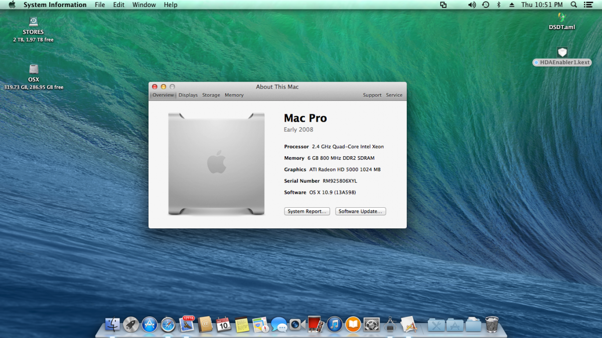

Gigabyte GA-EP45-UD3P - I LOVE this board.
6Gb DDR2 800
ATI 5770
Q6600
No overclocking, have audio it seems - the green line out, but no HDMI audio.. working on it.
320G system drive
2Tb backup drive
Stuck it in an Antec One Gaming case.
I love this thing.  Right now I'm Screen Sharing from my MacBook Pro while typing this.  I am working on getting my HDMI audio working so I can share my screen through CAT6 from the basement with another machine - I want sound and video, HDMI through CAT6 keystone jacks gives me audio and video - no worries.

No surprise, the Gigabyte EP45 series are as compatible as you can get. They were all the rage at the time and there's a ton of info available. Smooth sailing is practically guaranteed.
From the same generation, the ASUS P5Q series, also with ICH10/ICH10R and EP45 chipset, come in at a close second.
There is evidence that on later BIOS versions for the EP45 series, Gigabyte engineers purposefully made the DSDT more OS X friendly.

Two Issues that i have:
- sleep no longer works, just the display turns off, computer does not sleep
- i am unable to update my iLife products (MacAppstore claims that iPhoto has been bought with another appleID)
Do is still have to use GraphicsEnabler=yes in boot config?
EDIT2: Updating iLife Apps is ONLY possible by using Clover Bootloader. OMG, took me six hours to get Mavericks up and running like it should
EDIT: Sleep works again after doing a "sudo pmset hibernatemode 0"
Which method do you use? I have the same motherboard.
I used the 'myHack installer USB installer' application found on this forum with the 'install.esd' extracted from Mavericks application installer downloaded from the Mac App Store via Mountain Lion.
I copied my old dsdt, smbios and chameleon.org.plist, from previous Mountain Lion install into the Extra folder on the USB installer.
Rebooted and ran the usb installer, and did not remove any of the three kexts myHack recommended to remove.
After the install completed, I booted back into Mountain Lion.  I copied the dsdt, smbios etc from the installer usb into the Extra folder of Mavericks  and placed the fakesmc.kext into system/library/extensions folder of Mavericks, then used an application called 'kext wizard' to rebuild and fix permissions on this folder.
Restarted and booted into Mavericks, and everything working great.

Note: I have sound, since I use a Griffin iMic (USB) audio.  My mouse is USB wireless, but my Keyboard is a MS natural KB w/ PS2 a conector.  I use a PS2-USB converter that works fine on my Hack.  TIA, will provide any other information as needed.
I got my Hackintosh working.  But still have some questions that I will post to the myHack thread.
2nd try after trying method above and getting the error log posted above.  I tried copying the old dsdt, smbios and chameleon.org.plist
from my Lion install.  Same as Zbarsky did above (post #8),  still got screen w/ installer log.
_______
3rd try worked perfect.  I redid installer USB w/ 10.9 install and not 10.9.2 install.  Still used Pciroot=1 to get video.  Gave me install screen and everything worked fine.  Said no to three extensions that myHack suggested.  I don't have an i7, I have an NVIDIA card and whatever the last one was. :P
Posting this from my Hack running 10.9, shows up as an iMac, Summer 2001. Internet, video, upgraded from my Lion install and kept all my preferences & applications.  I use USB for audio since Snow Leopard, so have not tested built-in audio or the built-in Intel video.
EDIT: I used app store and clicked update for Mavericks 10.9.2.  I entered my Apple ID, gave me an error but then started to download the update anyway.  I went ahead and clicked it and rebooted (backed-up info before 10.9.0 install).  Update worked, I am now on 10.9.2.  But it will not to the same for updating iLife / i Work software.
