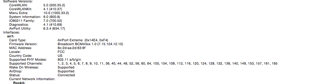

Here's what my real MPBr early 2013 says:
Screen%20Shot%202015-02-17%20at%2010.51.
and here's what my Hack says (it uses the same BCM4360 as you but device ID is 0x111):

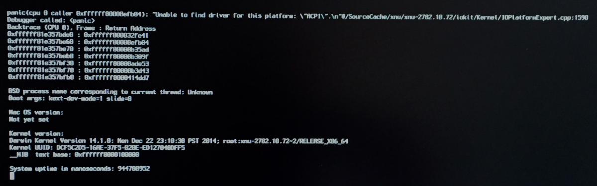

Hi ! I bough a
  • APPLE BROADCOM BCM94360CD - 802.11 A/B/G/N/AC + BLUETOOTH 4.0 WITH ADAPTER FOR PC/HACKINTOSH
  • i had only run wireless_bcm94352-100-v2.0.command, and i still have the panic !
  • I read the Airport - PCIe Half Mini Update v2.4, 2/12/2015 - 10.10.2 Update
  • But i don't understand what to do exactly ?
  • Could you help me please ?
