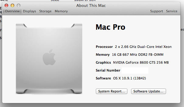

I have an older one but did not make it as a Hack but rather looked at Netkas did the firmware update from a MacPro1,1 to 2,1 later to find out it was an orphan road apple with 32 bit EFI. But a fellow named Tiamo got a boot EFI that would make calls from 64 bit to 32 bit (thunk).  I installed it in two places after making an initial install of Maverick (outside the box); then re-installed the drive in the first bay. Boot and chime.
Just wanted to add that I installed a Kingston SSD 240GB drive used CCC to clone now it boots at chime in 15 sec.
