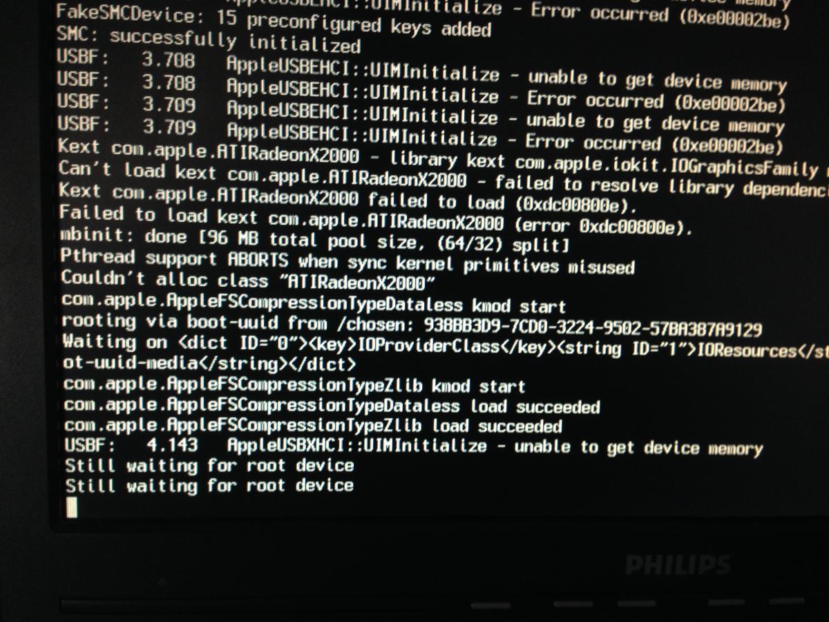

hello
10.8 and 10.9 not related...
the kext from one to another don't work...
have u the onboard graphics disable ?
good hack
yes i disabled onboard graphics , i saw alot people have this problem with ML 10.8.5 , special in haswell builds
no matter what i tried i cant pass PCI Configuration begin
-v -x
-v npci=0x2000
-v npci=0x3000
-v npci=0x3000 PCIRootUID=0/1
-v GE=Yes/No npci=0x3000/0x2000
always same stuck in PCI Configuration begin
ML 10.8.5
The AppleACPIPlatform.kext version 1.3.6 regression ought to do the trick.
AppleACPIPlatform.kext-v.1.3.6.zip
i tried  PCIRootUID=0/1
but same results stuck in PCI with stock kexts
